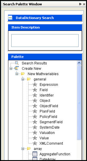

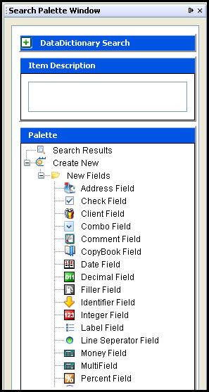

The Search Palette window is used to drag and drop fields and math variables onto the Configuration Area. You can search for fields and math variables that have been added to the Data Dictionary by using the Data Dictionary Search section or you can create new fields and math variables.
Results from a Data Dictionary Search will be viewable in the Palette section under Search Results. Use drag and drop functionality to move variables found in the Data Dictionary Search results into either the Fields or Math panes of the Configuration Area.
A search can only be performed through the Search Palette window if a transaction or rule is checked-out. The Fields pane in the Configuration Area also needs to be open.

Another way to create new fields and math variables is to use the Palette. All available fields are listed in the Palette when configuring the Field pane. When configuring math, the math variable types are divided into folders according to type. Expanded folders display the types available and can collapse to help in locating the appropriate folder. Once the appropriate math variable or field is selected, drag and drop it from the Create New folder into the Configuration Area.
Search Palette Window for Fields and Search Palette Window for Math
Search Palette window for fields Search Palette window for math
