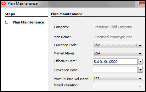

After a plan has been created the plan properties can be edited. The plan name and company name are the only fields that cannot be edited. The steps necessary to edit the plan properties are shown below.
From the Main Explorer window, right-click on the plan name and select Edit Plan. The Plan Maintenance window will appear.
Make the necessary changes to the plan properties by clicking on the drop down box next to each property.
Company: this field cannot be edited.
Yes can only be selected if no policies exist yet on the plan. If policies are already associated with the plan, then Transitioned or No must be selected.
Transitioned indicates a conversion from Traditional to Point in Time valuation.
If Point in Time Valuation is changed to Transitioned, the plan must be transitioned to Point in Time valuation. Contact Oracle support for help converting to Point in Time valuation.
Yes: Use mixed valuation methods. This setting indicates that both of the valuation methods will be used throughout the life of the policy. The transition date will determine how valuation should be written.
No: Use only Point in Time valuation. Any activity that is processed on the policy will write Point in Time valuation and no transition date will be required. This includes activities that are reprocessed, which previously calculated valuation using Period of Time.
A plan cannot switch back and forth between valuation types. Once a plan is identified with Point in Time (Transitioned or Yes) it cannot be changed back to Traditional valuation.
Window to Edit Plan Properties
