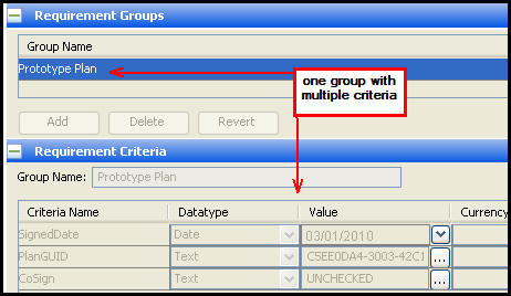

Criteria Pane
There are two sections on this pane: Requirement
Groups and Requirement Criteria. These sections
can be collapsed by clicking the
Collapse icon or expanded by clicking the
Expand icon.
Requirement Groups: provides a method of attaching multiple criteria together. Each group listed will have its own set of criteria defined in the Requirement Criteria section below. You will only see the criteria associated with the group you have selected. Clicking a different group will reveal the specific criteria assigned to that group. You can create a group without any associated criteria. Groups are saved to the AsRequirementGroup table.
Add: The Add button adds a new row. Double-click in the row to add the group information. Click Save on the Tool Bar to save the new group or just check-in the file.
Delete: The Delete button removes the selected group and all associated criteria. A confirmation window will appear to verify the delete. After the confirmation is verified, the Delete button changes to UnDelete. A group is deleted immediately if it was recently added and the file has not been checked-in. If the group existed previously, then the delete happens after the file is checked back in.
Revert: The Revert button reverts all changes made to the Group section.
Requirement Criteria: used as a reference for the system when it is determining whether or not to generate requirements for an activity. These are the fixed criteria the math variables are matched to in the GeneratePendingRequirements business rule in order to determine if the requirement is needed. You can associate multiple criteria with a Requirement Group. Criteria are saved to the AsRequirementCriteria table.
Add: The Add button adds a new row. Double-click in the row to add the criteria information. Click Save on the Tool Bar to save the new criteria or just check-in the file.
Delete: The Delete button removes the selected criteria. The Delete button changes to UnDelete when clicked. A criterion is deleted immediately if it was recently added and the file has not been checked-in. If the criterion existed previously, then the delete happens after the file is checked back in. When UnDelete is enabled, click it to remove the Delete check mark next to a row. This allows a delete to be reversed before the file is checked-in.
Revert: The Revert button reverts all changes made to the Criteria section.
Requirement Criteria should be configured to make the set of criteria within each Requirement Group mutually exclusive with respect to each other Requirement Group's set of Criteria. This would make it impossible for any given activity to satisfy more than one set of criteria. This is often done by using PlanGUID as one of the criteria in each group but it can be done using other methods as well.
Criteria Pane of a Requirement in Admin Explorer
