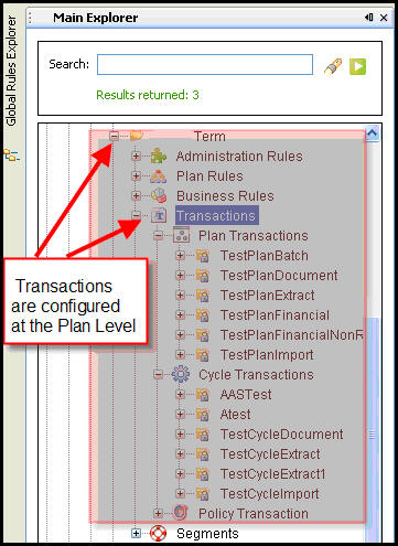

Transactions are always configured on the plan level meaning that each plan must have its own set of transactions. Transactions are broken down by the type of transaction: policy, cycle or plan. If multiple plans use the same transaction, a CopyBook can be created that contains the shared information. This will eliminate configuring the same transaction for each plan. It also means that the shared configuration is maintained in one place making updates to information easier.
Types of transactions listed in Main Explorer
Transactions Shown at Plan Level in Main Explorer
