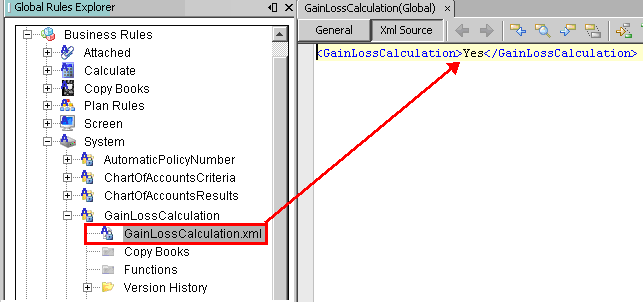

  1. Navigate to the Global Rules Explorer.
  2. Expand the Business Rules | System | GainLossCalculation folders.
  3. Check-out the GainLossCalculation.xml file or create a plan or transaction level override of the rule.
  4. Configure the business rule.
  5. Check-in the rule to save the changes to the database.
GainLossCalculation rule in the Global Rules Explorer
GainLossCalculation Rule in Global Rules Explorer
