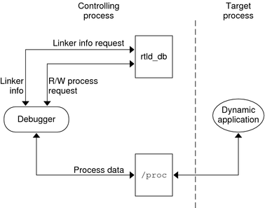

The flow of information between librtld_db.so.1, the controlling process (debugger) and the target process (dynamic executable) is diagrammed in the following figure.
Figure 11-1 rtld-debugger Information Flow
