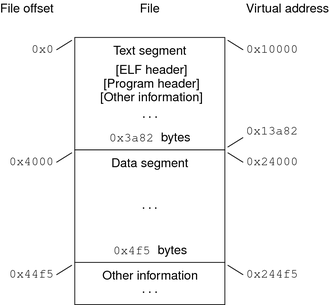

The following figure presents the SPARC version of the executable file.
Figure 13-1 SPARC: Executable File (64K alignment)
The following table defines the loadable segment elements for the previous figure.
Table 13-4 SPARC: ELF Program Header Segments (64K alignment)

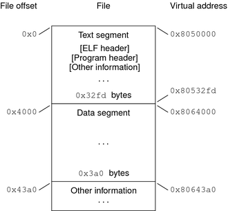

The following figure presents the x86 version of the executable file.
Figure 13-2 32-bit x86: Executable File (64K alignment)
Table 13-5 32-bit x86: ELF Program Header Segments (64K alignment)
The example's file offsets and virtual addresses are congruent modulo the maximum page size for both text and data. Up to four file pages hold impure text or data depending on page size and file system block size.
The first text page contains the ELF header, the program header table, and other information.
The last text page holds a copy of the beginning of data.
The first data page has a copy of the end of text.
The last data page can contain file information not relevant to the running process. Logically, the system enforces the memory permissions as if each segment were complete and separate The segments addresses are adjusted to ensure that each logical page in the address space has a single set of permissions. In the previous examples, the region of the file holding the end of text and the beginning of data is mapped twice: at one virtual address for text and at a different virtual address for data.
Note - The previous examples reflect typical Oracle Solaris OS binaries that have their text segments rounded.
The end of the data segment requires special handling for uninitialized data, which the system defines to begin with zero values. If a file's last data page includes information not in the logical memory page, the extraneous data must be set to zero, not the unknown contents of the executable file.

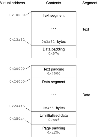

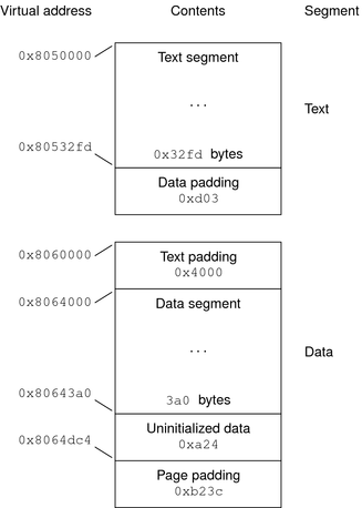

Impurities in the other three pages are not logically part of the process image. Whether the system expunges these impurities is unspecified. The memory image for this program is shown in the following figures, assuming 4 Kbyte (0x1000) pages. For simplicity, these figures illustrate only one page size.
Figure 13-3 32-bit SPARC: Process Image Segments
Figure 13-4 x86: Process Image Segments
