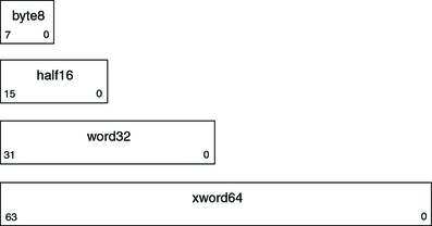

On the SPARC platform, relocation entries apply to bytes (byte8), half-words (half16), words (word32), and extended-words (xword64).

On x86, relocation entries apply to words (word32), and extended-words (xword64).
word32 specifies a 32–bit field occupying 4 bytes with an arbitrary byte alignment. These values use the same byte order as other word values in the x86 architecture.
