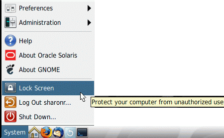

If you leave your workstation briefly, lock the screen.
Figure 3-1 Lock Screen Selection
The screen turns black. At this point, only you can log in again.
Note - The trusted stripe must not appear when the screen is locked. If the stripe does appear, notify the security administrator immediately.
If the Screensaver dialog box does not appear, press the Return key.
This action returns you to your session in its previous state.

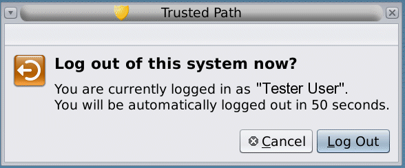

At most sites, the screen automatically locks after a specified period of idleness. If you expect to leave the workstation for awhile, or if you expect someone else to use your workstation, log out.

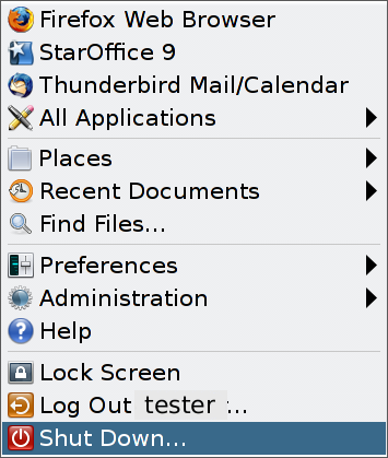

Logging out is the normal way to end a Trusted Extensions session. Use the following procedure if you need to turn off your workstation.
Note - If you are not on the console, you cannot shut down the system. For example, VNC clients cannot shut down the system.
Before You Begin
You must be assigned the Maintenance and Repair rights profile.
Confirm the shutdown.

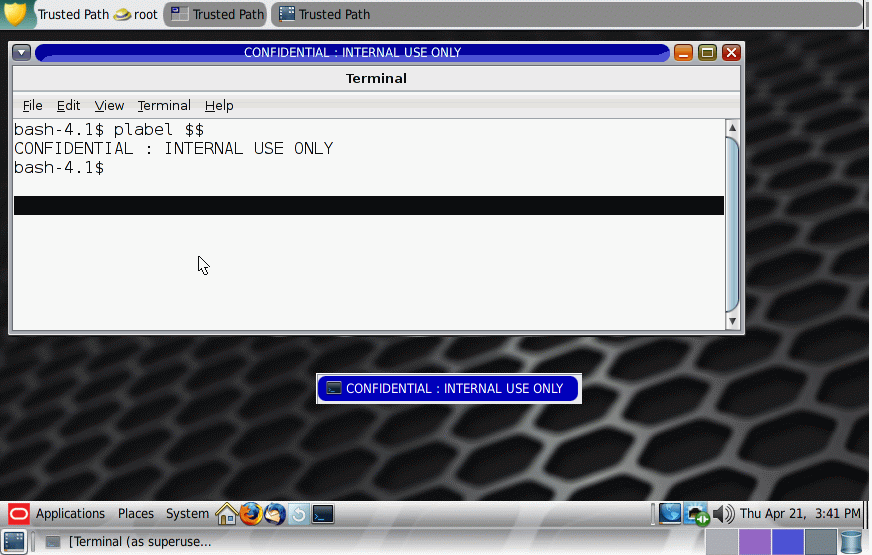

This operation can be useful to identify the label of a partially hidden window.
The label for the region under the pointer is displayed in a small rectangular box at the center of the screen.
Figure 3-2 Query Window Label Operation
