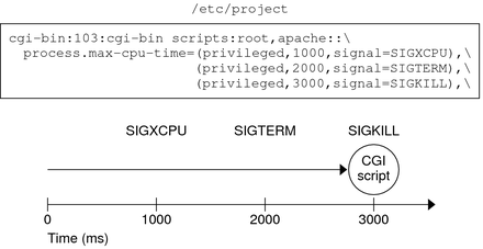

Figure 5-2 shows the timeline for setting privilege levels for signals that are defined by the /etc/project file process.max-cpu-time resource control.

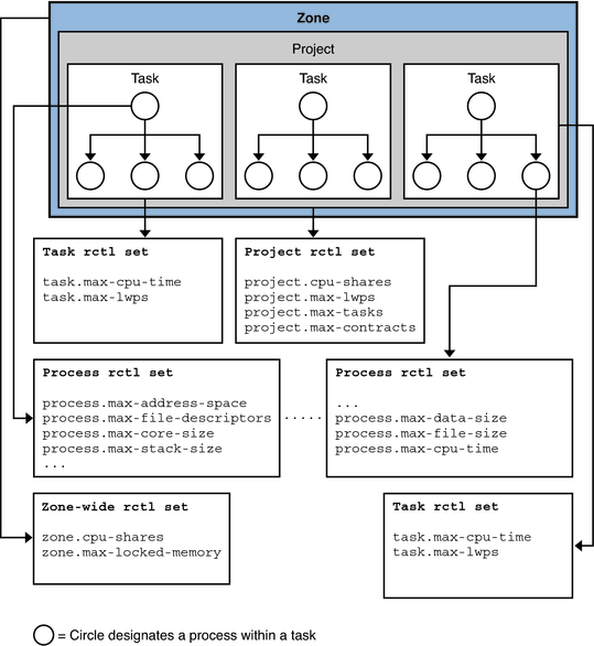

The following figure shows the resource control sets associated with zones, tasks, processes and a project.
Figure 5-1 Resource Control Sets for Zone, Task, Project, and Process
More than one resource control can exist on a resource, each resource control at a containment level in the process model. Resource controls can be active on the same resource for both a process and collective task or collective project. In this case, the action for the process takes precedence. For example, action is taken on process.max-cpu-time before task.max-cpu-time if both controls are encountered simultaneously.

For each threshold value that is placed on a resource control, the following restricted set of signals is available:
Terminate the process.
Signal generated by resource control facility when the resource control limit is exceeded.
When carrier drops on an open line, the process group that controls the terminal is sent a hangup signal, SIGHUP.
Job control signal. Stop the process. Stop signal not from terminal.
Terminate the process. Termination signal sent by software.
Terminate the process. Kill the program.
Terminate the process. File size limit exceeded. Available only to resource controls with the RCTL_GLOBAL_FILE_SIZE property.
Terminate the process. CPU time limit exceeded. Available only to resource controls with the RCTL_GLOBAL_CPUTIME property.
Other signals might be permitted due to global properties of a specific control.
Note - Calls to setrctl() with illegal signals fail.
