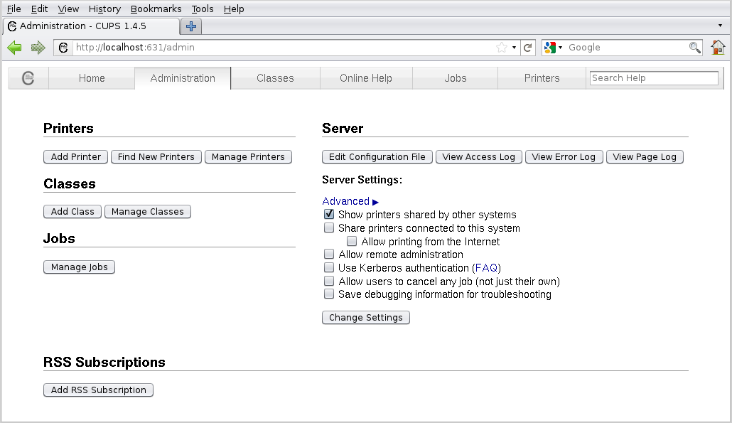

When you first access the CUPS web browser interface at http://localhost:631, you see the Home tab. From this tab, you can access all of the print administration tasks, which are grouped together by category, as well as the full set of CUPS documentation.
The following tabs are displayed on the web browser interface's main web page:
Administration – Enables you to access most print administration tasks, including CUPS server configuration.
You can directly access the Administration section of the web browser interface by going to http://localhost:631/admin.

Most printing tasks can be performed from the Administration tab. Note that some tasks can be performed from multiple tabs. Basic server settings can also be changed from the Administration tab. For more information about CUPS server configuration, see the cupsd.conf(5) man page.
The following figure shows the contents of the Administration tab of the CUPS web browser interface.
The following table describes the task categories and individual tasks that can be performed from the Administration tab.

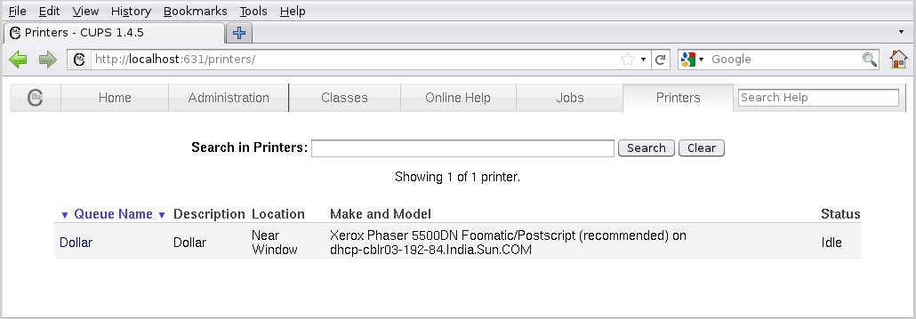

The Printers tab enables you to view and modify information for configured print queues, as illustrated in the following figure.
From the Printers tab, you can also perform the following tasks:
Print a test page
Stop the printer
Reject a print job
Move a print job
Cancel all print jobs
Unpublish the printer
Modify a printer
Set printer options
Delete a printer
Set the printer as the default
Set allowed users for a printer
