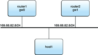

Example 25-1 VRRP Configuration Example
The following figure shows a typical VRRP configuration.
In this example, the IP address 169.68.82.8 is configured as the default gateway for host1. This IP address is the virtual IP address that is protected by the virtual router that consists of two VRRP routers: router1 and router2. At one time, only one of the two routers serves as the master router and assumes the responsibilities of the virtual router and forwards packets that come from host1.
Assume that the VRID of the virtual router is 12, the following shows the steps that are used to configure the preceding VRRP configuration on router1 and router2. router1 is the owner of the virtual IP address 169.68.82.8 and its priority is the default value (255). router2 is the backup whose priority is 100.
router1: # dladm create-vnic -m vrrp -V 12 -A inet -l gw0 vnic1 # vrrpadm create-router -V 12 -A inet -l gw0 vrrp1 # ipadm create-addr -T static -d -a 169.68.82.8/24 vnic1/router1 # ipadm create-addr -T static -d -a 169.68.82.100/24 gw0/router1 # vrrpadm show-router -x vrrp1 NAME STATE PRV_STAT STAT_LAST VNIC PRIMARY_IP VIRTUAL_IPS vrrp1 MAST BACK 1m17s vnic1 169.68.82.100 169.68.82.8 router2: # dladm create-vnic -m vrrp -V 12 -A inet -l gw1 vnic1 # vrrpadm create-router -V 12 -A inet -l gw1 -p 100 vrrp1 # ipadm create-addr -T static -d -a 169.68.82.8/24 vnic1/router2 # ipadm create-addr -T static -d -a 169.68.82.101/24 gw0/router2 # vrrpadm show-router -x vrrp1 NAME STATE PRV_STAT STAT_LAST VNIC PRIMARY_IP VIRTUAL_IPS vrrp1 BACK INIT 2m32s vnic1 169.68.82.101 169.68.82.8
Using the configuration of router1 as an example, you must configure at least one IP address over gw0. In the following example, this IP address of router1 is the primary IP address, which is used to send the VRRP advertisement packets:
