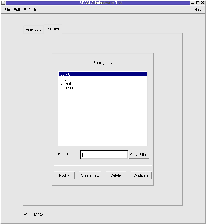

$ /usr/sbin/gkadmin
The list of policies is displayed.
Type a filter string in the Filter field, and press Return. If the filter succeeds, the list of policies that match the filter is displayed.
The filter string must consist of one or more characters. Because the filter mechanism is case sensitive, you need to use the appropriate uppercase and lowercase letters for the filter. For example, if you type the filter string ge, the filter mechanism displays only the policies with the ge string in them (for example, george or edge).
If you want to display the entire list of policies, click Clear Filter.
Example 23-9 Viewing the List of Kerberos Policies (Command Line)
In the following example, the list_policies command of kadmin is used to list all the policies that match *user*. Wildcards can be used with the list_policies command.
kadmin: list_policies *user* testuser enguser kadmin: quit

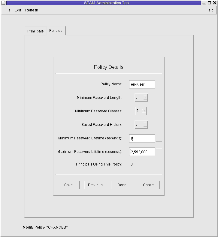

Example 23-10 Viewing a Kerberos Policy's Attributes
The following example shows the Policy Details panel when you are viewing the test policy.
Example 23-11 Viewing a Kerberos Policy's Attributes (Command Line)
In the following example, the get_policy command of kadmin is used to view the attributes of the enguser policy.
kadmin: get_policy enguser Policy: enguser Maximum password life: 2592000 Minimum password life: 0 Minimum password length: 8 Minimum number of password character classes: 2 Number of old keys kept: 3 Reference count: 0 kadmin: quit
The Reference count is the number of principals that use this policy.

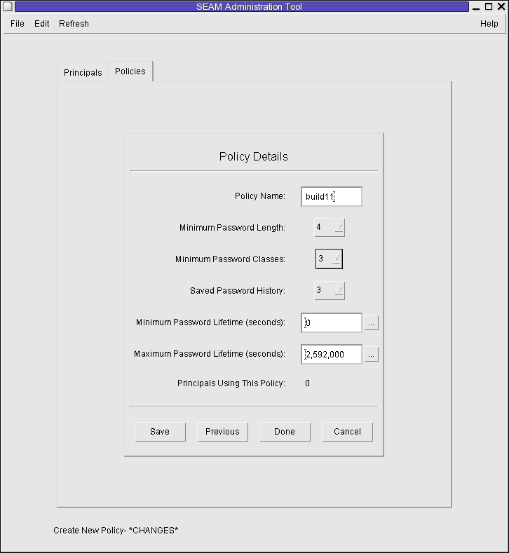

Example 23-12 Creating a New Kerberos Policy
In the following example, a new policy called build11 is created. The Minimum Password Classes is set to 3.
Example 23-13 Creating a New Kerberos Policy (Command Line)
In the following example, the add_policy command of kadmin is used to create the build11 policy. This policy requires at least 3 character classes in a password.
$ kadmin kadmin: add_policy -minclasses 3 build11 kadmin: quit
