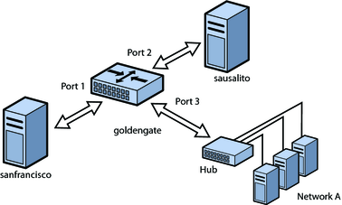

The following figure shows a simple bridged network configuration. The bridge, goldengate, is an Oracle Solaris system that has bridging configured. sanfrancisco and sausalito are systems that are physically connected to the bridge. Network A uses a hub that is physically connected to the bridge on one side and to computer systems on the other side. The bridge ports are links, such as bge0, bge1, and bge2.
Figure 11-1 Simple Bridged Network

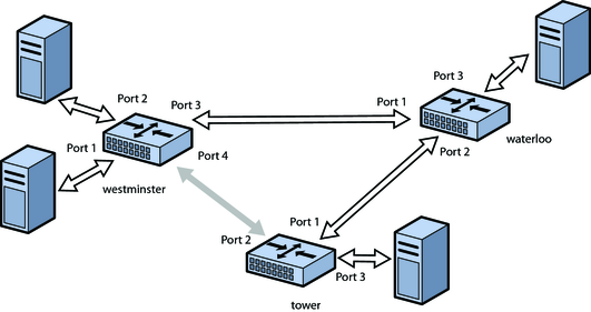

Bridge networks can be formed into rings that physically connect several bridges together. Such configurations are common in networks. This type of configuration could cause problems with old packets saturating the network links by endlessly looping around the ring. To protect against such looping conditions, Oracle Solaris bridges implement both the STP and TRILL protocols. Note that most hardware bridges also implement STP loop protection.
The following figure shows a bridged network that is configured in a ring. The configuration shows three bridges. Two systems are physically connected to westminster. One system is physically connected to waterloo. And one system is physically connected to tower. Each of the bridges are physically connected to each other through the bridge ports.
When STP or RSTP is used for loop protection, the physical loop is mitigated by preventing one of the connections in the loop from forwarding packets. The figure shows that the physical link between the westminster and tower bridges is not used to forward packets.
Note that by shutting down usable physical links to perform loop protection, STP and RSTP cost you bandwidth.
Unlike STP and RSTP, TRILL does not shut down physical links to prevent loops. Instead, TRILL computes the shortest-path information for each TRILL node in the network and uses that information to forward packets to individual destinations.
As a result, TRILL enables the system to leave all links in use at all times. Loops are not a problem as they are handled similarly to the way that IP handles loops. Namely, TRILL creates routes as needed and uses forwarding hop limits to avoid problems that are caused by momentary loop states.
Figure 11-2 Bridged Network Ring
