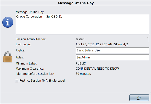

Always check that nothing is suspicious about the last login, such as an unusual time of day. If you have reason to believe that the time is not accurate, contact your security administrator.
The Message Of The Day field can contain warnings about scheduled maintenance or security problems. Always review the information in this field.
The MOTD dialog box indicates any roles that you can assume, your minimum label, and other security characteristics.
Click the Restrict Session to a Single Label button to log in to a single-level session.
