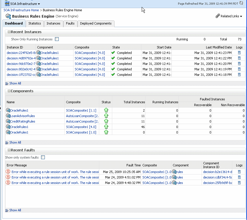

Using the business rules service engine home page Dashboard page, you can monitor recent instances and faults of decision service components running in the SOA Infrastructure. These decision service components can be part of separate SOA composite applications. Decision service components are also called business rules components in the Oracle Fusion Middleware documentation.
To monitor business rules service engine instances and faults:

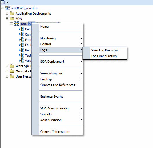

Access the business rules service engine home page through one of the following options:
| From the SOA Infrastructure Menu... | From the SOA Folder in the Navigator... |
Click Dashboard.

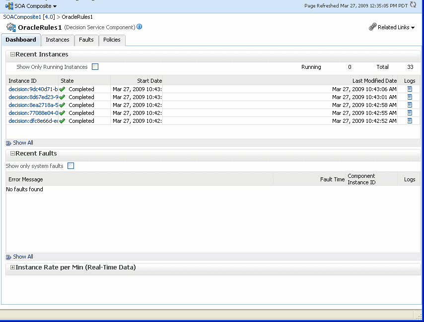

The Recent Instances section of the Dashboard page displays recent instances of all decision service components, including the instance ID of the decision service component, the decision service component name, the SOA composite application of which the decision service component is a part, the state of the instance (for example, completed successfully or faulted, the instance start time, the last modification time, and a Logs icon (clicking the Logs icon shows the Log Messages page with filtered messages specific to that instance)).
To see the state with the correct information, you must set the Capture Composite Instance State property. You can change this setting on the SOA Administration Common Properties page. Turning this feature on allows for separate tracking for running instances. However, this may impact performance. For information on setting this property, see Section 3.1, "Configuring SOA Infrastructure Properties."
In the Instance ID column, click an instance ID for a decision service component to view its audit trail.
The contents of the audit trail page depends on the Audit Level settings. When the Audit Level property is set to Production, the audit trail shows only the activity names. When the Audit Level is set to Development mode, the audit trail shows the decision service instance payload details. In other modes, for example Off, the audit trail does not show decision service details. You can change the Audit Level on the SOA Infrastructure Common Properties page. Additionally, this option can be set for a specific composite from the home page for the composite.
In the Component column, click a specific decision service component to access its home page.
In the Composite column, click a specific SOA composite application to access its home page.
In the Logs column, click a specific log to access the Log Messages page with filtered messages specific to that instance.
Click Show All to access the Instances page of the service engine.
The lower section of the Dashboard page displays the following:
The Components section shows the decision service components deployed on the business rules service engine across SOA composites. It also shows the status of the SOA composites and the instance count information in the respective instance state columns.
The Recent Faults section lists the recent faults in the service engine, including the error message, the time at which the fault occurred, the SOA composite application in which the fault occurred, the decision service component, the instance ID of the decision service component, and a Logs icon (clicking the Logs icon shows the Log Messages page with filtered messages specific to that instance).
For more information, see Section 1.2.4, "Introduction to Service Components and Service Component Instances."

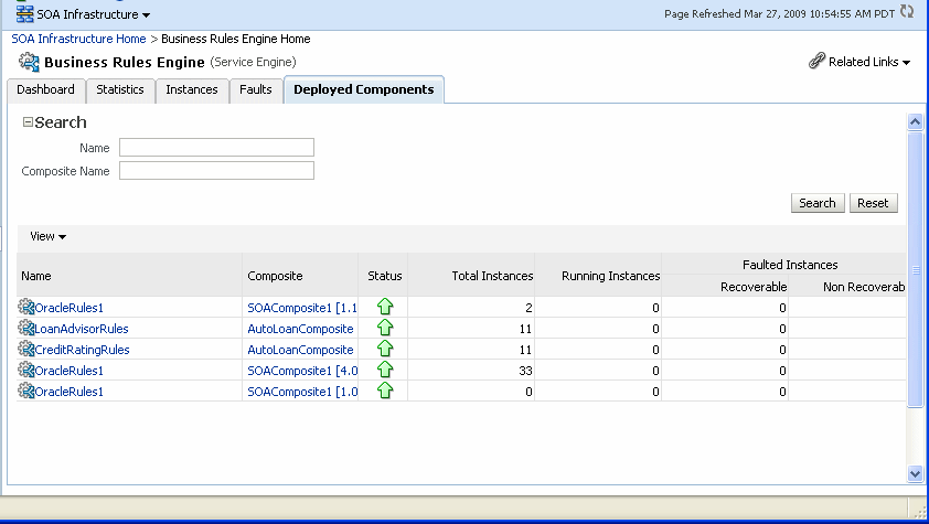

Using the business rules service engine home page Deployed Components page, you can monitor all decision service components deployed across SOA composite applications. Decision service components are also called business rules components in the Oracle Fusion Middleware documentation.
To monitor business rule service engine deployed components:
Access the business rules service engine Deployed Components page through one of the following options:
Select Service Engines > Business Rules. |
Click Deployed Components.
The Deployed Components page displays the following:
A utility for searching for a specific component by specifying criteria and clicking Search.
A list of components, including the name, the SOA composite application name, the status (up or down), and the instances count (total, running, and faulted).
In the Name column, click a name to navigate to the Component home page and view component details.

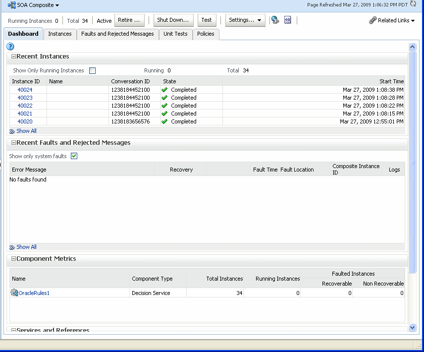

You can monitor decision service component instances of a composite application. Each decision service component instance has its own unique instance ID. This ID is in addition to the instance ID of the overall SOA composite application of which this decision service component is a part. Decision service components are also called business rules components in the Oracle Fusion Middleware documentation.
To see the state with the correct information, you must set the Capture Composite Instance State option. You can change this setting on the SOA Infrastructure Common Properties page. Turning this feature on allows for separate tracking for running instances. However, this may impact performance. For information on setting the option, see Section 3.1, "Configuring SOA Infrastructure Properties."
To monitor decision service component instances from a composite application:
Access a decision service component from a composite application through one of the following options:
The Component Metrics section on the composite dashboard provides a high-level overview of each decision service component. This table includes columns showing the Component Type, the Total Instances, the Running Instances, and the Faulted Instances (recoverable and nonrecoverable).
Select a decision service component in the Component Metrics section to display the corresponding decision service component page.

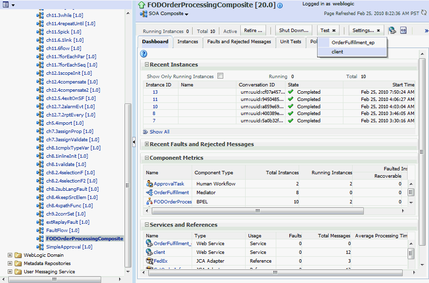

Open the composite application in Oracle Enterprise Manager Fusion Middleware Control.
A list of the recent composite instances is shown on the composite Dashboard page.
Click the Settings list, select Composite Audit Level, > Development to set the trace level as Development at the composite level.
Click Yes in the Confirmation dialog.

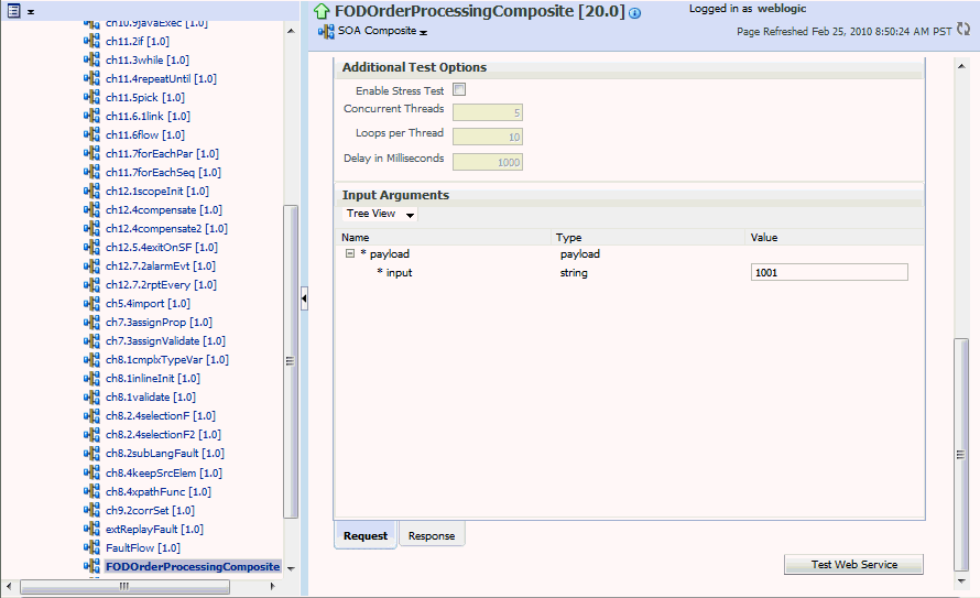

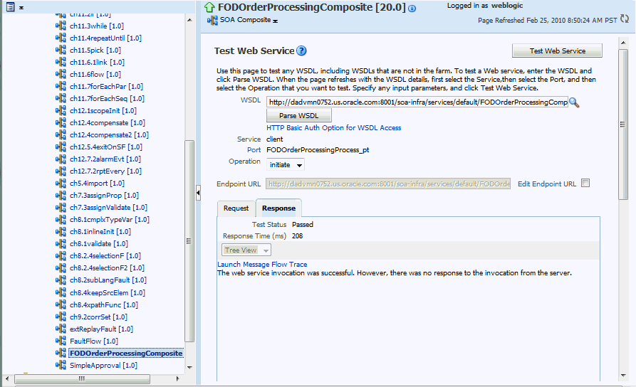

Click Test and then client to invoke a test instance of the composite to view the decision traces corresponding to different input parameters, such as the Order ID.
Enter an Order ID, for example 1001, in the Value field in the Input Arguments section on the Test Web Service page and click the Test Web Service button.
Based on the input Order ID, the service invokes a BPEL process instance containing the details of the Order ID, and the rule that is relevant to the order details is executed.

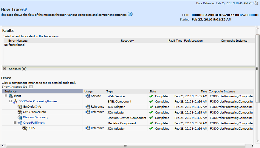

Click Launch Message Flow Trace under the Response tab to open the Flow Trace page.

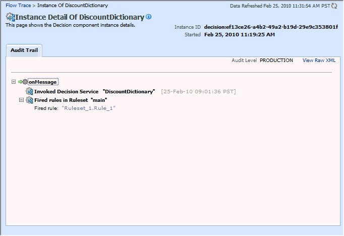

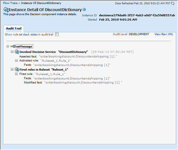

Click the decision service component instance called DiscountDictionary in the Trace section to view the actual rule execution trace.
You can also view the values of composite variables before and after invocation of business rule component. You must click the BPEL process component instance in the Flow Trace page, and then click the relevant payload. In this case, the BPEL component name is FODOrderProcessingProcess.
The following graphic shows the execution trace for the decision service component called DiscountDictionary.
Click the Show rule set stack states in audit trail checkbox to view further details of the rule execution.
The development-level trace report displays the fact name, activated rule, and the pushed and popped ruleset names.
The following table lists the entries of the trace report:
| Element | Description |
Invoked Decision Service Name |
Displays the name of the decision service component that is invoked. |
Asserted Fact |
Displays the name of the fact that is passed by the BPEL service to the decision service component. This is based on the input parameter provided by the user, which according to the example is the Order ID |
Activated Rule |
Displays the name of the rule that is activated, along with the name of the fact that activated the rule. |
Displays the name of the ruleset that has been invoked when the fact is asserted. |
Fired rules in Ruleset |
Displays the name of the ruleset whose rule is executed. |
Fired rule |
Displays the name of the rule that is executed. |
Modified fact |
Displays the name of the fact that has been modified because of the rule execution. This modified fact is then passed by the decision service component to the BPEL service. |
Displays the name of the ruleset for which execution is complete and so, the ruleset is taken out of the execution queue. |

Setting the audit level to Production provides a truncated report on the rule execution trace. It only displays the ruleset and the rules that have been fired and does not display details about facts, rule activation, and so on.
The process of production-level tracing is similar to the development-level tracing. However, for Production-level tracing, you must do the following:
In Fusion Middleware Control, after opening the composite, select Production from the Composite Audit Level of the Settings menu.
The following graphic shows the Flow Trace page that displays the trace report.
The Production-level trace report contains only the name of the ruleset and the rules that were fired. In addition, the Show rule set stack states in audit trail checkbox that provides a drill-down detailed trace report is unavailable in the Production-level trace report.

To view decision service component logs:
In the navigation tree, select and right-click soa-infra.
Select Logs > View Log Messages. This displays the Log Messages page.
The Log Messages page opens. Use this page to select target log files.
