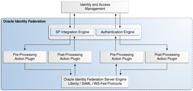

Figure 12-1 explains the custom actions plug-in architecture:
In this figure, Oracle Identity Federation is customized and configured to invoke plug-ins:
before the SP integration engine invokes Oracle Identity Federation
before Oracle Identity Federation invokes the SP integration engine
before Oracle Identity Federation invokes the authentication engine
before the authentication engine invokes Oracle Identity Federation
During a federated SSO operation where Oracle Identity Federation acts as the service provider, the flow is as follows:
An Identity and Access Management (IAM) module such as Oracle Access Manager invokes the SP integration engine to start a federated SSO operation. The SP integration engine invokes the pre-processing plug-in for the SP engine to perform custom actions.
The pre-processing plug-in for SP engine invokes Oracle Identity Federation to start the federated SSO flow.
Oracle Identity Federation redirects the user to an IdP where the user is authenticated and an assertion created.
The IdP redirects the user back to Oracle Identity Federation with an assertion that is validated and mapped to a user.
Oracle Identity Federation bundles the user and assertion data, and invokes the post-processing plug-in for the SP engine to perform some custom tasks.
The post-processing plug-in invokes the SP integration engine by providing the user and assertion data.
The SP engine creates a use session in the IAM domain, and redirects the user to the protected resource.
