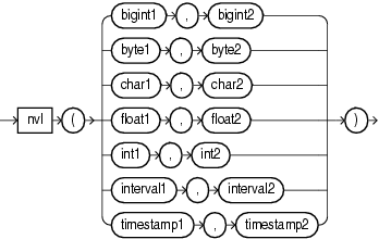

nvl lets you replace null (returned as a blank) with a string in the results of a query. If expr1 is null, then NVL returns expr2. If expr1 is not null, then NVL returns expr1.
The arguments expr1 and expr2 can have any datatype. If their datatypes are different, then Oracle CEP implicitly converts one to the other. If they cannot be converted implicitly, Oracle CEP returns an error. The implicit conversion is implemented as follows:
If expr1 is character data, then Oracle CEP converts expr2 to character data before comparing them and returns VARCHAR2 in the character set of expr1.
If expr1 is numeric, then Oracle CEP determines which argument has the highest numeric precedence, implicitly converts the other argument to that datatype, and returns that datatype.
Consider the query q281 in Example 8-16 and the data stream SNVL in Example 8-17. Stream SNVL has schema (c1 char(20), c2 integer). The query returns the relation in Example 8-18.
