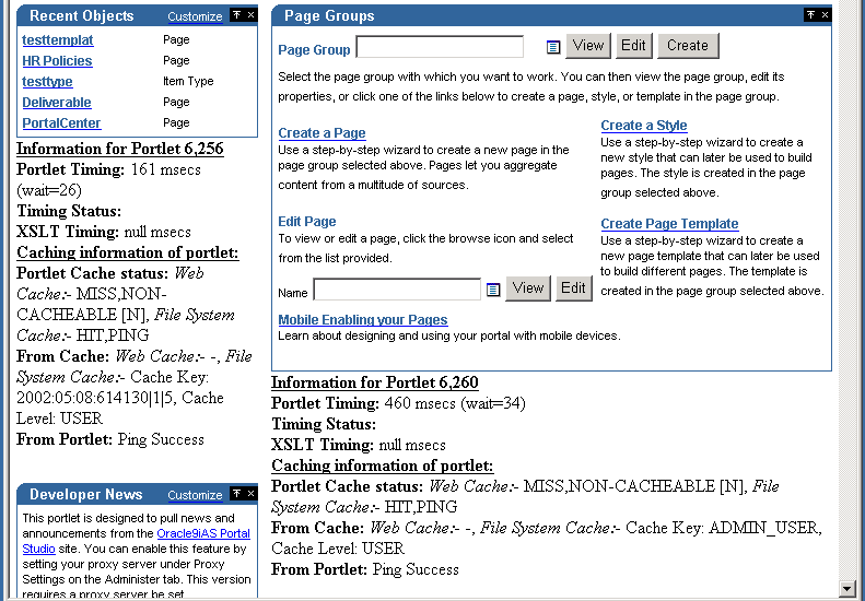

B.6 Timing and Caching Statistics
All Oracle Portal pages can be run in a special mode in which timing and caching information is displayed. If you want to see this debug information on every page you can set the Parallel Page Engine Parameter showPageDebug to true in the appConfig.xml file.
If you want to see the debug information for just a few select pages and portlets, you can control the logging level by the _debug URL parameter. For example, to see the timing statistics for the following Oracle Portal page:
http://abc.com/servlet/page?_pageid=21
You can manually insert ?_debug=3
To make:
http://abc.com/servlet/page?_pageid=21?_debug=3
Possible values for _debug are 0, 1, 2, 3, 4, and 5.
Values greater than 1 will potentially raise the logmode value for the duration of the request, and trigger all request log messages to be echoed into the page response.
All values greater than 0 cause _debug=1 to be propagated in back end requests.

The following statistics are available when the portal page is run in debug mode:
Figure B-1 shows a page that is running in the _debug=0 mode:
Figure B-1 Portal Page Running in Debug Mode
Description of Figure B-1 follows
Description of "Figure B-1 Portal Page Running in Debug Mode"
B.6.1 Portlet Statistics
In Figure B-1, you can see a number of Portlet related statistics listed under each portlet. Each Portlet has a unique internal reference identification number. This number is used in the "Information for Portlet" summary. For the portlet in the top left corner of Figure B-1, you can see that this number is 6256.
For each portlet the following statistics are listed:
B.6.1.1 Portlet Timing Information
  • Portlet Timing (msecs) (wait msecs)
    Indicates how many milliseconds it took to retrieve the portlet, and how long the request was queued, also in milliseconds.
  • Timing Status
    This is deprecated and no longer in use.
  • XSLT Timing (msecs)
    Displays the number of milliseconds that were needed to retrieve the XSL style sheet, in case the portlet is an XML portlet.
B.6.1.2 Portlet Caching Information
  • Portlet Cache status Web Cache (values) File System Cache (values)
    This is the Cache status from both Oracle Web Cache and the portal cache.
    Valid values for Oracle Web Cache are:
    • MISS, or NEW [M] indicating a cache miss in Oracle Web Cache and that the content that is generated by the portlet is new.
    • MISS, or STALE [G] indicating a cache miss, due to stale content in Oracle Web Cache.
    • HIT [H] indicating an Oracle Web Cache hit.
    Valid values for File System Cache are:
    • HIT_PING indicating a cache hit for a validation-based portlet.
    • HIT_EXPIRES indicating a cache hit for an expiry-based portlet.
    • MISS_STALE indicating a cache miss due to stale content in the Cache. This applies to both expiry, and validation-based portlets.
    • MISS_NEW indicating a cache miss and that the content that is generated by the portlet is new. This applies to both expiry, and validation-based portlets.
    If a portlet uses the File System Cache, then the information mentioned in the preceding text will be listed. Otherwise it will be null.
    If there is a hit on Oracle Web Cache, no details about File System Cache will be displayed because the content is served directly out of Oracle Web Cache. Additionally, if a portlet does not use Oracle Web Cache, then no Web Cache information will be printed.
  • From Cache: Web Cache Cache Expires (seconds), Age in Cache (secs), File System Cache (values).
    Information from both Oracle Web Cache and File System Cache will be printed here based on the type of caching that the portlet uses.
    "Cache Expires" lists the number of seconds after which the portlet content in Oracle Web Cache will expire.
    "Age in Cache" lists the number of seconds that the portlet content has been Cached in Oracle Web Cache.
    "File System Cache" displays the information obtained from the File System Cache about Cache Key, Cache Expiry and about the Cache Level in case of a cache hit, with the Cache Status of either HIT_PING, or HIT_EXPIRES.
    In case of a cache hit, the Cache Key and Cache Level (for Validation-based portlets) and Cache Expires and Cache Level (for expiry-based portlets) are displayed, with the Cache Status value of either HIT_PING or HIT_EXPIRES.
    For Validation-based and Expires-based portlets, "None" is printed when there is a cache miss due to the portlet content being new. (Cache Status: MISS_NEW) The portlet is contacted to get the new Cache Key, Cache Expiry and Cache Level.
    For Validation-based portlets, if the content in the Cache has become stale resulting in a cache miss, the current values in the cache for Cache Key and Cache Level are displayed. In this case, the portlet is contacted to get the updated Cache Key and the level (Cache Status: MISS_STALE).
    For Expires-based portlets, when the content in the cache has become stale resulting in a cache miss, a value of INVALID in the Expires field and Cache Level are displayed. In this case, the portlet is contacted to get the updated Cache Expiry and Cache Level (Cache Status: MISS_STALE).
  • From Portlet: (Cache Key) (Cache Level)
    This is the information obtained from the portlet about File System Cache Key, Cache Expiry, and Cache Level when there is a cache miss and when portlet is contacted for the updated, or new values (Cache Status: MISS_NEW, or MISS_STALE). Note that there is no Oracle Web Cache related information displayed in this section.
    For Validation-based portlets, when there is a cache hit and if the ping is successful, meaning the content in the Cache is still valid, then the portlet does not return a new Cache Key and Cache Level; instead it will indicate that the cache is still valid. In this case, "Ping Success" is displayed (Cache Status: HIT_PING).
    For Expires-based portlets, when there is a cache hit and if the content has not expired, then the portlet is not contacted for the content. In this case, "Not contacted" is displayed (Cache Status: HIT_EXPIRES).
    Following are a few examples that show different caching scenarios and the resulting output. Note that the other page and portlet related output is not shown here.
    In this release, page portlets are requested as portlets, separate from the container page definition. Therefore, portlet and page caching information is displayed for each page portlet in the debug output.
    Example B-1 Caching Information Debug Output 1
    Portlet Cache: File System Cache, Caching Type: Validation-based, Status: MISS, STALE.
    Caching information for portlet:
    Portlet Cache status: File System Cache:- MISS,STALE
    From Cache: File System Cache:- Cache Key: 42, Cache Level: USER
    From Portlet: Cache Key: 44, Cache Level: USER
    Example B-2 Caching Information Debug Output 2
    Portlet Cache: File System Cache, Caching Type: Expires-based, Status: MISS, NEW.
    Portlet Cache status:File System Cache:-  MISS,NEW
    From Cache: File System Cache:-None
    From Portlet: Cache Expires: 1, Cache Level: USER
    Example B-3 Caching Information Debug Output 3
    Portlet Cache: File System Cache, Web Cache, Caching Type: Validation and Invalidation-based, Status: MISS, NEW in File System Cache and Web Cache.
    Portlet Cache status: Web Cache:- MISS,NEW [M], File System Cache:- MISS,NEW
    From Cache: Web Cache:- Cache Expires: 86400 secs, Age in Cache: 0 secs , File System Cache:- None
    From Portlet: Cache Key: 9.0.2.2.1502:04:18:09:19:56, Cache Level: SYSTEM
    Example B-4 Caching Information Debug Output 4
    Portlet Cache: Web Cache, Caching Type: Invalidation-based, Status: HIT in Web Cache.
    Portlet Cache status: Web Cache:- HIT [H]
    From Cache: Web Cache:- Cache Expires: 86400 secs, Age in Cache: 58 secs
    From Portlet: -
