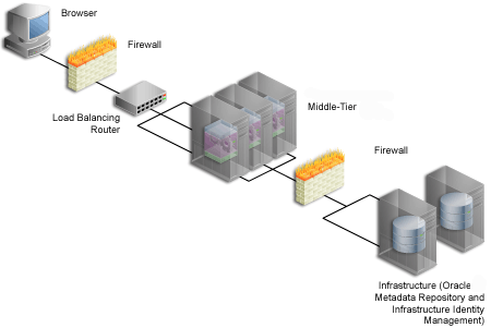

For very large sites, you can add load balancing hardware or software to distribute incoming requests to the middle-tier servers. Figure 2-5 shows a Load Balancing Router (LBR), a very fast network device that distributes network requests across a large number of servers, being used for this purpose. This is the most common approach to load balancing, and provides users of your portal with a single published address instead of them having to send each request to a particular middle-tier server.
Figure 2-5 Multiple Server Configuration Using a Load Balancing Router
See Section 6.3, "Configuring Multiple Middle Tiers with a Load–Balancing Router" for more information on adding an LBR to distribute incoming requests to middle-tier servers.
