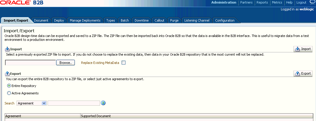

Use the tabs of the Administration page, shown in Figure 2-3, to manage importing and exporting, document protocols, deployments, types, batching, callouts, purging, listening channels, and B2B configuration.
See Part III, "Oracle B2B Administration" for more information.

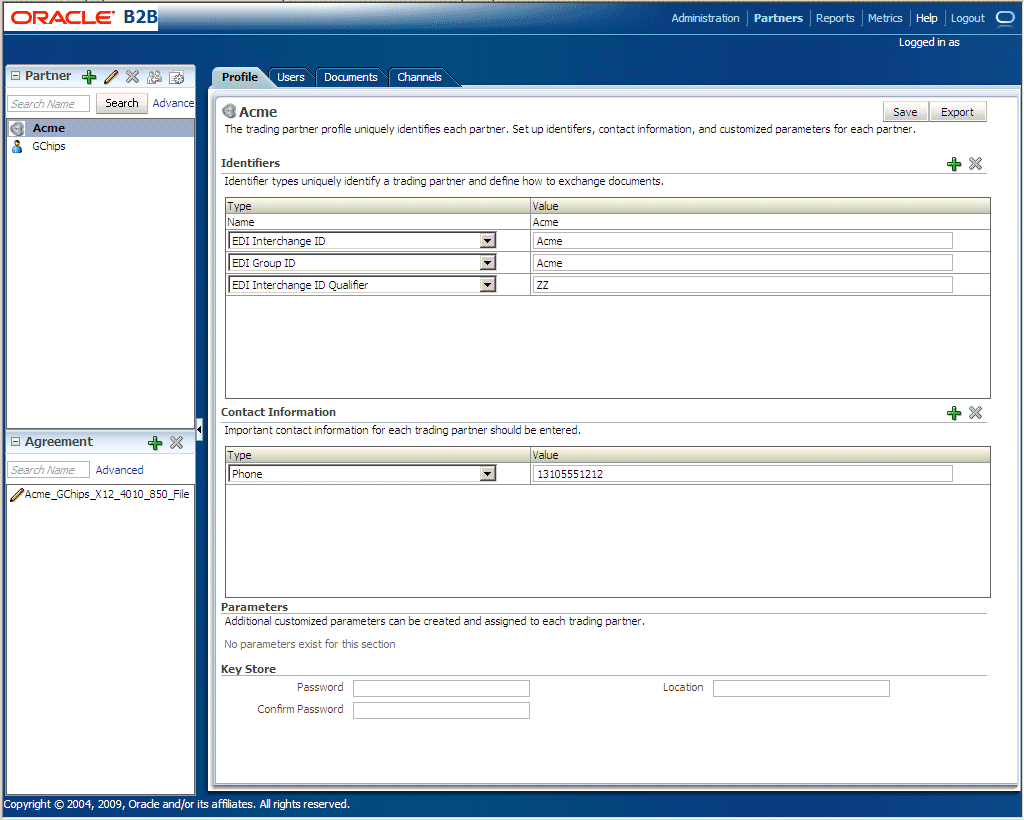

Use the tabs of the Partners page, shown in Figure 2-4, to create and update trading partner information, create and update agreement information, add user information, associate documents with trading partners, set up channels, and configure the key store.
See Part II, "Oracle B2B Process Flow" for more information.

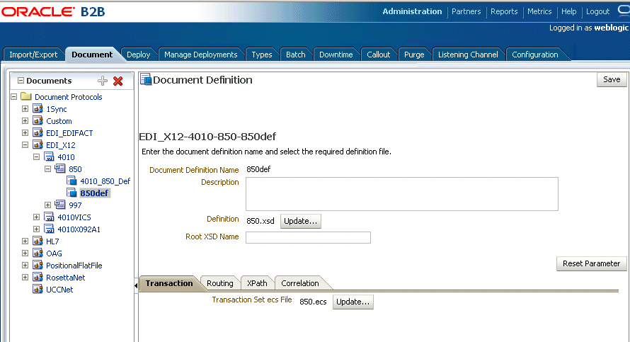

Step 2: Create document definitions
Using the Administration > Document tab of Oracle B2B, shown in Figure 2-10, select from a list of document protocols, and then provide a document protocol version name, a document type name, and a document definition name. (For a Custom document, rather than selecting from the list of document protocols, you add a custom protocol name to the list in the Document Protocols folder.)
Figure 2-10 Creating a Document Definition
After selecting the ECS and optional XSD files you created in Step 1, you have created the document definition.
For more information, see Chapter 4, "Creating Document Definitions."

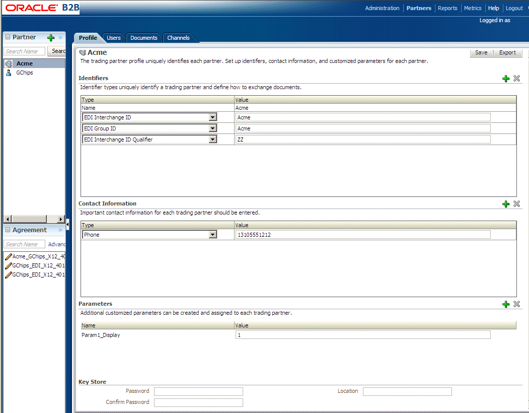

Step 3: Configure trading partners
Using the tabs of the Partners page of Oracle B2B, shown in Figure 2-11, add or update trading partner names, add identifiers and optional contact information, view parameters, add documents and delivery channels, and add key store information.
For more information, see Chapter 5, "Configuring Trading Partners."

On the Document Definition page, expand the tree to select a document definition. If you select a document definition with multiple root elements, then select a root element to use and click OK.
Table 2-7 describes other options on the page.
Table 2-7 Document Definition Page Options
| Option | Description |
Search |
Enter a definition name. Partial strings are matched if you type the beginning of the definition name. Partial strings with wildcards cannot be used. |
Refresh |
Retrieves the document definition list from the B2B server. Refresh after a search to see all document definitions. |
B2B Configuration |
Opens a browser to Oracle B2B, using the connection specified on the Application Server Connection page. In Oracle B2B, you can create a document definition, include it in an agreement, and deploy the agreement. Then return to this dialog, click Refresh, and select the new document definition. |
Use Routing ID |
Selects all document definitions that use a document routing ID. See Section 8.10, "Using Document Routing IDs," for more information. |

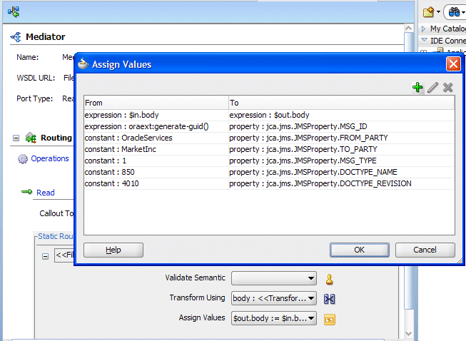

If you select the JMS integration type, then you must use JMS properties prefixed with jca.jms.JMSProperty, as in jca.jms.JMSProperty.property_name. (In contrast, when you select the Default or AQ integration types in the B2B Configuration Wizard, message properties such as MSG_ID, INREPLYTO_MSG_ID, FROM_PARTY, TO_PARTY, ACTION_NAME, MSG_TYPE, DOCTYPE_NAME, and DOCTYPE_REVISION can be used in the SOA composite application without any changes.)
Table 2-9 lists the JMS properties to use with the Oracle JCA Adapter for JMS.
Table 2-9 JMS Adapter Properties
| Property Name | Property Name When Used with the Oracle JCA Adapter for JMS |
MSG_ID |
jca.jms.JMSProperty.MSG_ID |
INREPLYTO_MSG_ID |
jca.jms.JMSProperty.INREPLYTO_MSG_ID |
FROM_PARTY |
jca.jms.JMSProperty.FROM_PARTY |
TO_PARTY |
jca.jms.JMSProperty.TO_PARTY |
ACTION_NAME |
jca.jms.JMSProperty.ACTION_NAME |
MSG_TYPE |
jca.jms.JMSProperty.MSG_TYPE |
DOCTYPE_NAME |
jca.jms.JMSProperty.DOCTYPE_NAME |
DOCTYPE_REVISION |
jca.jms.JMSProperty.DOCTYPE_REVISION |
ATTACHMENT |
jca.jms.JMSProperty.ATTACHMENT |
A2A |
jca.jms.JMSProperty.A2A |
For JMS message correlation, set the property A2A=true. If MSG_ID is provided from the back-end application, then MSG_ID is set as JMS Correlation ID in the B2B output, otherwise the JMS Message ID is set to JMS Correlation ID in the B2B output.
For example, these sender properties and values are added in the Assign Values dialog of the Mediator component for an outbound composite, as shown in Figure 2-15.
Figure 2-15 Adding JCA JMS Properties in the Assign Values Dialog
