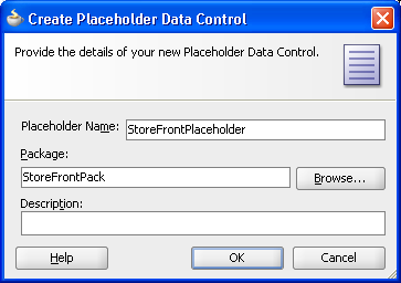

To create a placeholder data control:
In the Application Navigator, right-click the project and choose New.
In the New Gallery, expand Business Tier, select Data Controls and then Placeholder Data Control, and click OK.
In the Placeholder Data Control dialog, as shown in Figure 29-1, enter:
Placeholder Name: The name of the placeholder data control.
Directory Name: The package name that will be used to reference the placeholder data control.
Description: Optional description of the placeholder data control.
Click OK.

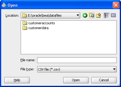

If you have a sample data file in comma-separated value or CSV format, you can automatically create all the attributes and load sample data using the sample data file import function. You do not need to create the attributes. JDeveloper will automatically create them for you from the format of the CSV file, which should be a comma-separated value list of column headings. The attributes default to type String
. You can manually reset each attribute to another type as required. For instructions to import sample data, see Section 29.3.6, "How to Add Sample Data".

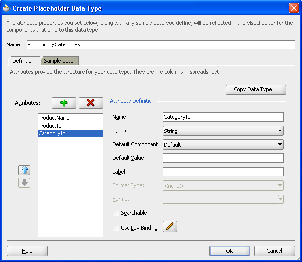

To create a placeholder data type manually:
In the Data Controls panel, right-click the placeholder data control and choose Create Placeholder Data Type.
Figure 29-3 shows the Create Placeholder Data Type dialog.
If you had already added placeholder data types previously and want only to add or edit them, choose Edit Placeholder Data Type from the context menu instead. The dialog that appears will be the Edit Placeholder Data Type dialog. It has the same options as the Create Placeholder Data Type dialog.If you already have data types defined for another placeholder data control, and you want to copy or append them, click Copy Data Type.
In the Copy Placeholder Data Type dialog, as shown in Figure 29-4, select the placeholder data type you want. Select Replace to replace the current attributes with the attributes from the file, or select Append to add the attributes from the file to the list of current attributes.
Select the Copy Sample Data checkbox to load sample data from the file.
Click OK.
In the Create Placeholder Data Type dialog, enter a name for the placeholder data type, and then in the Attributes Definition section, enter:
Name: Enter a name for the attribute.
Type: Select a type for the attribute from the dropdown list. The supported types are String
, Boolean
, Date
, and Number
Default Component: Select a default component for the attribute from the dropdown list. For an LOV, select Combo Box List of Values.
Default Value: Enter the initial value for the attribute.
Label: Enter a label for the attribute. The label will be used when the component is displayed.
Format Type: This field is enabled only when the type is Date
or Number
. Select a format type from the dropdown list.
Format: This field is enabled only when a format mask has been defined for that format type.
Searchable: Select this checkbox to make the attribute searchable.
Use Lov Binding: Select this checkbox if you want the attribute to be an LOV. To configure the attribute, see Section 29.3.3, "How to Configure a Placeholder Data Type Attribute to Be an LOV".
Click the Add icon to add more attributes.
To add data, use the Sample Data tab. For that procedure, see Section 29.3.6, "How to Add Sample Data".
You need sample data for runtime and for a consistent design time.
Click OK.

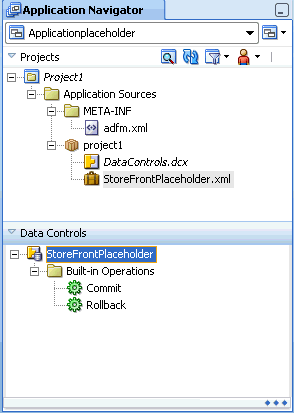

In the Data Controls panel, a placeholder data type node appears under the placeholder data control. Expanding the node reveals the presence of each of the attributes, the Built-in Operations node, and the Named Criteria node.
Figure 29-5 shows a placeholder data control as it appears in the Data Controls panel.

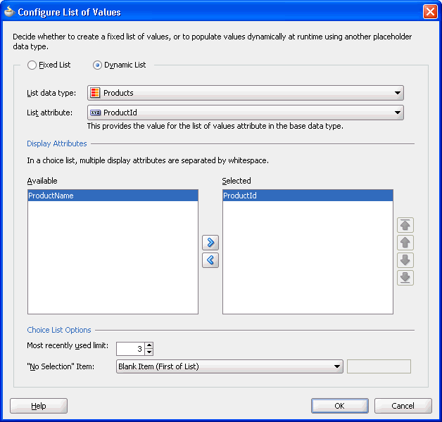

Before you begin, you should have already created another placeholder data type to serve as the source of the dynamic LOV.
To configure an attribute to be a dynamic LOV:
In the Data Controls panel, right-click the placeholder data control and choose Create Placeholder Data Type or Edit Placeholder Data Type.
In the Create Placeholder Data type or Edit Placeholder Data type dialog, select the Use Lov Binding checkbox.
The Configure List of Values dialog appears, as shown in Figure 29-7.
In the dialog, select Dynamic List.
Select the list data type with the source attribute. You must have a source placeholder data type for this selection to be available.
Select the list attribute.
Shuttle the attribute from the Available list to the Selected list.
Select the maximum number of the most recently used items that will be displayed in the dropdown list.
From the No Selection Item dropdown list, select an option for how you want the "no selection" item to be displayed. For instance, selecting Blank Item (First of List) will display the "no selection" item as a blank at the beginning of the list.
Click OK.

attribute, 1
was entered for the ProductID
attribute, and 4
was entered for the CategoryID
attribute.
Click OK.
Before you begin, you should have the sample data file available on your system so it can be found in the Select/Save File dialog.
To import sample data from CSV files into placeholder data types:
In the Create Placeholder Datatype or Edit Placeholder Datatype dialog, click the Sample Data tab.
Tip:
If you already have a CSV file for importing, you do not need to manually create the attributes for each column. JDeveloper automatically creates the attributes from the first row of the CSV file. For more information, see Section 29.3.1, "How to Create a Placeholder Data Type".If you are also importing attributes, you must delete the default "attribute" in the first row.
This default attribute appears when you first navigate to the Sample Data tab. If you do not remove this default attribute, JDeveloper will assume that this is a declaratively created attribute and will not import any other columns except for the first column.
Click Import.
In the Open dialog, navigate to and select the import file, and click Open, as shown in Figure 29-11.
The data from the CSV file, including column heading and values, should appear as sample data.
Click OK.
