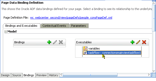

To access the Edit Task Flow Binding dialog:
  1. Open the application page and set the view to bindings by clicking the Bindings tab at the bottom of the page.
  2. Under Executables, double-click the task flow for which to revise task flow binding parameters (Figure 40-1) to open the Edit Task Flow Binding dialog (Figure 40-2).
    Tip:
    Task flow names under Executables differ from names in design view. For example, Message Board task flows are instead referred to as wall, and Feedback task flows are instead referred to as kudos.
    Figure 40-1 Bindings View of an Application Page
    Bindings view of an application page
    Description of "Figure 40-1 Bindings View of an Application Page"

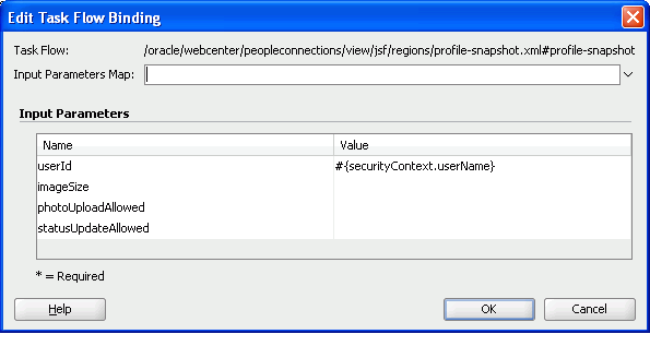

    Figure 40-2 Edit Task Flow Binding Dialog
    Description of "Figure 40-2 Edit Task Flow Binding Dialog"
  3. Revise binding parameter values (for more information, see Section 40.2, "People Connections Task Flow Binding Parameters").
  4. Click OK to save your changes and exit the dialog.
