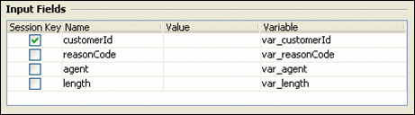

For the first action, set the type to Message and the Integration Point name to CallBegin. In Input Fields, right-click and choose Add item to add an input field. Double-click in the space under Name and enter the value customerId; press Enter to register the new value. In the Variable column for customerId, choose var_customerId from the drop-down list. Select Session Key to identify this field as the session key.
For the action ServiceComplete, add three additional fields, as shown in Table 3-3.

Again, the names here must match exactly with the incoming parameter IDs for the ServiceComplete Informant as seen in Decision Studio. Use the Toggle icon on the Inline Service Explorer task bar in Decision Studio to toggle between the label of the object and its object ID:
Figure 3-1 shows what the completed Input Fields section for ServiceComplete should look like.
Figure 3-1 Input Fields for ServiceComplete

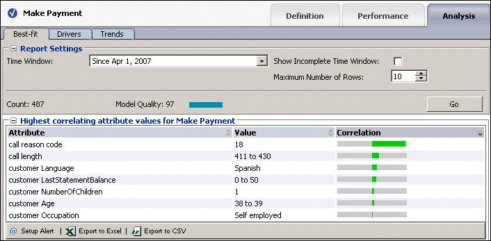

You can use the Decision Center to check what has been learned by the models after running Load Generator. To do this:
Open Decision Center by opening a Web browser and going to the URL http://server_name:9704/ui. Log in using the user name and password provided for you, as described in Section 2.2, "About Deployment and Decision Center Security."
Click Open Inline Services. The Select Inline Service window appears. Select Tutorial, then expand Call Reason and select one of the Choices, such as Make Payment. In the right pane, navigate to the Analysis tab and then the Best-fit subtab. This report summarizes the number of times this call reason was seen, and correlations between this call reason and attribute values.
You will see something interesting. The call reason code has an unexpectedly strong correlation to Make Payment, as shown in Figure 3-2.
Figure 3-2 Correlating Attribute Values for Make Payment
Since we generated the call data randomly with Load Generator variables, we would not expect to have any significant correlations. In this case, however, the call reason code (sent by the ServiceComplete Informant) absolutely determines the call reason (see Section 2.9.5, "Testing It All Together" for a discussion of this logic).
To remove this induced correlation, we should exclude this attribute from being used as an input to the model. Another type of attribute we might exclude from models is a customer's full telephone number. After all, it is unlikely that correlations can be found between unique telephone numbers and the reason he/she called. On the other hand, there may be correlations between the area codes of customers and the call reasons, so this would be an attribute that we would not exclude from the model. In the next section, you will exclude the 'reason code' attribute from the model and re-run the Load Generator script.
