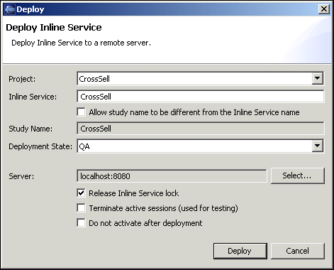

Deploy the Inline Service using the Project > Deploy menu item, or click the Deploy icon on the task bar:
The Deploy dialog box appears. The options in the Deploy dialog box are shown in Figure 14-1.
Note: You must have the proper permissions on the server cluster to deploy an Inline Service. See Oracle Fusion Middleware Administrator's Guide for Oracle Real-Time Decisions for more information about cluster permissions. |
Table 14-1 describes the options shown in the Deploy dialog box.
Table 14-1 Options in the Deploy Dialog Box
| Option Name | Description |
Project |
Choose the project that you will deploy to Real-Time Decision Server. |
Inline Service |
The Inline Service contained in this project. |
Study Name |
Enter a study name for this Inline Service. Each Inline Service's learnings are associated with a study name. If you want to redeploy an Inline service and restart its learnings, deploy it with a new study name. Different study names can be used for Development, QA, and Production. |
Deployment State |
The default deployment states of Inline Services are Development, QA, or Production. Deployment state marks an Inline Service that is in development, testing, or production so that others are aware of its state. Your system administrator may have created custom deployment states. |
Server |
Click this option to enter the server and port to which you want to deploy. In the Server dialog box, provide a valid username and password that has deployment authorization on the server cluster to which you are deploying. Cluster authorization is granted through JConsole by your administrator. |
Release Inline Service lock |
A deployed Inline Service is automatically locked, and only the user who deployed it is able to redeploy the Inline Service. Once you have completed development and testing and are deploying the Inline Service for production, select Release Inline Service lock to allow Decision Center users to make changes and redeploy the Inline Service. |
Terminate Active Sessions |
If the Inline Service you are deploying is in production, there may be active sessions. If a new version of the Inline service is deployed while there are active sessions, the older version will be maintained to service those sessions. Select Terminate Active Sessions to terminate the active sessions if you are in testing. For a production Inline Service, keep this option deselected so that any active sessions will continue to run on the production version of the Inline Service. New sessions will be routed to the new version, and the old version will terminate when all active sessions have completed. |
Do not activate after deployment |
Use this option to deploy the Inline Service to the server, but not start the process. If you would like to activate the Inline Service at a later date, use Fusion Middleware Control. For more information about Fusion Middleware Control, see Oracle Fusion Middleware Administrator's Guide for Oracle Real-Time Decisions. |
Note: After an Inline Service with custom pages is deployed to a certain deployment state, for example Development, the list of custom pages for this state will override the list of custom pages for the same Inline Service previously deployed to any deployment state. |

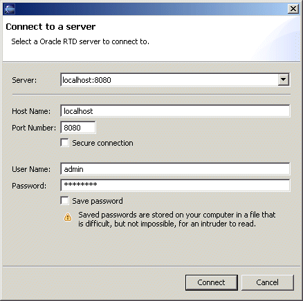

When deploying or downloading Inline Services or importing data sources, you connect to Real-Time Decision Server. To connect, use the username and password you created on installation, or consult your Administrator for your username and password. To connect in a secure manner using https, select Secure connection.
Figure 14-2 shows the Connect to a Server dialog box.
Figure 14-2 Connect to a Server Dialog Box
