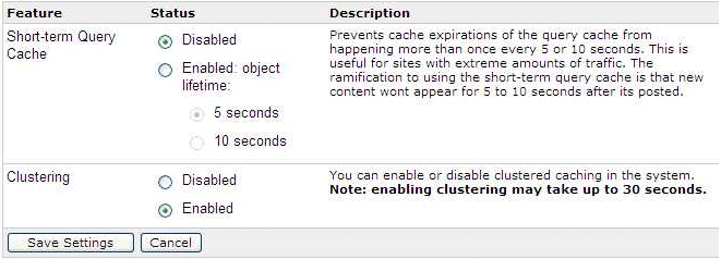

6.15 Configuring Clustering for Discussions Server
If this is a Unicast cluster, first ensure that the steps in Section 6.14, "Converting Discussions Forum from Multicast to Unicast" are performed first.
Ensure that all members of the Discussions Server cluster can communicate with each other using the Discussions Server Administration Console:
  1. Login to each member of the cluster at:
    http://<host>:<port>/owc_discussions/admin
  2. Go to Cache Settings.
    Figure 6-1 Cache Settings Section
    Description of Figure 6-1 follows
    Description of "Figure 6-1 Cache Settings Section"
  3. At the bottom of the page, in the Cache Features section, ensure that Clustering is set to Enabled.
    The top of the page should now list all members of the cluster.

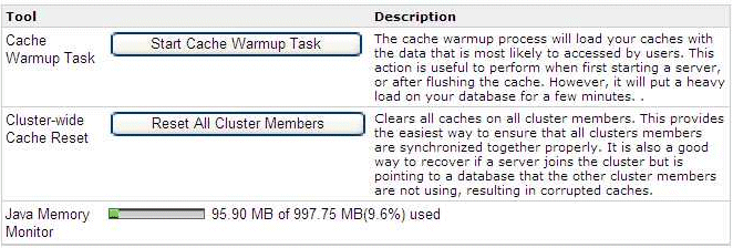

  4. Again, towards the end of the page, under the Cache Tools section, do Cluster wide cache reset and the Cache warm up Task. Repeat the Cache warm up task on all members of the cluster.
    Figure 6-2 Cache Tools Section
    Description of Figure 6-2 follows
    Description of "Figure 6-2 Cache Tools Section"
