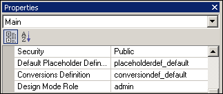

The user roles that have access to design mode are set in the properties pane for the Web site or section of a Web site in Designer.
It is important to note that the role is set, not a specific user.
When the design mode role is set, it is applied site-wide. You cannot limit design mode access to certain sections.
