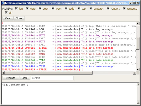

The Contributor console window is the Contributor application's cross-browser and cross-platform logging mechanism. The Contributor console window is specially suited to accommodate logging and to facilitate JavaScript code execution across multiple HTML windows from within a single browser window.
All instructions logged to the Contributor console window's logging window (the top portion of the Contributor console window) display the time of execution and the context in which the instruction was executed. The lower portion of the window (the command window) is used to execute JavaScript.

The upper portion of the Contributor console window is the logging window. Each instruction logged displays the time of execution and the context of the instruction. From the logging window's toolbar, you can clear the logging window and filter the list of logged items by selecting the different logging types.
The lower portion of the Contributor console window is the command window. The command window is where arbitrary JavaScript code can be executed. Code can be executed within any context in the Contributor application by specifying a context ID in the command window's context field. A list of available contexts can be viewed by executing the following code snippet in the command window:
$D().contexts();
Either the context's file name or the context's ID can be used in the command window's context field. When the command window's toolbar context field is properly set, all code executed in the command window executes within the designated window object's context.
The Contributor console window has a very simple interface.

The Contributor console window has the ability to log color-coded lines within the logging window to easily identify certain types of messages. Furthermore, these messages can be filtered by the Contributor console window.
The lines display in these colors:
| Message Type | Display color |
| Log | Black |
| Note | Purple |
| Error | Red |
| Warning | Dark Red |
| Todo | Green |
| Test | Blue |
| Executed command | Grey |
| Request | Blue (italics) |
| Response | Dark red (italics) |

Enter the following into the command window and click Execute to demonstrate the different logging types:
$D().log('This is a log message.', window);
$D().note('This is a note message.', window);
$D().error('This is an error message.', window);
$D().warn('This is a warning message.', window);
$D().todo('This is a todo message.', window);
$D().test("'This is a test that succeeds.' === 'This is a test that succeeds.'", window);
$D().test("'This is a test that fails.' !== 'This is a test that fails.'", window);
$D().request('This is a request message. A request message should be reserved for logging server requests.', window);
$D().response('This is a response message. A response message should be reserved for logging server responses.', window);
$D().startProfiling('MYprofileID', window);
$D().stopProfiling('MYprofileID', window);
$D().exec("(function(){ return 'Returning this line of code.'; })() // A self-executing function.", window);
