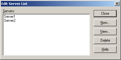

The Edit Server List dialog shows all defined content server connections on your computer. You can add a new server connection, view or edit the properties of an existing one, or delete a server connection.
Please note that the list shows the defined server connections on your own computer only, not on other people's computers. Also, any defined server connections will continue to exist on your computer after you remove, reinstall, or update the Desktop Integration Suite client software; in other words, they will still be included in the server list the next time you open the Edit Server List dialog.
| Element | Description |
| Servers | This area lists all defined content server connections for your own computer. |
| Close | Click this button to close this dialog. |
| New... | Click this button to open the Add Server dialog (see Section A.1, "Add Server Dialog"), where you can define a new content server connection. |
| View... | Click this button to open the Edit Server dialog (see Section A.5, "Edit Server Dialog"), where you can view the properties of the selected content server connection and set a number of options for it. This button is available only if you select a content server in the list. |
| Delete | Click this button to delete a content server connection. This button is available only if you select a content server in the list. |
| Help | Click this button to display context-sensitive help information for this dialog. |

| Edit Server List | Click this button to open the Edit Server List dialog (see Section A.4, "Edit Server List Dialog"), where you can view all defined content server connections, as well as add, modify, and delete connections. |

| Select a server | This list includes all defined Oracle Content Server connections on your computer. You can switch between content servers by selecting a different item on the list.
Please note that the list of available servers only includes Oracle Content Server instances; it does not show any Oracle Content Database servers or other WebDAV servers. If you select a different server than the current one, you may be prompted to provide your login name and password (depending on the server configuration). |
| Click this button to open the Edit Server List dialog (see Section A.4, "Edit Server List Dialog"), where you can manage your defined content server connections. | |

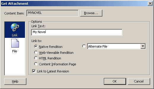

The Get Attachment dialog is used to retrieve a file from a content server and attach it to the current e-mail message. This dialog comprises multiple pages, each representing a different item to attach to the e-mail:
Link: This page enables you to select a file on a content server and attach it to the current e-mail message. For more information, see Section A.18.1, "Insert Content Item: Link."
File: This page enables you to select a file on a content server and attach it to the current e-mail message. For more information, see Section A.18.2, "Insert Content Item: File."
The Link panel of the Get Attachment dialog enables you to select a file on a content server and include a link to this file in the current e-mail message in your e-mail application. You search for the file using the standard search features of the content server (browsing or criteria-based query, if available). You can set the hyperlink text and also choose the file rendition and revision that the hyperlink should point to. The hyperlink is inserted at the current cursor position in the e-mail message.
| Content Item | This field shows the content ID of the selected file on the content server that the hyperlink will point to. |
| Browse | Click this button to open the Select Content dialog, where you can select a file on a content server. You search for the file using the standard search features of the content server (browsing or criteria-based query, if available). For more information, see Section A.9, "Select Content Dialog." |
| Link Text | This field shows the hyperlinked text that will be inserted into the current e-mail message. The default is the title of the selected content item (as stored on the content server), but you can modify this as required. If you provide no text at all, the link text will be the full URL to the selected link target. |
| Link to | This lists all available file targets that the hyperlink can point to:
| Link to Latest Revision | Select this check box if you want the hyperlink to always point to the latest released revision of the file on the content server. This means that the link target will always be up to date.
If you clear this check box, the hyperlink references a specific revision of the file, which means it will point to an older revision of the file if that file is updated on the content server. |
| OK | Click this button to close the dialog and insert a hyperlink to the selected content item into the current e-mail message Office document. |
| Cancel | Click this button to close the dialog without doing anything. |
