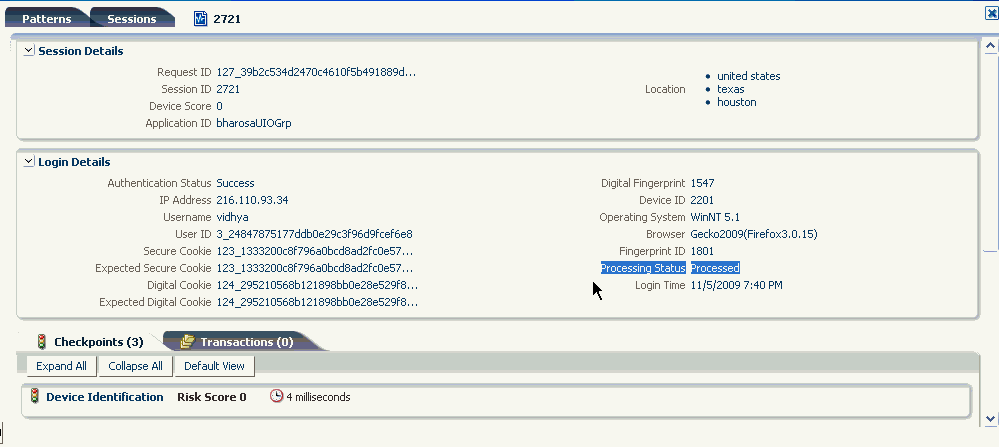

Verify that autolearning is functional
Question/Problem: I enabled autolearning and configured the policies. How do I verify that autolearning is running?
Answer/Solution: To verify if autolearning is turned on and working:
Log in to the system.
Run a few logins.
To find out whether autolearning data of a session has been processed, go to the Session Details page of that session and view the Processing Status field in the Login Details section.
If autolearning has not been set up correctly, data will not have been processed.
