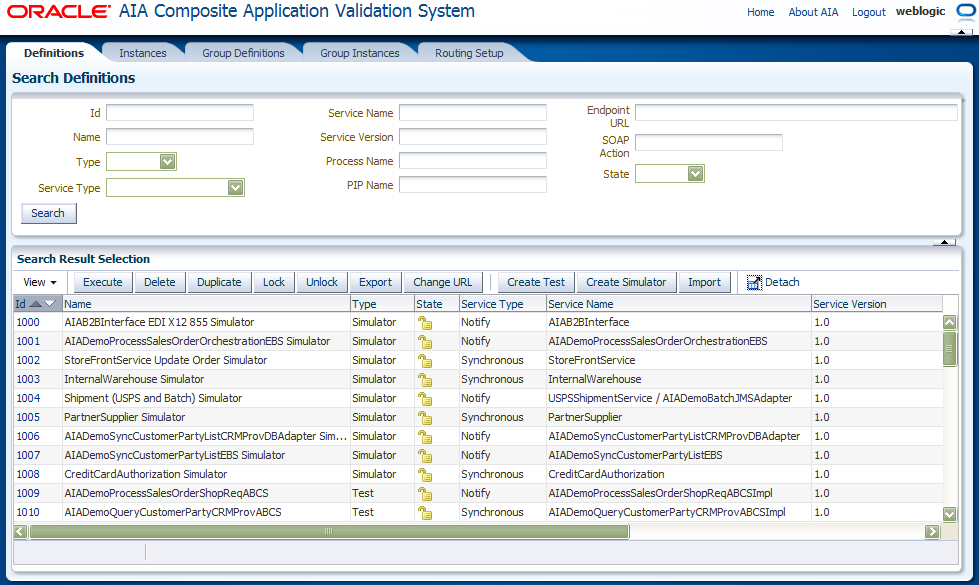

Access the Oracle Application Integration Architecture (AIA) Home Page. In the Composite Application Validation System area, click the Go button. Select the Definitions tab. The Definitions page displays, as shown in Figure 6-1 and Figure 6-2.
Use the page elements on the Definitions page to search for, execute, migrate, and manage existing test and simulator definitions. You can also access pages you can use to create and modify test and simulator definitions.
Search Definitions
Use the Search Definitions group box to enter search criteria to find the test or simulator definition you are searching for.
Available elements in the Search Definitions group box are discussed in Table 6-1.

Search Result Selection
Use the Search Result Selection grid to work with definitions returned in your search results. Upon accessing this page, the grid displays all definitions.
Available elements in the Search Result Selection grid are discussed in Table 6-2.

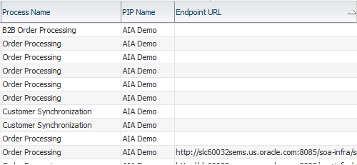

Change URL |
Select one or more test definitions for which you want to change the endpoint URL value. Click Change URL to launch a pop-up window in which you can enter the new endpoint URL value that you want to use for the selected test definitions. |
