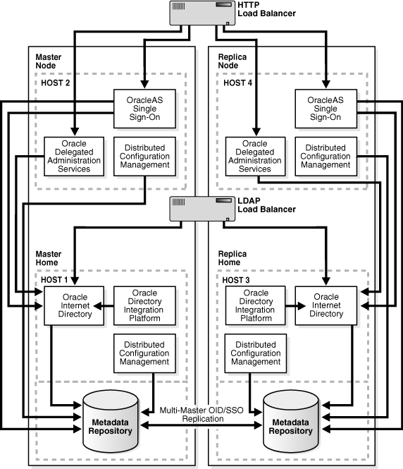

Figure 16-1 shows a typical Oracle Identity Management 10g Release 2 (10.1.2) multimaster replication environment, which is described in detail in "Deploying Identity Management with Multimaster Replication," in the 10g Release 2 (10.1.2) Oracle Fusion Middleware High Availability Guide.
Figure 16-1 A Typical Oracle Identity Management 10g Release 2 (10.1.2) Multimaster Replication Environment
Description of Figure 16-1 follows
Description of "Figure 16-1 A Typical Oracle Identity Management 10g Release 2 (10.1.2) Multimaster Replication Environment"
