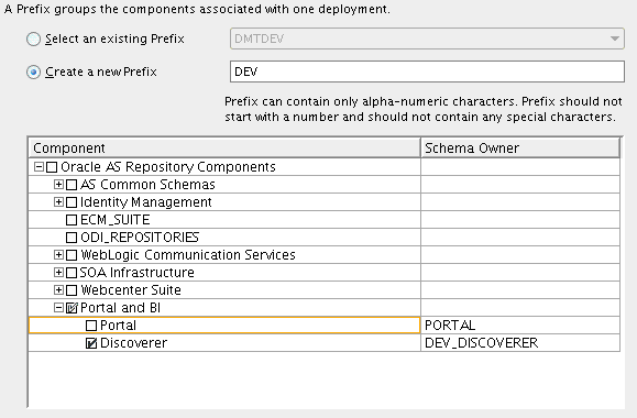

When you are upgrading Oracle Portal, Forms, Reports, and Discoverer, there is no need to install all the Oracle Fusion Middleware schemas. Instead, you can install only the schemas required for the Oracle Portal, Forms, Reports, and Discoverer upgrade.
Figure 3-1 shows the options available in the Repository Creation Utility when you are prompted to select the schemas to install. Specifically, note the following when this screen appears:
The only required schema for an Oracle Portal, Forms, Reports, and Discoverer upgrade is the Discoverer schema. This schema is required only if you associated Oracle BI Discoverer 10g with an Oracle Infrastructure 10g (database schema).
This schema is required at this point in the upgrade process because, unlike the Oracle Portal schema upgrade, the Discoverer schema is upgraded "out-of-place." This means that the Upgrade Assistant copies data from the Oracle Application Server 10g Discoverer schema to the new 11g Discoverer schema. As a result, you must install the Oracle BI Discoverer 11g schema; otherwise, you will not be able to install Oracle Business Intelligence Discoverer 11g or upgrade your 10g Discoverer schema.
Do not select the Portal schema. When you later run the OracleAS Upgrade Assistant, your existing Oracle Application Server 10g Portal schema will be upgraded "in-place" to 11g; as a result, there is no need to install a new Oracle Portal 11g schema.
No schemas are required for Oracle Forms Services or Oracle Reports.
Figure 3-1 Selecting the Required Schemas for an Oracle Portal, Forms, Reports, and Discoverer Upgrade

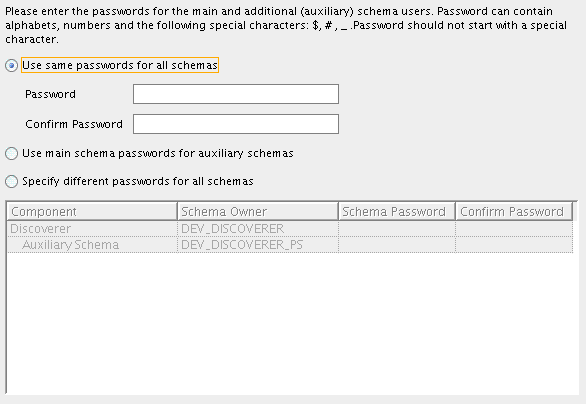

After you select the Oracle BI Discoverer schema, the Repository Creation Utility prompts you to provide a password for the schema. You must provide a password for each schema you are installing in the database; otherwise, you will not be able to install the schemas.
Note that you will need to know the Oracle BI Discoverer schema passwords later, when you are prompted to connect to the database during the Oracle Portal, Forms, Reports, and Discoverer installation procedure.
Figure 3-2 shows the Repository Creation Utility Schema Passwords page, which appears after you have selected component schemas for an Oracle Portal, Forms, Reports, and Discoverer upgrade.
You can enter a different password for each schema, or use the same password for all the schemas.
Figure 3-2 Repository Creation Utility Schema Passwords Page

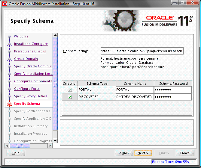

If you are configuring Oracle Portal in preparation for an upgrade from Oracle Portal 10g, then the installer prompts you for the name and password of the Oracle Portal schema (Figure 3-3).
It is important that you enter the name and password of the Oracle Application Server 10g PORTAL schema, as follows:
In the Schema Name column, enter PORTAL.
In the Schema Password column, enter the password for the 10g PORTAL schema. For more information, see Section 3.5.4.4, "Locating the Oracle Portal 10g Schema Password in the Oracle Internet Directory"
Figure 3-3 Specify Schema Screen From an Oracle Portal, Forms, Reports, and Discoverer Installation
If you are configuring Oracle BI Discoverer in preparation for an upgrade from Oracle BI Discoverer 10g, then the installer prompts you for the name and password of the Oracle Fusion Middleware 11g DISCOVERER schema (Figure 3-3).
It is important that you enter the name and password of the Oracle Fusion Middleware 11g DISCOVERER schema that you created using the Repository Creation Utility in Section 3.4, "Task 4: Use the Repository Creation Utility to Install the Oracle BI Discoverer Schema in the Database".
Enter the following information about the DISCOVERER schema on the Specify Schema screen:
In the Schema Name column, enter the schema name and prefix that you used when you created the schema with Repository Creation Utility. For example, DEV_DISCOVERER.
In the Schema Password column, enter the password that you provided for the DISCOVERER schema in Repository Creation Utility.

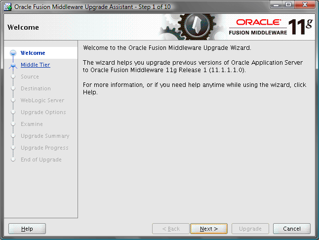

The Upgrade Assistant displays the Welcome screen as shown in Figure 3-4.
Figure 3-4 Upgrade Assistant Welcome Screen

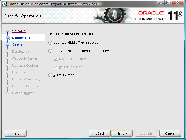

Click Next to display the Specify Operation screen (Figure 3-5).
The options available in the Upgrade Assistant are specific to the Oracle home from which it started. For example, when you start Upgrade Assistant from an Oracle Portal, Forms, Reports, and Discoverer Oracle home, the options shown on the Specify Operation screen are the valid options for an Oracle Portal, Forms, Reports, and Discoverer Oracle home.
Figure 3-5 Upgrade Assistant Select Operation Screen for an Oracle Portal, Forms, Reports, and Discoverer Upgrade

Select Upgrade Middle Tier Instance on the Specify Operation screen (Figure 3-5).
