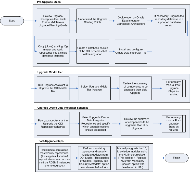

Figure 1-1 provides a flowchart of the Oracle Data Integrator upgrade process. Review this chart to get familiar with the steps you will be required to take, based on your existing Oracle Data Integrator environment.
Table 1-1 describes each of the steps in the upgrade process flowchart which is shown in Figure 1-1. The table also provides information on where to go to get more information on each step in the process.
