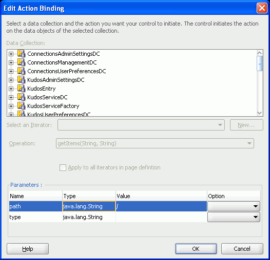

27.1.1 The getItems Method
The getItems method returns the files and folders stored starting at a particular location in the repository. This method enables you to publish content in forms, tables, and hierarchical trees. Using this method, you can also create navigation lists and buttons.
Table 27-1 describes the parameters of the getItems method.
Table 27-1 Parameters of the getItems Method
Parameter Description
path
Defines the starting point for getItems.
type
Specifies what should be returned: only files, only folders, or any object.

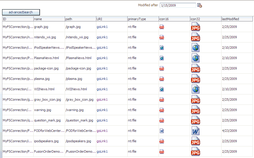

27.1.3 The advancedSearch Method
The advancedSearch method enables you to perform an advanced search by creating a set of search criteria out of any available attribute.
Table 27-5 describes the parameters of the advancedSearch method.
Table 27-5 Parameters of the advancedSearch Method
path
Starting path of the search.
isRecursive
Specifies whether only the specified folder (=false) or the whole tree starting at the specified path (=true) should be searched.
The default value is false, that is, if this field is left blank, then the search is performed in the specified folder. Only if the value is true, the search is performed in the entire hierarchy.
keyword
Search keyword for full text search.
namePattern
Pattern search on name. Use the % wildcard to match any number of characters and the _ wildcard to match one character.
matchAny
Specifies whether all predicates (=false) or any predicate (=true) should be matched.
predicates
A collection of SimplePredicate parameters that consist of attributes, comparators, and values.
type
The advancedSearch method returns the attributes described in Table 27-6.

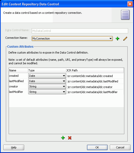

  4. In the Data Control Name field, enter a name for your data control, for example MyDataControl.
  5. To add custom attributes, click Add. Then, enter a name for the attribute as it should appear in the Data Controls panel, select its type, and enter the JCR path.
    In Oracle Content Server, a metadata attribute named dPropertyName is mapped in the adapter as shown here:
    jcr:content/idc:metadata/idc:dPropertyName
    For example, if the property name is dWorkflowState, then it is mapped as jcr:content/idc:metadata/idc:dWorkflowState.
    In Oracle Portal, a metadata attribute is mapped in the adapter as shown here:
    portal:name of the attribute in Oracle Portal
    To retrieve the JCR paths of item attributes, run the getAttributes method on the required items. Then reenter the wizard to include those paths by right-clicking the respective data control in the Data Controls panel and choosing Edit Definition.
  6. Click OK.

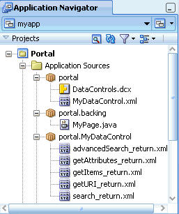

The following files (Figure 27-2) are created under the Portal project:
  • DataControls.dcx: Oracle JDeveloper creates this file the first time a data control is created. This file lists all the Oracle ADF data controls created under the current project. This file is required to initialize the data control.
  • datacontrolname.xml: This file includes attributes, accessors, and operations of a data control.
  • advancedSearch_return.xml: This file includes the return type definition for the advancedSearch method.
  • getAttributes_return.xml: This file includes the return type definition for the getAttributes method.
  • getItems_return.xml: This file includes the return type definition for the getItems method.
  • getURI_return.xml: This file includes the return type definition for the getURI method.
  • search_return.xml: This file includes the return type definition for the search method.
  • Return.xml: This file defines the standard operations on collections.

  2. Under Data Controls panel, right-click the data control you intend to edit, and choose Edit Definition, as shown in Figure 27-3. The Edit Content Repository Data Control dialog displays, as shown in Figure 27-4.
    Figure 27-3 Edit Data Controls
    Description of Figure 27-3 follows
    Description of "Figure 27-3 Edit Data Controls"
    Figure 27-4 Edit Content Repository Data Control Dialog
    Description of Figure 27-4 follows
    Description of "Figure 27-4 Edit Content Repository Data Control Dialog"
  3. To select a different connection, use the Connection Name list.
  4. To add a connection, click the Create new content repository connection icon to display the Create Content Repository Connection dialog. Depending on the type of connection that you intend to create, see relevant sections in Section 26.2, "Configuring Content Repository Connections" for information about its configuration parameters.
  5. To edit an existing connection, click the Edit selected content repository connection icon to display the Edit Content Repository Connection dialog. Depending on the type of connection that you intend to modify, see relevant sections in Section 26.2, "Configuring Content Repository Connections" for information about its configuration parameters.
  6. To add or remove custom attributes, use the Add new attribute icon and the Remove selected attribute icon respectively in the Custom Attributes box.
  7. Click OK to apply the changes.

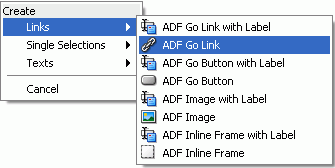

  3. To create a textual link, select the URI attribute and drop it on to the page, or in the Structure window under af:form. From the Create menu, choose Links and then ADF Go Link, as shown in Figure 27-6.
    If this is the first time you have dropped a node onto the page, then the Edit Action Binding dialog displays.
    Figure 27-6 Oracle JDeveloper Context Menu for the getURI method
    Description of "Figure 27-6 Oracle JDeveloper Context Menu for the getURI method"

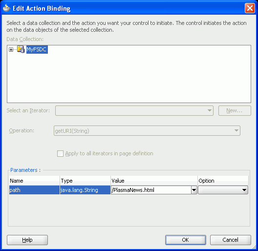

  4. In the Value field of the path parameter, enter the path of the file for which you intend to create the link, as shown in Figure 27-7. You must enter a leading slash (/), for example /PlasmaNews.html. To modify or delete this path later, click the arrow icon next to the node in design mode and choose Go to Binding from the context menu.
    Figure 27-7 Edit Action Binding
    Producer success message
    Description of "Figure 27-7 Edit Action Binding "
    To grant edit, personalize, customize, and view permissions at the attribute level, see Section 27.4, "Securing a Content Repository Data Control".
  5. Click OK.

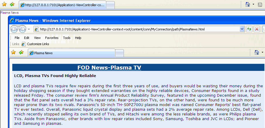

  6. Right-click the page and select Run. In your browser, you should see the URL for the file path entered in the Edit Action Binding dialog without any formatting.
  7. By default, the link displays the text goLink1. In the Structure window, select af:goLink - goLink1 and view the properties in the Property Inspector.
  8. In the Text field, enter a name for the link, for example, Plasma News, as shown in Figure 27-8.
    Figure 27-8 Go Link Properties
    GoLink Properties
    Description of "Figure 27-8 Go Link Properties"
  9. Right-click your page and choose Run. The page appears in your browser window with the new link, as shown in Figure 27-9.
    Figure 27-9 ADF Go Link in a Browser
    Help Link
    Description of "Figure 27-9 ADF Go Link in a Browser"
  10. Click the link to check that the correct file is displayed.

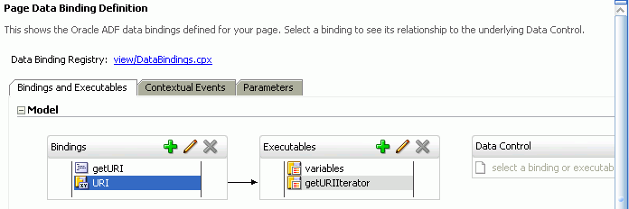

To add a link to another item, in the same JSF page:
  1. In the Application Navigator, right-click the page in which you created the ADF Go Link, and choose Go to Page Definition. The Page Data Binding Definition displays in the design view, as shown in Figure 27-10.
    Figure 27-10 Page Data Binding Definition
    Description of Figure 27-10 follows
    Description of "Figure 27-10 Page Data Binding Definition"
  2. Go to the source view of the page definition.

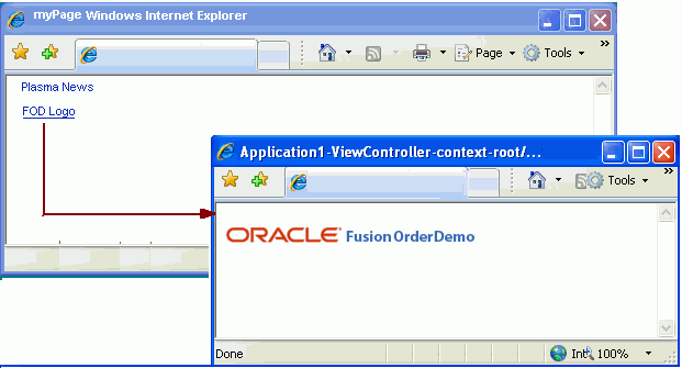

  8. In the Structure window, double-click the new goLink; for example, af:goLink2 to display the Go Link Properties window.
  9. In the Text field, enter a display name for your new link; for example, FOD Logo.
  10. In the Destination field, click the down arrow to display the Expression Builder dialog. Then, expand ADF Bindings, bindings, and URI1.
  11. Double-click inputValue variable to create the #{bindings.URI1.inputValue} expression, and click OK. This expression is based on new elements that you added in executables and bindings.
  12. Run your page. The new link should display content from the new path (NDValue) that you specified in step 4. Figure 27-12 shows the new link, FOD Logo, in addition to the Plasma News link that was added in the first part of Section 27.5.1.1, "Publishing Content As a Textual Link".
    Figure 27-12 New Textual Link
    Description of Figure 27-12 follows
    Description of "Figure 27-12 New Textual Link"
    You can add as many links as required by following these steps.

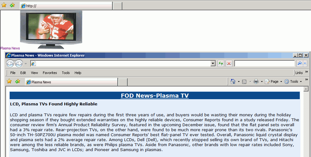

27.5.1.2 Creating a Clickable Image to Link to a Document
In this section, you will use the Image option of ADF Faces to publish a document as a clickable image, that is, clicking the image object will display your document.
To publish content as a clickable image object:
  1. In the Application Navigator, open the page, in which you created the ADF Go Link, by double-clicking it.

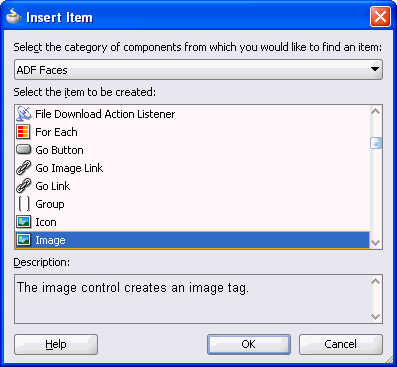

  2. To convert the textual link that you created in the first part of Section 27.5.1.1, "Publishing Content As a Textual Link", in the Structure window, right-click af:goLink - goLink1 and choose Browse. The Insert Item dialog displays.
  3. From the Select the item to be created list, select Image, as shown in Figure 27-13.
    Figure 27-13 Insert ADF Faces Item
    Description of Figure 27-13 follows
    Description of "Figure 27-13 Insert ADF Faces Item"
  4. Click OK. The Insert Image dialog displays.
  5. Browse to the image file you intend to display as the image link; for example, plasma.jpg.
  6. Click Finish.
  7. Right-click your page and choose Run. Figure 27-14 shows a sample output.
    Figure 27-14 ADF Object Image Link in a Browser
    Description of Figure 27-14 follows
    Description of "Figure 27-14 ADF Object Image Link in a Browser"

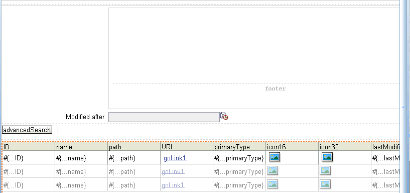

27.5.3 How to Publish Content in a Table
In this section, the getItems data control method is used to publish file and folder information in a table. This section describes the following procedures:
Before you begin:
  1. Configure a repository connection as described in Section 26.2, "Configuring Content Repository Connections".
  2. Configure a data control as described in Section 27.2, "Configuring Content Data Controls for JCR Adapters".
  3. Create a page as described in Section 5.2.2, "Adding Pages to the Portal."

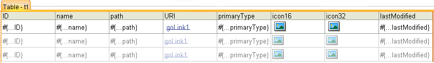

27.5.3.1 Displaying Files and Folders in Read-Only Format
Here you will create a read-only ADF table using the getItems method.
To display folder content in a read-only table:
  1. To open the page in the visual editor, double-click it in the Application Navigator.
  2. In the Data Controls panel, under your data control, expand the getItems method and the Return node, as shown in Figure 27-15.
    Figure 27-15 The Return node of the getItems method
    Description of "Figure 27-15 The Return node of the getItems method"
  3. To create a table that lists every file and folder available through this data control, drop the Return node on to the page or under af:form in the Structure window. From the Create menu, choose Table and then ADF Read-only Table , as shown in Figure 27-16.
    Figure 27-16 The Create Context Menu for getItems Method
    Description of "Figure 27-16 The Create Context Menu for getItems Method"

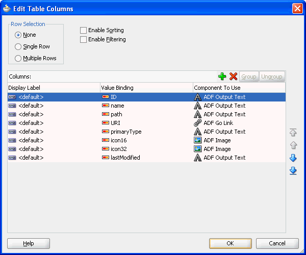

  4. In the Edit Table Columns dialog, as shown in Figure 27-17, Select the row for the getItems.name Value Binding and enter an appropriate value for the Display Label; for example, Name.
    Repeat this step for the path, URI, primaryType, and lastModified attributes. Enter new display labels such as name, Location, URL, and so on, then click OK.
    Figure 27-17 Edit Table Columns
    Description of "Figure 27-17 Edit Table Columns"

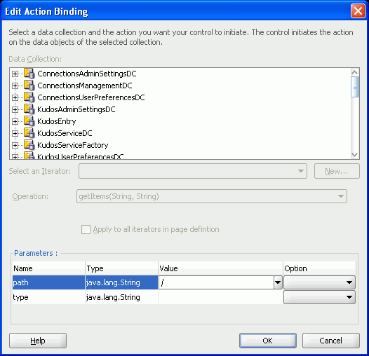

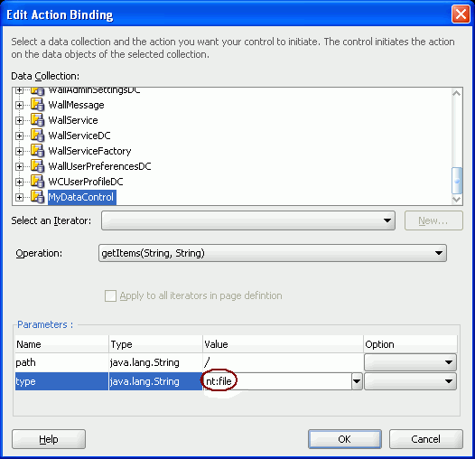

  5. If this is the first time you have dropped a node onto the page, the Edit Action Binding dialog displays.
    In the Edit Action Binding dialog, enter the path of the content directory as the path parameter, as shown in Figure 27-18. You must enter a leading slash (/). To modify or delete this path later, click the arrow icon next to the node in design mode and choose Go to Binding from the context menu.
    Leave the type parameter blank. This implies that the table displays both files and folders.
    Figure 27-18 Edit Action Binding
    Description of "Figure 27-18 Edit Action Binding "
  6. Click OK. You should now see a table on the page that looks like Figure 27-19.
    Figure 27-19 Read-Only Table for Publishing Folder Content
    Read-Only Table
    Description of "Figure 27-19 Read-Only Table for Publishing Folder Content"
    You can turn the page caching on or off. To do so, open the page definition and expand executables, and select getItemsIterator in the Structure window. Then, in the Property Inspector, set CacheResults to true or false, as required.

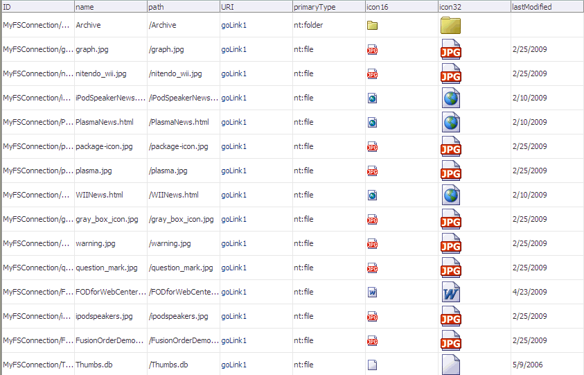

  7. Run the page. You should see a list of all files and folders available in your content directory. Figure 27-20 shows a read-only table displaying both files and folders at runtime.
    Figure 27-20 Files and Folders Displayed in a Read-Only Table
    Folder Content in Read Only Table
    Description of "Figure 27-20 Files and Folders Displayed in a Read-Only Table"
    By default, the table displays file or folder attributes as read-only text (af:outputText). The next section describes how to display the Name attribute (name) as a Go Link (af:goLink).

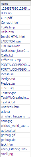

27.5.3.2 Displaying the Name Attribute As a Go Link
In this section, you will convert the Name attribute of the table that you created in Section 27.5.3.1, "Displaying Files and Folders in Read-Only Format" into a link using an ADF Go Link component. You will also configure the table to show only the Name column.
To display the Name attribute as a Go Link:
  1. In the Structure window (Figure 27-21), expand the first column of the table (af:column - Name) to show the default display format af:outputText - #{row.name}.
    Figure 27-21 Default Formatting for the Name Column
    Default Formatting for Name Column
    Description of "Figure 27-21 Default Formatting for the Name Column"
  2. In the source view for the page, change the name column to use a go link. The link displays the name but links to the URI of the entry:
    Replace the af:outputText in bold
    <af:column sortProperty="name" sortable="false"
          headerText="#{bindings.Return.hints.name.label}" id="c2">
       <af:outputText value="#{row.name}" id="ot1"/>
    </af:column>
    with an af:goLink as shown in bold:
         id="c2">
      <af:goLink text="#{row.name}" id="goLink2"
         destination="#{row.bindings.URI.inputValue}"/>
    </af:column>
  3. In the Structure window, right-click af:column - URL and select Delete.

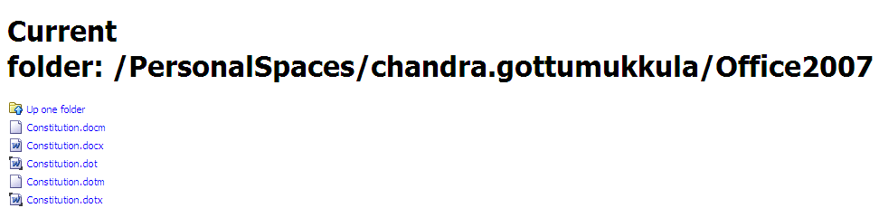

  4. Right-click the page in the Application Navigator and choose Run. You should see a list of hyperlinked file and folder names like the one shown in Figure 27-22. This figure shows the name attribute as a link. Clicking a link in the URI column opens the respective file or folder and shows its contents.
    Figure 27-22 Folder Content Displayed as Hyperlinks
    Description of "Figure 27-22 Folder Content Displayed as Hyperlinks"
  5. Click a file name. The file you pick should appear in a browser window.

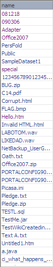

  6. Click the name of a folder, the contents of the folder display, as shown in Figure 27-23.
    Figure 27-23 Folder Contents
    Description of Figure 27-23 follows
    Description of "Figure 27-23 Folder Contents"

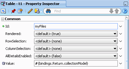

To configure the table to show only the Name column:
  1. In the Structure window, under the af:table - t1 node, delete all but the Name column.
  2. Double-click the af:table - t1 node to display the Property Inspector.
  3. Under the Common tab, in the Id field, enter a name, for example myFiles, as shown in Figure 27-24.
    Figure 27-24 Table Properties - Common Tab
    Table Properties
    Description of "Figure 27-24 Table Properties - Common Tab"
  4. Run the page to view the output. Figure 27-25 shows only one column of the table since other rows were removed from the Structure window at design time. This table shows both files and folders, because you left the type parameter blank when creating the table.
    Figure 27-25 Files and Folders Displayed in a Single-Column Table

  2. In the Overview tab, double-click getItems under Bindings. The Edit Action Binding dialog displays.
  3. The type options are nt:file and nt:folder. To specify the display of only files, enter nt:file under the Value column, as shown in Figure 27-26, and click OK.
  4. Figure 27-26 Display Files Only
    Description of Figure 27-26 follows
    Description of "Figure 27-26 Display Files Only"

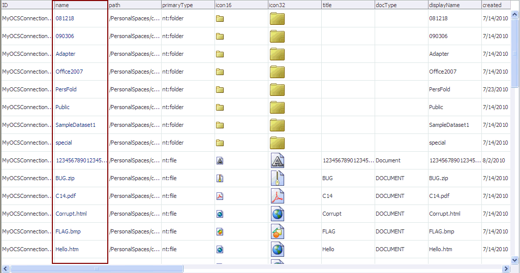

  5. Now run the page. Figure 27-27 shows only files in the single-column table because the column type is nt:file.
    Figure 27-27 Files Displayed in a Single-Column Table

  3. To display your content as an ADF Tree, select the Return node and drag it onto the page. From the Create menu, choose Tree and then ADF Tree, as shown in Figure 27-29.
    Figure 27-29 Oracle JDeveloper Create Menu for getItems
    Description of "Figure 27-29 Oracle JDeveloper Create Menu for getItems"
  4. To create a tree that displays everything under the base path, enter the slash (/) for the path parameter, as shown in Figure 27-30. To modify or delete this path later, click the arrow icon next to the node in the design mode and choose Go to Binding from the context menu.
    Leave the type parameter blank to show both files and folders.
    Figure 27-30 The Edit Action Binding Dialog
    Description of Figure 27-30 follows
    Description of "Figure 27-30 The Edit Action Binding Dialog"

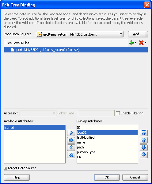

  5. Click OK. The Edit Tree Binding dialog displays.
  6. To show item names, paths, and types at runtime, under Available Attributes, select the desired attributes and move them to the Display Attributes list.
  7. In the Tree Level Rules box, click the Add Rule icon and select Items to create a rule, as shown in Figure 27-31, which enables the tree to find its child items.
    Figure 27-31 Edit Tree Binding

  9. Run your page to display the results.
    When the page appears in your browser window, you should see a list of files and folders available through your data control. Figure 27-33 displays a tree of files and folders in the read-only format based on ADF tree dropped on the JSF page. Expand a branch to see the content in this subdirectory.
    By default, the range size is 10. To change the number of items displayed in the tree, edit the RangeSize property for the data control in the page definition file (namePageDef.xml).

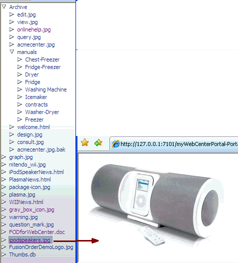

27.5.5.2 Displaying File Names As Hyperlinks

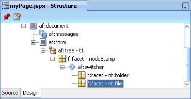

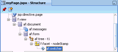

To create hyperlinks to file names and to keep folder names read-only, you need the af:switcher component with two facets: one for folders and one for files.
To use the Switcher component for folders and files:
  1. In the Structure window, navigate to f:facet - nodeStamp and delete af:outputText-#{node}.
  2. Right-click nodeStamp and choose Insert inside f:facet - nodeStamp and then Browse.
  3. In the Insert Item dialog, from the dropdown list for selecting the category, select ADF Faces.
  4. From the Select the item to be created list, select Switcher, and click OK.
    A Switcher is added under f:facet - nodeStamp in the Structure window, as shown in Figure 27-34.
    Figure 27-34 Output Text Converted to a Switcher Component
    Switch Component
    Description of "Figure 27-34 Output Text Converted to a Switcher Component"
  5. Double-click af:switcher to display the Property Inspector, if it is not displayed.
  6. Under the Common tab, in the FacetName field, enter the expression #{node.primaryType}.
  7. In the Structure window, insert two facets for the switcher. Right-click af:switcher, choose Insert Inside af:switcher and then Facet. The Insert Facet dialog displays.
  8. Name the first facet nt:folder and click OK. Folder names require no additional formatting, so you can display the node names as plain text. Name the second facet nt:file. The facets look like Figure 27-35.
    Figure 27-35 Switcher Component with Two Facets
    Switcher Components
    Description of "Figure 27-35 Switcher Component with Two Facets"
  9. Right-click f:facet - nt:folder, choose Insert Inside f:facet - nt:folder and then Browse.
  10. In the Insert Item dialog, choose ADF Faces from the dropdown list.
  11. From the Select the item to be created list select Output Text and click OK.
  12. Double-click af:outputText - outputText1 to display the Property Inspector, if it is not displayed already. Under the Common tab, in the Value field, enter the expression #{node.name}.
  13. Right-click f:facet - nt:file, choose Insert Inside f:facet - nt:folder and then Browse.
  14. In the Insert Item dialog, choose ADF Faces from the dropdown list.
  15. From the Select the item to be created list select Go Link and click OK.
  16. In the Structure window, double-click af:goLink - goLink to display the Property Inspector, if it is not already displayed.
  17. Under the Common tab, in the Text field, enter the #{node.name} expression.
  18. In the Destination field, enter the expression #{node.URI}.
  19. From the TargetFrame list, select _blank.
  20. Run the page. Figure 27-36 displays files names as hyperlinks, because the nt:file facet of the switcher under af:tree was converted to a link (node.URI). Clicking a link displays the respective item.
    Figure 27-36 Tree with File Names as Hyperlinks
    Description of Figure 27-36 follows
    Description of "Figure 27-36 Tree with File Names as Hyperlinks"

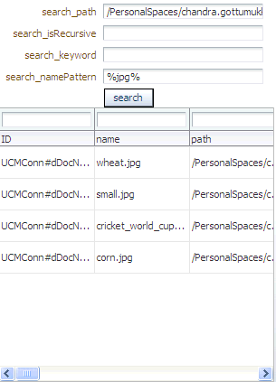

27.5.7.1 Adding Simple Search Capabilities
In this section, you will enable simple search capabilities in your page. This will let you perform wildcard (%) search.
To enable the search function:
  1. In the Application Navigator, double-click your page to open it.
  2. In the Data Controls panel, select the search node.

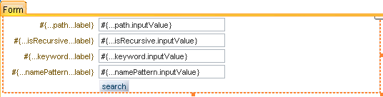

  3. To enable users to perform a search by clicking a button, drag and drop the search node on your page. From the Create menu, choose Parameters and then ADF Parameter Form. The Edit Form Fields dialog displays.
  4. Click OK. The ADF parameter form is added to the page, as shown in Figure 27-37
    Figure 27-37 ADF Parameter Form in the Design View
    Description of Figure 27-37 follows
    Description of "Figure 27-37 ADF Parameter Form in the Design View"
  5. To enable the display of search results in a read-only table, drag and drop the Return node onto the page. From the Create menu, choose Table and then ADF Read-Only Table. The Edit Table Columns dialog displays.
  6. Click OK. A table similar to Figure 27-38 displays.
    Figure 27-38 Table with Four Columns - search
    Description of Figure 27-38 follows
    Description of "Figure 27-38 Table with Four Columns - search"

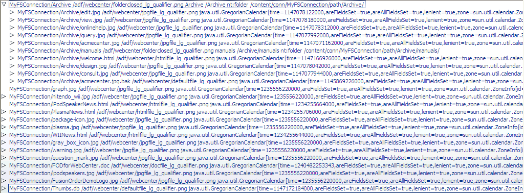

  7. Run this page and specify / for search_path and %jpg% for namePattern. All .jpg files stored in the root of your repository display, as shown in Figure 27-39.
    Figure 27-39 Search Results for .jpg Files
    Description of Figure 27-39 follows
    Description of "Figure 27-39 Search Results for .jpg Files"
27.5.7.2 Adding Advanced Search Capabilities
In this section, you will add advanced search capabilities to your page that will enable you to perform search based on the last modified dates of items located in your file system repository.
To enable the advanced search function:
  1. In the Application Navigator, open your page in which you intend to create the advanced search function. The page must be automatically exposed in new managed bean, where name=advancedSearch, class=AdvancedSearch, package=view. (In the Create JSF Page dialog > Page Implementation > Automatically Expose UI Components in a New Managed Bean)
    In this example the page is called advancedSearch.jspx.
  2. Double-click the page to open it.
  3. In the Component Palette, select ADF Faces.
  4. From the list of ADF Faces - Layout components, drag Panel Form Layout onto the page.
  5. From the Component Palette, drag Input Date into the Panel Form Layout.
  6. In the Property Inspector, under the Common tab, set the Label to Modified after.
  7. In the Application Navigator, under portal.backing, double-click AdvancedSearch.java to open it.
  8. Add the following import declarations. These declarations are required for the getPredicates method, which will be added in the next step.
    import java.util.ArrayList;
    import java.util.Calendar;
    import java.util.Date;
    import java.util.List;
    import oracle.vcr.datacontrol.search.Predicate;
    import oracle.vcr.datacontrol.search.Operator;
  9. Add the following method to enable the advanced search based on last modified dates of the items stored in the repository:
    public List<Predicate> getPredicates() {
            ArrayList<Predicate> predicates = new ArrayList<Predicate>();
            if (id1.getValue() != null && !id1.getValue().equals(""))
                Calendar cal = Calendar.getInstance();
                cal.setTime((Date)id1.getValue());
                predicates.add(new Predicate("jcr:content/jcr:lastModified"
                                             , Operator.GREATER_THAN
                                             , cal));
            // ... other predicates
            if (predicates.size()>0)
                return predicates;
            return null;
  10. From the Data Controls panel, drag the advancedSearch node onto the page. From the Create menu, choose Methods and then ADF Button. The Edit Action Binding dialog displays.
  11. For Path, specify the path to the directory in which the search will be performed; for example, /. For isRecursive specify true, and matchAny specify false.

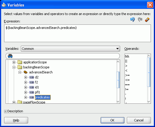

  12. For predicates, select the arrow next to the Value field and then select Show El Expression Builder. The Variables dialog displays.
  13. Expand ADF Managed Beans, backingBeanScope, advancedSearch and select predicates. This adds the expression ${backingBeanScope.advancedSearch.predicates}, as shown in Figure 27-40, and click OK.
    Figure 27-40 Variables Dialog - predicates
    Description of Figure 27-40 follows
    Description of "Figure 27-40 Variables Dialog - predicates"
  14. Click OK in the Edit Action Binding dialog.
  15. In the Data Controls panel, expand the advancedSearch node. Then drag Return and drop it onto the page, after the advancedSearch ADF button. From the Create menu, choose Table and then ADF Read-only Table.
  16. In the Edit Table Columns dialog, edit labels of the columns, if needed. Then click OK. The Design view looks like Figure 27-41.
    Figure 27-41 Advanced Search - Design View
    Description of Figure 27-41 follows
    Description of "Figure 27-41 Advanced Search - Design View"
  17. In the Property Inspector, under the Behavior tab, set the ContentDelivery property to immediate.
  18. To view the page in a browser, under the Application Navigator, right-click the page and choose Run. The advancedSearch page displays in the browser.
  19. Enter a last modified date and click the advancedSearch button. The files modified after that date are displayed, as shown in Figure 27-42.
    Figure 27-42 Advanced Search Results
    Description of Figure 27-42 follows
    Description of "Figure 27-42 Advanced Search Results"
