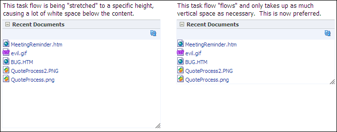

To avoid unnecessary white spaces in your task flows, you must ensure that the task flow content flows and is not stretched by the task flow container. A stretching task flow is one that is stretched to the height of the container, whereas a flowing task flow is one whose height is determined by its content, rather than by a stretching container or by itself having a fixed height. A flowing task flow with a small amount of data is shorter than one with large amounts of data, as shown in Figure D-1.
Figure D-1 Difference Between a Task Flow that Stretches and One that Flows
To design a flowing task flow, you must ensure that:
The child component of the task flow does not have a fixed height.
The Show Detail Frame component surrounding the task flow region does not have a fixed height (specified using its contentStyle attribute).

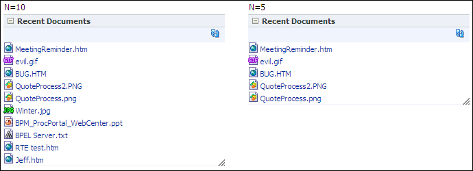

Figure D-2 shows the difference between two task flows containing tables with equal autoHeightRows and fetchSize values of 10 and 5. The task flows wrap to the number of records displayed.

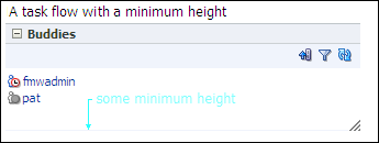

You can ensure that the task flow wraps to the height of the content by adhering to the first guideline, described in Section D.1.1, "Guideline 1: Create Task Flows that Flow."
To prevent the task flow from collapsing completely when there are no records, or seeming too short when there are only one or two records, specify a minimum height for the content.
For example, if your task flow contains a table with an autoHeightRows value specified, you can specify a min-height value using the table's inlineStyle attribute.
Figure D-3 shows a task flow displayed with a reasonable height even though it has only two rows.

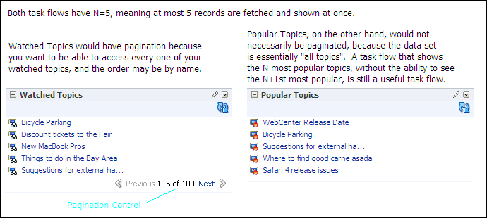

If a task flow is showing ten records, but the data source contains 100 records, you can design the task flow to do one of the following depending on the nature of data in the task flow:
Display only ten records.
For example, a Popular Discussion Topics task flow may use this first option if it is considered sufficient to show the ten most popular topics and not necessary to let users see even the eleventh most popular topic.
Show a More link at the bottom of the task flow that opens a view with the ability to show more records.
For example, the People Connections task flow on a WebCenter Spaces page displays a More link at the bottom.
Show a pagination control with Previous and Next links.
For example, a Watched Discussion Topics task flow may display pagination controls, as users typically want to see all of their watched topics. Pagination is a common choice for task flows in which the data is not inherently ranked in order of importance or can be sorted in different ways, and where it is important to be able to access any record in the data set. The pagination control can be placed either above or below the content, depending on the nature of the content.
Figure D-4 shows the Watched Topics and Popular Topics task flows containing tables having a fetchSize of 5 but both having more than five records in the data source. The Watched Topics task flow displays five records with pagination at the bottom, but the Popular Topics task flow displays only five records with no UI option to view other records.

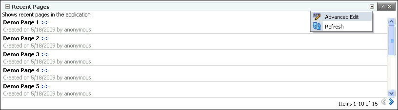

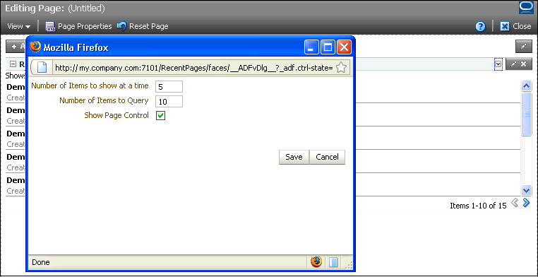

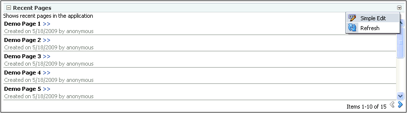

Users with Edit or Customize permission can access customization options from the chrome surrounding the task flow.
You must adhere to the following guidelines while implementing customization in your task flow:
Customization options must be a subset of the task flow's parameters.
Implement a view fragment within the task flow and expose an outcome to open this view in a separate dialog. For example, the control flow rule to invoke a view called advancedEditPopupView in a dialog is as follows:
<control-flow-case> <from-outcome>dialog:advancedEditPopup</from-outcome> <to-activity-id>advancedEditPopupView</to-activity-id> </control-flow-case>
Adhering to this guideline is mandatory for new task flows.
Implement a view fragment within the task flow and expose an outcome to transition inline to this view. For example, the control flow rule to invoke a view called advancedEditView within the same screen is as follows:
<control-flow-case> <from-outcome>advancedEdit</from-outcome> <to-activity-id>advancedEditView</to-activity-id> </control-flow-case>
Although you can implement a task flow in this way, it is recommended that you expose an outcome to open the view in a dialog.
Ensure that customizations are saved in the MDS level set up by the application. Unlike task flow parameters, which are stored in the task flow definition itself, customizations are saved in the Metadata Storage (MDS). If you do not explicitly specify the MDS layer to be used to save task flow customizations, customization metadata and the consuming application metadata may get stored in different layers.
To ensure that customizations are saved to the same layer as application metadata, you must clone the application's MDS session in the task flow's preference file and reference that while configuring customization. For an example of how this is implemented, see Section D.3, "Example of a WebCenter Application Containing a Task Flow Created By Following the Guidelines."

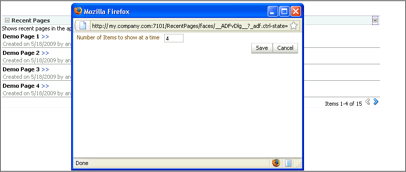

All users viewing the page can access personalization options from the chrome surrounding the task flow in View mode of the page.
You must adhere to the following guidelines while implementing personalization in your task flow:
Ensure that personalization options are a subset of the customization options you define on the task flow.

Implement a view fragment within the task flow, and expose an outcome to open this view in a dialog. For example, the control flow rule to invoke a view called simpleEditPopupView in a dialog is as follows:
<control-flow-case> <from-outcome>dialog:simpleEditPopup</from-outcome> <to-activity-id>simpleEditPopupView</to-activity-id> </control-flow-case>

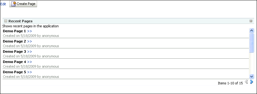

As a companion to this document, a sample application was developed using Oracle WebCenter Framework. This sample application, called RecentPages, is used as an example to illustrate how you can build a near-perfect task flow by adhering to the guidelines in this document. The RecentPages application contains a customizable page, Welcome.jspx, which contains a task flow named recent-pages-taskflow-definition created by following all the required guidelines.
This section only provides a high-level description of how the task flow was implemented. For detailed information about using task flows and Oracle Composer, see the following guides:

Figure D-5 displays a list of recently created pages in the application. At runtime, the list looks like this:
The design features of this view fragment are as follows:
The autoHeightRows attribute is defined on the table to control the number of items displayed in the table. The task flow then wraps to the height of the items displayed.
The fetchSize attribute is defined to control the number of items to be fetched from the data source and displayed in the table.
Pagination controls are included to display a message in the format "Items 1-4 of 25" along with previous and next icons.

Figure D-6 displays an option to select the number of items to be displayed in the task flow. All users viewing the page can personalize the task flow using this option. The value specified by a user is applicable only for that user's view of the page.
The following table describes significant sections of code in the simpleEditPopupView.jspx page.
Table D-4 Code in the Personalization Page
| Code | Description |
<af:panelStretchLayout id="psl1">
<f:facet name="center">
<af:group id="group1">
<af:panelFormLayout id="pfl1">
<af:inputText label="Number of Items to show at a time"
id="it1"
value="#{pageFlowScope.recentPagesBean.number_of_items_to_show_at_a_time}"
columns="3"/>
</af:panelFormLayout>
<af:panelGroupLayout id="pgl2"
layout="horizontal"
halign="right"
inlineStyle="width:500px;">
<af:commandButton text="Save" id="cb1"
action="#{pageFlowScope.recentPagesBean.saveSettings}"/>
<af:commandButton text="Cancel" id="cb2"
action="cancel"
actionListener="#{pageFlowScope.recentPagesBean.cancel}"/>
</af:panelGroupLayout>
</af:group>
</f:facet>
</af:panelStretchLayout>
A single top-level The The |
This page displays customization options to users with Edit or Customize permission. At runtime, this page opens in a separate dialog and displays options to select the number of items to be displayed and number of items to be queried, and a check box to show or hide pagination controls.
The following table describes significant sections of code in the advancedPopupView.jspx page.
Table D-5 Code in the Customization Page
id="it1"
columns="3"/>
<af:inputText label="Number of Items to Query" id="it2"
value="#{pageFlowScope.recentPagesBean.number_of_items_to_query}"
columns="3"/>
<af:selectBooleanCheckbox label="Show Page Control"
id="sbc1"
value="#{pageFlowScope.recentPagesBean.showPageControl}"/>
layout="horizontal"
halign="right"
action="cancel"
</af:group>
</f:facet>

public void previous(ActionEvent actionEvent)
int page_num = getPageNumber();
page_num--;
if (page_num <= 0)
page_num = 1;
RequestContext.getCurrentInstance().getPageFlowScope().put("page_num", page_num);
Logic to define behavior of Previous action in the task flow's pagination control. |
public void next(ActionEvent actionEvent)
page_num++;
String items_to_query =
this.getNumber_of_items_to_query();
int offset = Integer.parseInt(items_to_query);
int total_page_num = getTotalPageNumber();
if (page_num > total_page_num)
page_num = this.getTableSize()
/ offset;
Logic to define behavior of Next action in the task flow's pagination control. |
public boolean isShowPrevious()
if (page_num <= 1)
return false;
else
return true;
Logic to render Previous icon |
public boolean isShowNext()
if (page_num >= getTotalPageNumber())
return false;
else
return true;
Logic to render Next icon. |
public int getTotalPageNumber()
int total_page_num = this.getTableSize()
/ offset;
if (getTableSize() % offset > 0)
total_page_num++;
return total_page_num;
Logic to return the total number of pages. |
public String getFooterText()
return "Items " + (this.getStart() + 1) + "-" + this.getEnd() +
" of " + " " + this.getTableSize() + " ";
Logic for returning pagination text in the format |

At runtime, the page appears as shown in Figure D-7.
You can add a task flow inside a Show Detail Frame component and display the task flow's outcomes as actions on the chrome of the parent Show Detail Frame component. This is possible by defining custom actions on the parent Show Detail Frame component. You can define custom actions at the instance level where Custom Action components are added as child components of the Show Detail Frame, or at the global level where Custom Action elements are defined in the application's adf-config.xml file. Global custom actions are enabled on all Show Detail Frame instances in the application, but are displayed only when a Show Detail Frame instance contains the task flow as its child.
In this application, custom actions corresponding to the task flow's outcomes, dialog:simpleEditPopupView and dialog:advancedEditPopupView, are defined globally in the adf-config.xml file as follows:
<customizableComponentsSecurity xmlns="http://xmlns.oracle.com/adf/faces/customizable/config">
<enableSecurity value="true"/>
<customActions>
<customAction action="refresh" text="Refresh"
shortDesc="Refresh"
location="menu" rendered="true"
icon="/adf/pe/images/refresh_ena.png"/>
<customAction action="dialog:simpleEditPoup"
text="Simple Edit"
shortDesc="Simple Edit"
location="menu"
rendered="#{!changeModeBean.inEditMode}"
icon="/adf/pe/images/editproperties_ena.png"/>
<customAction action="dialog:advancedEditPopup"
text="Advanced Edit"
shortDesc="Advanced Edit" location="menu"
rendered="#{changeModeBean.inEditMode}"
</customActions>
</customizableComponentsSecurity>
This configuration results in the following behavior at runtime:
All users see a Simple Edit action on the chrome surrounding the task flow while viewing the page.
Clicking this action displays the personalization option in a separate dialog.
Users with Edit or Customize permission see an Advanced Edit action on the chrome surrounding the task flow while editing the page.
Clicking this action displays customization options in a separate dialog.
