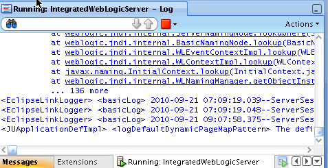

Use the DefaultServer Log window (shown in Figure 68-2) to view how the activity is progressing.

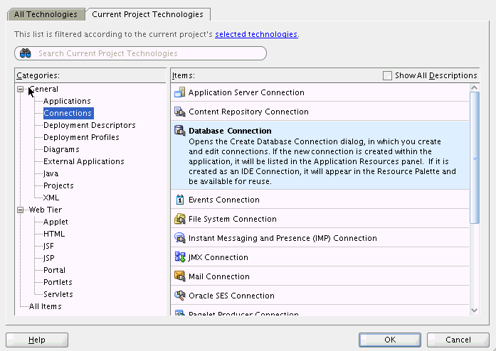

From the File menu, select New.
From the Connections category, select Database Connection and click OK.

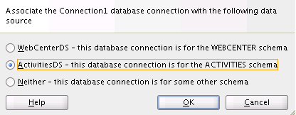

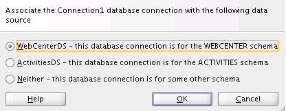

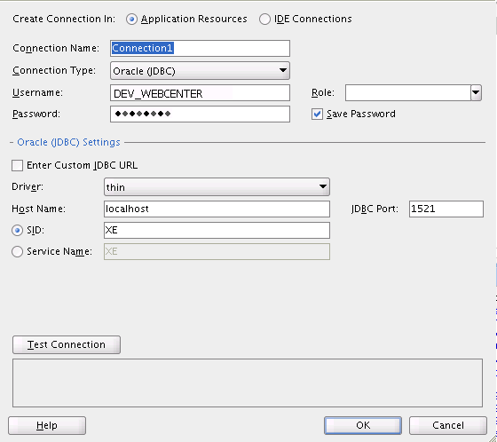

Enter the connection details for the connection to the Activities schema and click OK.
Associate the connection with the ActivitiesDS data source as shown in Figure 68-3 and click OK .
Figure 68-3 Associate to Data Source Dialog - Activities Schema

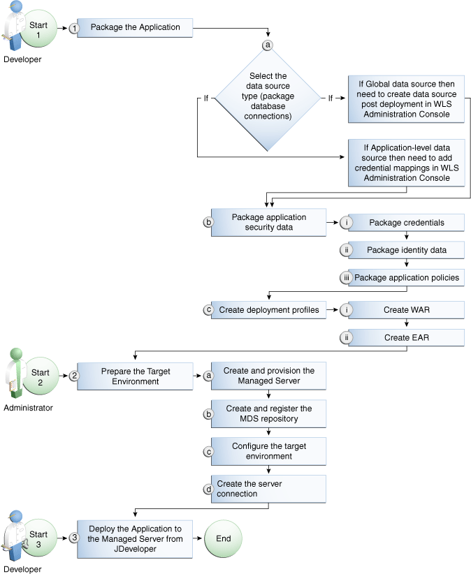

The flow chart and table in this section provide an overview of the prerequisites and tasks required to deploy a WebCenter Portal application to an Oracle WebLogic Managed Server. Figure 68-4 shows the steps to deploy a WebCenter Portal application, and the roles that will carry them out.
Figure 68-4 Deploying a WebCenter Portal Application to a Managed Server
Table 68-1 shows the tasks, sub-tasks and who will need to carry them out to deploy a WebCenter portal application from JDeveloper.
Table 68-1 Deploying a WebCenter Portal Application to a Managed Server
| Actor | Task | Sub-task | Notes |
Developer |
1. Package the Application |
1.a Select the data source type (package database connections) |
You can use either a global data source or an application-level data source. If using a global data source, then you need to create the data source in the WLS Administration Console before deploying. If using an application-level data source, then you may need to add credential mappings using the WLS Administration Console after deploying (see the note below). Note: There are two options for deploying from JDeveloper. You can deploy directly to the Managed Server, or you can deploy to an EAR file and then deploy the EAR file using either Fusion Middleware Control, WLST or the WLS Admin Console. If you deploy directly from JDeveloper the credential mapping step is not required as JDeveloper automatically handles the credential mapping. However, if you deploy the EAR file outside of JDeveloper, then this step is required. |
1.b Package application security data |
This sub-task consists of packaging the credentials, identity data, and application policies. |
1.c Create deployment profiles |
This sub-task consists of creating the WAR and EAR files. |
Administrator |
2. Prepare the Target Environment |
2.a Create and provision the Managed Server |
2.b Create and register the MDS repository |
2.c Configure the target environment |
2.d Create the server connection |
Developer |
3. Deploy the Application to a Managed Server from JDeveloper |
The final step is to deploy the application to the Managed Server from JDeveloper. |

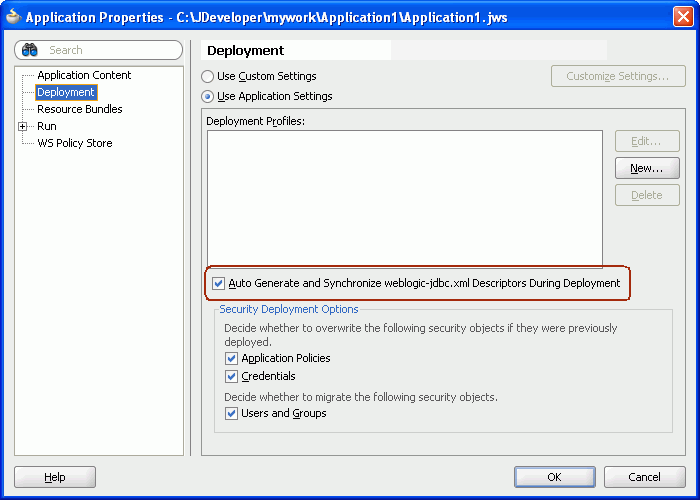

To choose a global data source, deselect the Auto Generate and Synchronize weblogic-jdbc.xml Descriptors During Deployment checkbox when you create the EAR file so that JDeveloper does not create an application-level data source with password indirection. Instead, create the global data source using Oracle WebLogic Administration Console prior to or after deploying the application to a Managed Server in production mode using the default WebCenter and Activities schemas. For more information on creating global data sources, see the section "Creating a JDBC Data Source" in Oracle Fusion Middleware Configuring and Managing JDBC Data Sources for Oracle WebLogic Server.
Application-level data source with password indirection:
JDeveloper generates an application-level data source with password indirection by default when you run an application on the Integrated WLS. That is, when the Auto Generate and Synchronize weblogic-jdbc.xml Descriptors During Deployment checkbox is selected in the Application Properties dialog, as shown in Figure 68-5.
Figure 68-5 Auto Generate and Synchronize weblogic-jdbc.xml Descriptors During Deployment Checkbox

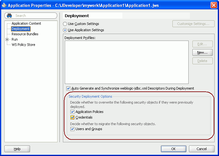

The following is applicable only if you have configured security in your application using the Configure ADF Security wizard, or the application contains connections with secure attributes such as a database connection password or external applications with shared or public credentials:
If you do not intend to migrate credentials, then deselect the Credentials checkbox in the Security Deployment Options section in the Application Properties dialog (see Figure 68-6).
If you retain the default selection in the Security Deployment Options section, then the credential migration will behave as follows, depending on whether the WebLogic domain is in development or production mode:
When you deploy a WebCenter Portal application to a Managed Server running in production mode, secure attributes of the connections packaged within your application and any shared or public credentials specified for external applications are not migrated to the domain-level credential store. This is because secure properties are likely to be different between development and production environments. Therefore, you must reconfigure secure attributes of connections and shared or public credentials for external applications using WLST commands or Fusion Middleware Control, as described in the Oracle Fusion Middleware Administrator's Guide for Oracle WebCenter.
For more information on credential migration behavior, see the section "Configuring the Credential Store" in Oracle Containers for J2EE Security Guide.
When you deploy a WebCenter Portal application in development mode, you must first enable credential migration. To enable credential migration for an application to be deployed in development mode, start the Managed Server with -Djps.app.credential.overwrite.allowed=true, by adding the following option to the setDomainEnv.cmd or setDomainEnv.sh file located in domain\bin:
set EXTRA_JAVA_PROPERTIES=-Djps.app.credential.overwrite.allowed=true %EXTRA_JAVA_PROPERTIES%
In Figure 68-6, in the Security Deployment Options section, the Users and Groups checkbox is selected by default. This indicates that the users and groups defined in the application's jazn-data.xml file will be migrated to the identity store configured for the WebLogic Managed Server, if the authenticator configured in the domain allows creation of users and groups. When migrating the identify store, you should deselect this option as users and groups defined in the identity store configured for the Managed Server should be used to access the application.

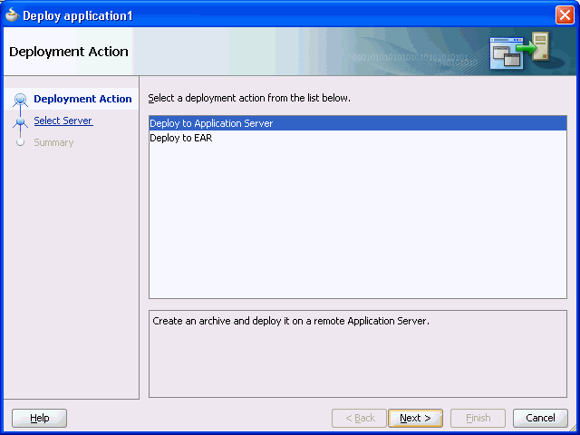

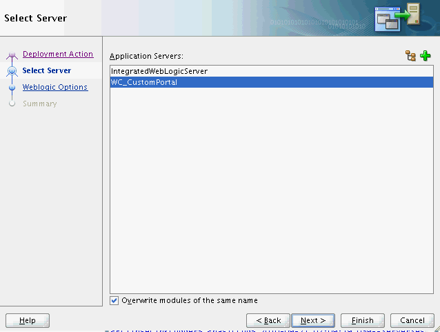

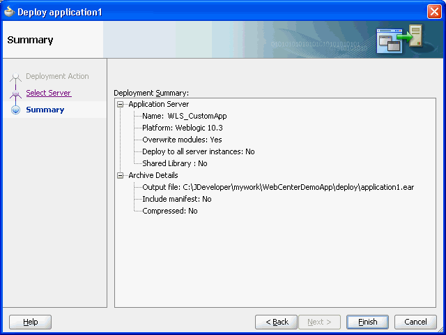

In the Application Navigator, right-click the application name, choose Deploy, deployment profile name, to, and then choose to EAR file. This creates the EAR file in the deploy folder located in JDEV_HOME\mywork\application_name\deploy\, as shown in Figure 68-7.

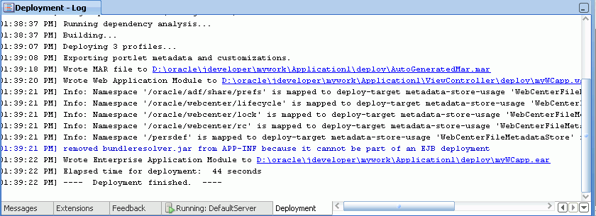

Figure 68-7 EAR Status in Deployment - Log

You can deploy a WebCenter Portal application to a Managed Server using either local application or global data sources. Local application data sources can only be accessed by the deployed application. However, it's an easy way to deploy in that it needs no other data source configuration in order to work if deployed directly from JDeveloper.
Global data sources benefit from being able to be shared by other applications on the server where database connection config updates can be more easily maintained and picked up by all users of the global data source. For more information about data sources, see the section "Choosing the Data Source" in the Oracle Fusion Middleware Administrator's Guide for Oracle WebCenter.
This section contains the following subsections:
Section 68.3.4.1, "Deploying to a Managed Server Using Local Data Sources"
Section 68.3.4.2, "Deploying to a Managed Server Using Global Data Sources"

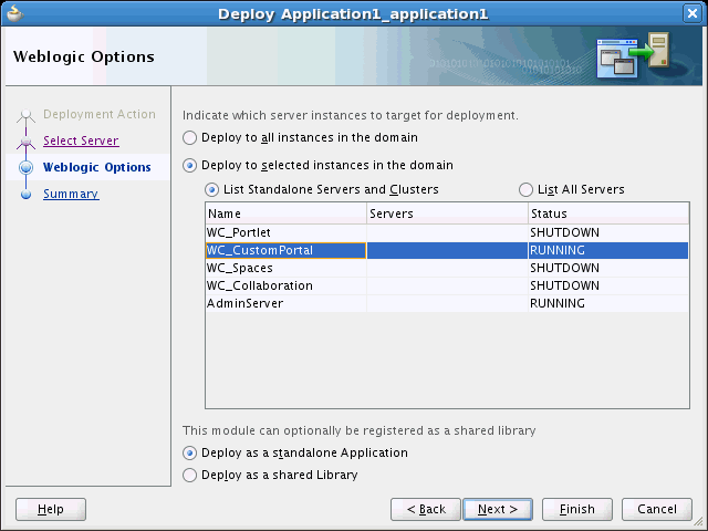

When you deploy to a Managed Server, the application EAR file is generated. The EAR file packages the metadata archive (MAR file), which includes the metadata content to be deployed to an MDS repository. Additionally, the adf-config.xml file is reconfigured with a modified mds-config for the target deployment environment. Application-wide features, security, caching, and change persistence remain unchanged. Properties for other Oracle components, if any, are also configured in this file. Similarly, JSF and JSTL shared libraries are added in the weblogic.xml file during packaging.
The New Gallery appears (see Figure 68-8).
The Create Database Connection Dialog displays (see Figure 68-9).
Enter the connection details for the connection to the WebCenter schema and click OK.

The Associate to Data Source dialog displays (see Figure 68-10).
Figure 68-10 Associate to Data Source Dialog
If there are multiple projects select the project, associate the connection with the WebCenterDS data source and click OK.
Note that the Associate to Data Source dialog can also be invoked from the context menu for a database connection (right-click on a database connection and select Associate to Data Source). This is useful if you change your mind and want to associate the database connection to a different data source, or disassociate it (by selecting Neither).

Associate the connection with the ActivitiesDS data source as shown in Figure 68-11 and click OK .

Right-click the Application menu and select Application Properties...
The Application Properties dialog displays (see Figure 68-12).
Figure 68-12 Application Properties Dialog
Choose Deployment from the navigation panel to display the Deployment options.
Make sure that the Auto Generate and Synchronize weblogic-jdbc.xml Descriptors During Deployment option is selected and click OK.
Right-click on the Application menu, select Deploy and then the application name.
The Deployment Action dialog displays (see Figure 68-13).
Select Deploy to Application Server and click Next.
The Select Server dialog displays (see Figure 68-14).
Select the connection name of the Managed Server (for example, WC_CustomPortal), and click Next. If the server to which you want to deploy is not listed, click the Add icon (+) and complete the connection details to add the application server to the list.
The Deployment WebLogic Options dialog displays (see Figure 68-15).
Figure 68-15 Deployment WebLogic Options dialog
Select Deploy to selected instance in the domain, select the managed server from the list (for example, WC_CustomPortal), and click Next.
In most cases you will want to deselect Deploy to all server instances in the domain and select the specific servers and clusters to deploy to using the Server Instances dialog. Refer to the online help for more information about using the Select Server dialog options.

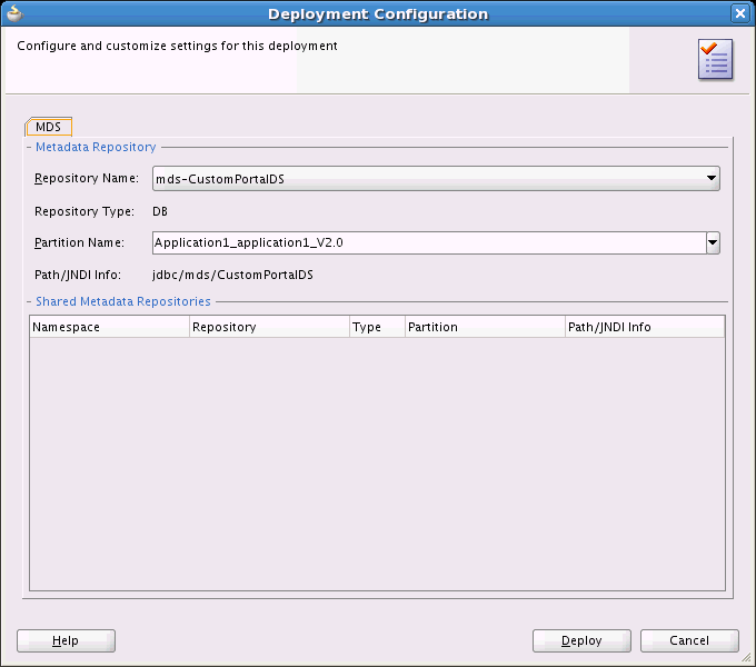

The Deployment Configuration dialog displays (see Figure 68-16).
Figure 68-16 Deployment Configuration Dialog
Select the Repository Name (for example, mds-CustomPortalDS), enter a Partition Name (if the partition doesn't already exist then it will be created during the deployment), and click Deploy.
On the Deployment Summary dialog (see Figure 68-17), check that all of the deployment options are correct and click Finish to start the deployment.
Continue by doing any post-deployment security or data source connection configurations that may be required as described in the section on "Post-Deployment Configuration" in the Oracle Fusion Middleware Administrator's Guide for Oracle WebCenter.
Figure 68-21 Deployment Configuration Dialog
