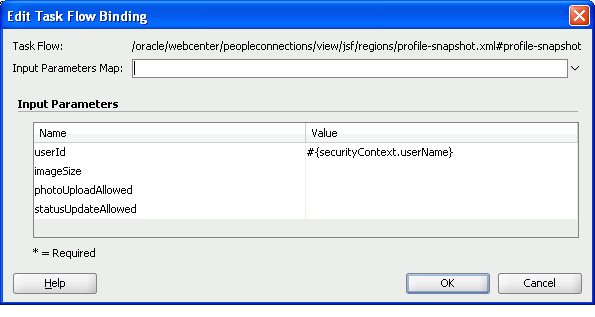

After you have added a task flow to a page, you may want to customize the instance by revising its binding parameter values. This section describes how to access the Edit Task Flow Binding dialog and change binding parameter values.
To access the Edit Task Flow Binding dialog:
Open the application page and set the view to bindings by clicking the Bindings tab at the bottom of the page.
Under Executables, double-click the task flow for which to revise task flow binding parameters (Figure 39-1) to open the Edit Task Flow Binding dialog (Figure 39-2).
Tip: Task flow names under Executables differ from names in design view. For example, Message Board task flows are instead referred to as wall, and Feedback task flows are instead referred to as kudos. |
Figure 39-1 Bindings View of an Application Page
Figure 39-2 Edit Task Flow Binding Dialog
Revise binding parameter values (for more information, see Section 39.2, "People Connections Task Flow Binding Parameters").
Click OK to save your changes and exit the dialog.
Save and run your page to see the results.
