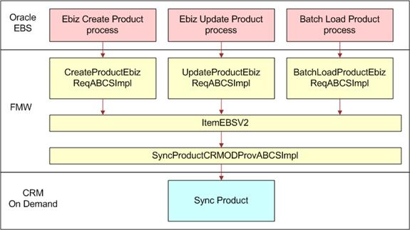

Figure 4-1 illustrates the overall flow for the process integration:

The Synchronize Items integration flow enables the synchronization of items from Oracle E-Business Suite to CRM On Demand. This synchronization is a one-way feed from Oracle E-Business Suite to CRM On Demand. After items are created or updated in Oracle E-Business Suite, a business event is triggered that enables the synchronization of items from Oracle E-Business Suite to CRM On Demand. This flow is used for incremental loads (manual creation of products) or run-time updates. For high-volume product data loads from Oracle E-Business Suite to CRM On Demand, use the Batch Data Load integration flow that is supported by this Process Integration Pack (PIP).

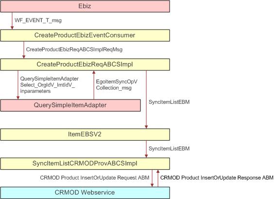

Figure 4-2 illustrates the Create Item integration flow:
When you initiate the process, the following events occur:
The CreateItemEbizEventConsumer listens to business events and receives the WF_EVENT_T_msg event payload for the Create event. The CreateItemEbizEventConsumer is routed to the CreateProductEbizReqABCSImpl with the complete event payload.
The CreateProductEbizReqABCSImpl invokes the ItemEBSV2 with the operation SyncItemList.
As part of the enrichment process, the CreateProductEbizReqABCSImpl queries the EGO_ITEM_SYNC_OP_V view object through the Oracle E-Business Suite adapter QuerySimpleItemAdapter based on event payload to get the EgoItemSyncOpVCollection_msg.
As part of the transformation process, the CreateProductEbizReqABCSImpl transforms the EgoItemSyncOpVCollection_msg message into the SyncItemListEBM. Invoke the ItemEBSV2 with the operation SyncItemList. The ItemEBSV2 is a routing service with several operations on the Item enterprise business message (EBM). In the process, the cross-reference is created by concatenating the inventory item ID, organization ID, and operating unit.
The ItemEBSV2 routes the SyncItemListEBM to the SyncProductCRMODProvABCSImpl.
The SyncItemListCRMODProvABCSImpl transforms the SyncItemListEBM to the CRM On Demand product message and then calls a CRM On Demand product Upsert web service to synchronize the product.
The CRM On Demand web service completes the request and returns a response message. In the process, the cross-reference is linked to the CRM On Demand IDs of the product.

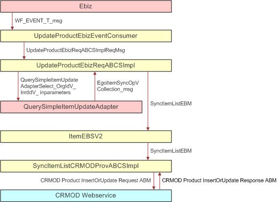

Figure 4-3 illustrates the Update Items integration flow:
The UpdateItemEbizEventConsumer listens to business events and receives the WF_EVENT_T_msg event payload for update event.
The UpdateItemEbizEventConsumer is routed to UpdateProductEbizReqABCSImpl with the complete Event payload.
UpdateProductEbizReqABCSImpl service calls the Enterprise Business Service (EBS) based on the event payload, and then transforms to the SyncItemListEBM and invokes the ItemEBSV2 with operation SyncItemList.
As part of the enrichment process, the UpdateProductEbizReqABCSImpl queries the EGO_ITEM_SYNC_OP_V view object through the Oracle E-Business Suite adapter QuerySimpleItemUpdateAdapter based on the event payload to get the EgoItemSyncOpVCollection_msg.
As part of the transformation process, UpdateProductEbizReqABCSImpl transforms the EgoItemSyncOpVCollection_msg message into the SyncItemListEBM.
ItemEBSV2 with the operation SyncItemList is invoked. ItemEBSV2 is a routing Mediator Component service with several operations on the Item EBM.
ItemEBSV2 routes the SyncItemListEBM to SyncItemListCRMODProvABCSImpl.
SyncItemListCRMODProvABCSImpl transforms SyncItemListEBM to the CRM On Demand Product message and then calls the CRM On Demand product Upsert web service to synchronize the product.
The CRM On Demand web service completes the request and returns a response message. In the process, the cross-reference is linked with the CRM On Demand IDs of the product.
