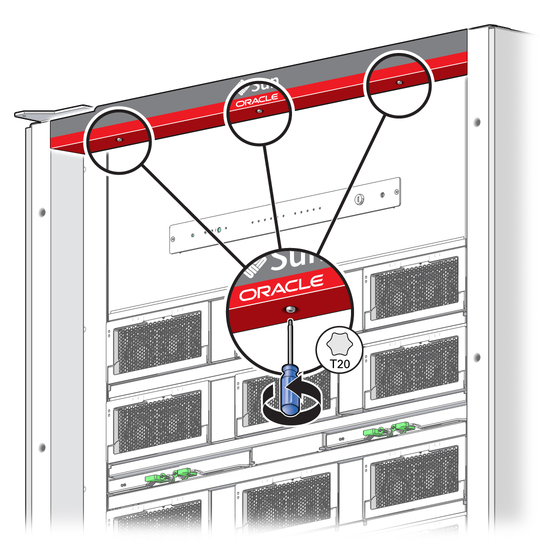

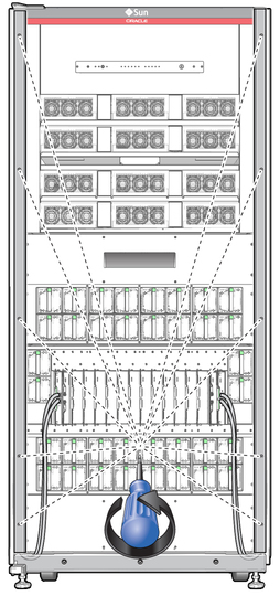

Loosen five captive T20 Torx screws on each side trim panel.

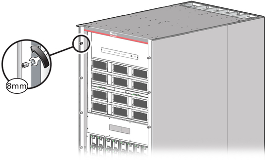

Use an 8-mm wrench.
If you are removing and installing the power system cage, remove the standoffs nearest the cage. There are three on each side of this cage.
If you are removing and installing a fan cage, remove the standoffs at the sides of the cage.
