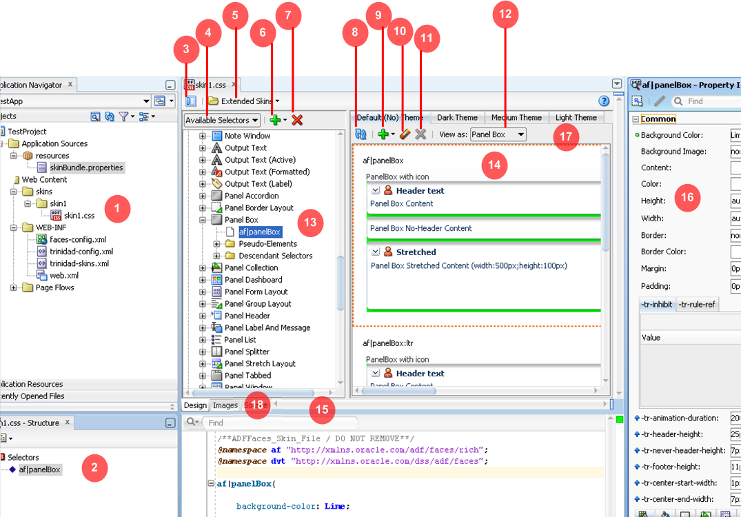

The ADF Skin Editor provides a range of features that facilitate the creation and modification of ADF skins. The following list, for which each item has a corresponding label number in Figure 3-2, describes the individual features that the editor exposes when you create an ADF skin, as described Section 4.4, "Creating an ADF Skin File":
  1. The Projects node in the Application Navigator contains a node named skins where the source files for the ADF skins that you create are stored. The skins node is not created until after you create the first ADF skin, as described in Chapter 4, "Creating the Source Files for an ADF Skin."
  2. The Structure window lists the selectors, global selector aliases, and style classes that you add to the ADF skin file.
    For more information, see Chapter 2, "Working with ADF Skin Selectors."
  3. Click the Hide/Show Divider icon to hide or show the Selector Tree.
  4. Filter the selectors that appear in the Selector Tree to display all selectors (Available Selectors) or only those that you modified in the ADF skin (Updated Selectors).
  5. The Extended Skins list displays the list of ADF skins from which the current ADF skin extends.
    For more information, see Section 3.4, "Navigating to the ADF Skins That Your ADF Skin Extends."
  6. Use the Add icon to create a new style class or alias selector.
    For more information about creating a new style class, see Chapter 9, "Working with Style Classes." For information about creating an alias selector, see Chapter 8, "Working With Global Selector Aliases."
  7. Use the Delete icon to remove a selector that you added to the ADF skin.
  8. Click the Refresh icon to update the Preview Pane after you make changes to the properties of a selector in the Property Inspector.
  9. Click the Add Pseudo-Class icon to apply a pseudo-class to the item that you selected in the Selector Tree.
    For more information about pseudo-classes, see Section 2.2, "Pseudo-Classes in the ADF Skinning Framework."
  10. Click the Clear Property Settings icon to undo any change that you made to the item selected in the Selector Tree.
  11. Click the Delete Pseudo-Class from Skin File icon to delete any pseudo-classes that you specified in the ADF Skin.

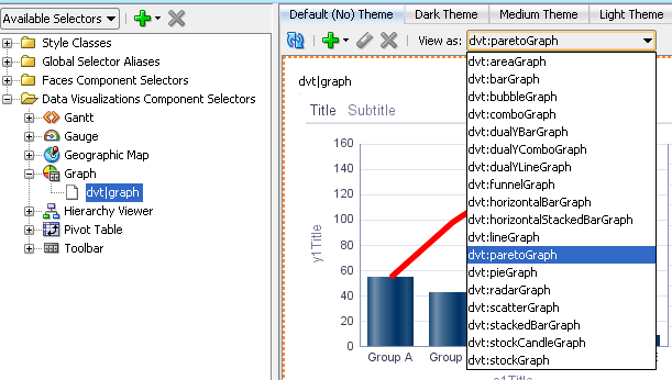

  12. The View as list allows you to preview how changes you make to a global selector alias in the Selector Tree affect the components that reference the global selector alias. The View as list displays all components that reference the global selector alias. The View as list also allows you to preview how changes you make to the properties of one component-specific selector impact all sub-types of that component. For example, Figure 3-1 shows the ADF Data Visualization component selector for the graph component (af|dvt-graph) that exposes a single set of component-specific selectors that apply changes to all graph types. Use the View as list to preview a change that you make to a selector in one of the other types of graph (for example, Bar, Funnel, Pareto, and so on).
    Figure 3-1 View as List for a Component
    For more information about global selector aliases, Chapter 8, "Working With Global Selector Aliases."
  13. The Selector Tree displays the list of selectors, global selector aliases, and style classes that you can configure values for in an ADF skin.
    For more information, see Section 3.2, "Working with the Selector Tree.".
  14. The Preview Pane renders a preview of the changes that you make to a selector in an ADF skin after you click the Refresh icon (8).
  15. You can also view the source of an ADF skin file.
    Tip:
    Select Split Document from a context menu that you can invoke from the Preview Pane to render the source and design views of an ADF skin side by side.
  16. The Property Inspector identifies properties that you can configure for the ADF skin.
    For more information, see Section 3.3, "Working with the Property Inspector."
  17. The tabs for themes allow you to preview changes that you make for supported themes.
    For more information, see Section 5.6, "Applying Themes to ADF Faces Components."
  18. The Images window helps you manage the images that you want to use with an ADF skin.
    For more information, see Section 6.3, "Working with the Images Window."
Figure 3-2 Overview of the ADF Skin Editor

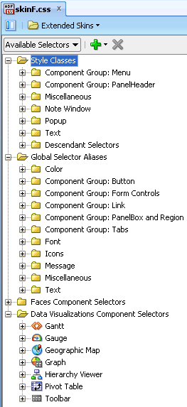

3.2 Working with the Selector Tree
The Selector Tree displays a list of the style classes, global selector aliases, and selectors for which you can configure properties to change the appearance of ADF Faces and ADF Data Visualization components.
Figure 3-3 shows the nodes that the Selector Tree exposes:
  • Style Classes
    A style class defines one or more style properties that you can apply to specific instances of a component. The Selector Tree categorizes the inherited style classes into style classes defined for general usage, note windows, and popups. For more information, see Chapter 9, "Working with Style Classes."
  • Global Selector Aliases
    A global selector alias defines style properties that you apply to one or more selectors. The Selector Tree categorizes the inherited global selector aliases into selector aliases defined for general usage, icons, and messages. For more information, see Chapter 8, "Working With Global Selector Aliases."
  • Grouped Selectors
    Identifies style properties grouped into one declaration to apply to more than one selector. For example, Figure 3-3 shows a grouped selector for the commandImageLink and goImageLink component's selectors.
  • Faces Component Selector
    Selectors identify the ADF Faces components for which you can configure properties. The Selector Tree displays subcategories for pseudo-elements, component selector aliases, and descendant selectors. For brevity, the ADF Faces components node is not expanded. For more information, see Chapter 5, "Working with Component-Specific Selectors."
  • Data Visualizations Component Selectors
    Selectors identify the ADF Data Visualization components for which you can configure properties. The Selector Tree displays subcategories for pseudo-elements, component selector aliases, and descendant selectors. For more information, see Chapter 5, "Working with Component-Specific Selectors."
Figure 3-3 Selector Tree

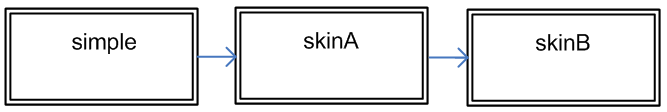

3.4 Navigating to the ADF Skins That Your ADF Skin Extends
When you create an ADF skin, as described in Section 4.4, "Creating an ADF Skin File," you choose an ADF skin from which to extend. The ADF skin that you choose to extend from defines properties that your newly created ADF skin inherits. When you create your first ADF skin, you must choose one of the ADF skins that Oracle ADF provides.
Subsequent ADF skins that you create can extend an ADF skin that you created or one of the ADF skins provided by Oracle ADF. For example, you create your first ADF skin named skinA that extends the simple ADF skin provided by Oracle ADF. You then create a second ADF skin named skinB. When creating skinB, you have the choice of extending from skinA or from any of the ADF skins provided by Oracle ADF. If you choose to extend skinB from skinA, the inheritance relationship between the ADF skins is as illustrated in Figure 3-5.
For more information about the ADF skins that Oracle ADF provides, see Section 1.4, "Inheritance Relationship of the ADF Skins Provided by Oracle ADF," and Section 11.4, "ADF Skins Provided by Oracle ADF."
Figure 3-5 Example Inheritance Relationship Between ADF Skins
The Extended Skins list in the visual editor displays the list of ADF skins that the current ADF skin extends. Figure 3-6 shows the list of ADF skins that appears if you implement the inheritance relationship described in Figure 3-5. You open an extended ADF skin that you want to view by clicking it in the Extended Skins list.

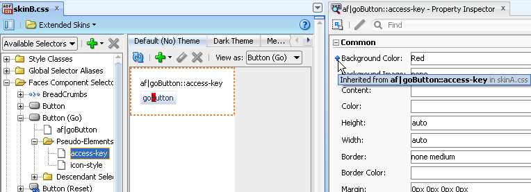

You cannot edit the properties of the selectors in the ADF skins provided by Oracle ADF. You can only edit the properties of selectors in extended ADF skins that you created.

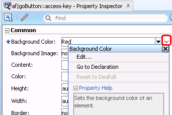

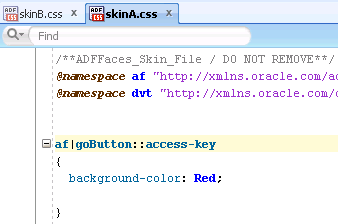

Using the Go to Declaration menu that the Property Inspector exposes, you can navigate to the location in an extended ADF skin where the extended ADF skin declares style properties inherited by other ADF skins. For example, assume that the skinA ADF skin defines a background color of Red for the af|goButton selector's access-key pseudo-element, as shown in Figure 3-4.
Figure 3-7 Declaration of a Property Value
The skinB ADF skin that extends from skinA ADF skin inherits the property values, as shown in Figure 3-4.
Figure 3-8 Inheriting a Property Value from an Extended Skin
To go to the declaration of a property:
  1. Identify a property in your ADF skin that inherits its values from an extended ADF skin. A blue upward-pointing arrow, as shown in Figure 3-8, identifies these properties.
  2. Click the list beside this property to invoke a context menu where you select Go to Declaration, as shown in Figure 3-9.
    Figure 3-9 Go to Declaration Context Menu
The extended ADF skin opens in the source view, as shown in Figure 3-10. If the extended ADF skin is one that you created, you can modify the property values defined in it. The ADF skins provided by Oracle ADF, described in Section 11.4, "ADF Skins Provided by Oracle ADF," are read-only.
Figure 3-10 Property Value Defined in Extended ADF Skin
Property Value Definded in Extended ADF Skin

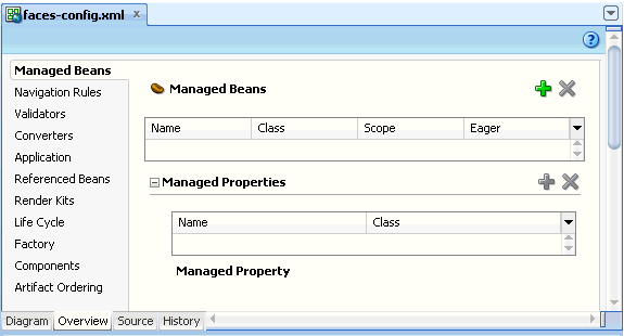

3.8 Working with the Overview Editor in the ADF Skin Editor
Although the ADF Skin Editor creates the faces-config.xml file by default when you create a new ADF skin project, this file is not required for ADF skin projects. In the unlikely event that you need to edit the faces-config.xml file, you can use the overview editor for JSF configuration files. Figure 3-11 displays the overview editor.
Figure 3-11 Overview Editor for JSF Configuration File
When you open faces-config.xml its contents are displayed in an editor group. When you select the Overview tab at the bottom of this group, the overview editor appears.
When the overview editor is open, the Property Inspector displays the metadata child elements for the currently selected element. Use the Property Inspector to manage these. For instance, you use the Property Inspector to set the <description> and <display-name> child elements.
The overview editor has three sections:
  • The left-hand column displays the main JSF configuration elements.

3.8.1 How to Use the Overview Editor for JSF Configuration Files in the ADF Skin Editor
You can add, delete, or edit your JSF element and child elements using the Overview Editor.
To work with a main JSF configuration element and its immediate child elements:
  1. In Application Navigator, open the workspace that contains your JSF application.
  2. In the workspace, open the project that contains your JSF pages.
  3. In the project, open the WEB-INF node.
  4. Under the WEB-INF node, double-click the faces-config.xml file to open.
  5. At the bottom of the editor, select the Overview tab.
  6. Select an element from the element list on the left. The main panel displays corresponding configurable child elements in a table at the top of the main panel.
To add, delete, or edit JSF configuration elements:
  • To add a new child element. Click New. A dialog box opens to create the element. If no new button displays, the child element must be an existing class. You can select the class by clicking Browse... . If no browse button appears, or if the entry is not a class name, you can enter a value directly.
  • To delete an existing child element. Select the element from the table and click Delete. The element is removed from the table. If no delete button displays, the entry can be deleted manually.
  • To edit an existing child element. Select the element from the table and click Edit. The Properties panel for the element opens to change the value.
To view, add, delete, or edit child configuration element child element:
  • To view child elements. Select an element from the element list on the left. The main panel displays. Select an existing child element from a table at the top of the main panel. Allowed child elements display in a table at the bottom of the main panel. If a child element allows child elements, but no children are currently defined, the list area for those children might be hidden. To display the list area and add children, click the show arrow to the left of the area title. To hide the list area, click the hide arrow.
  • To add a new child element. Click New. If no new button displays and the child element must be an existing class, you can select the class by clicking Browse... to open the Class Editor dialog box. If no browse button appears, or if the entry is not a class name, you can enter a value directly.
  • To edit an existing child element. Select it from the table and click Edit. The Properties panel for the element opens to change the value. If no edit button displays, you can either select a new class (if applicable), or edit the entry To delete an existing child element, select it from the table and click Delete.To delete an existing child element. Select it from the table and click Delete. The element is removed from the table. If no delete button displays, you can delete the entry manually.
