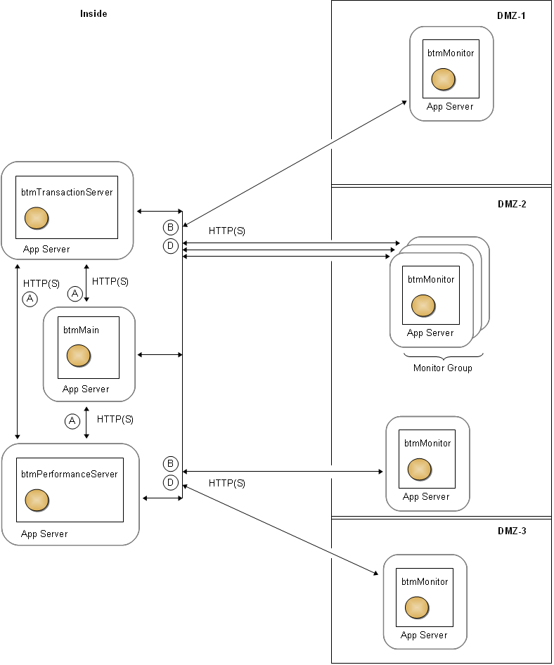

Each central server (the Main, the Transaction, and the Performance server) |
HTTP or HTTPS |
Any other central server |
The central servers must be able to communicate with each other. The usual deployment topology will place each of these in the same network zone. |

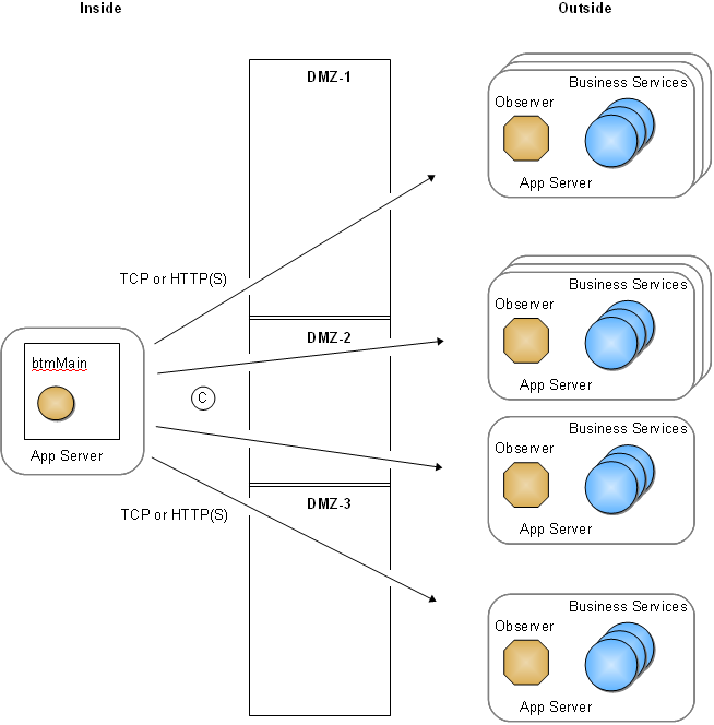

Main server |
TCP, HTTP or HTTPS |
All monitored business services |
The Main server should be able to communicate with the monitored business services to determine whether they are ”alive” (up or down). Note that the precise protocol used to determine aliveness can be configured on a per-service basis. (For information on configuring this protocol, enter a service request at My Oracle Support.) |
C |

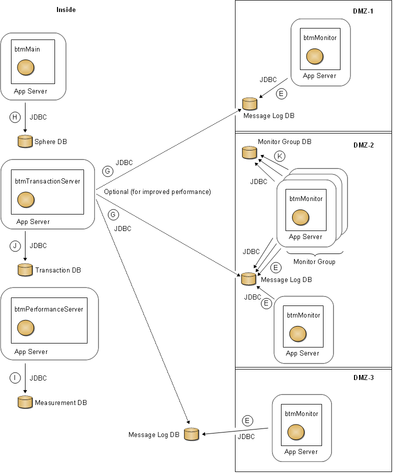

Each monitor |
JDBC |
A Message Log Database (messageLogDB) |
Each monitor must be able to write to, and read from, its Message Log Database using JDBC. The Message Log Database can be a single database inside a trusted network that is used by all monitors. Alternatively, if you have monitors in a DMZ or in a network without access to a centralized database, you can deploy one or more databases for the remote monitors. |
E |

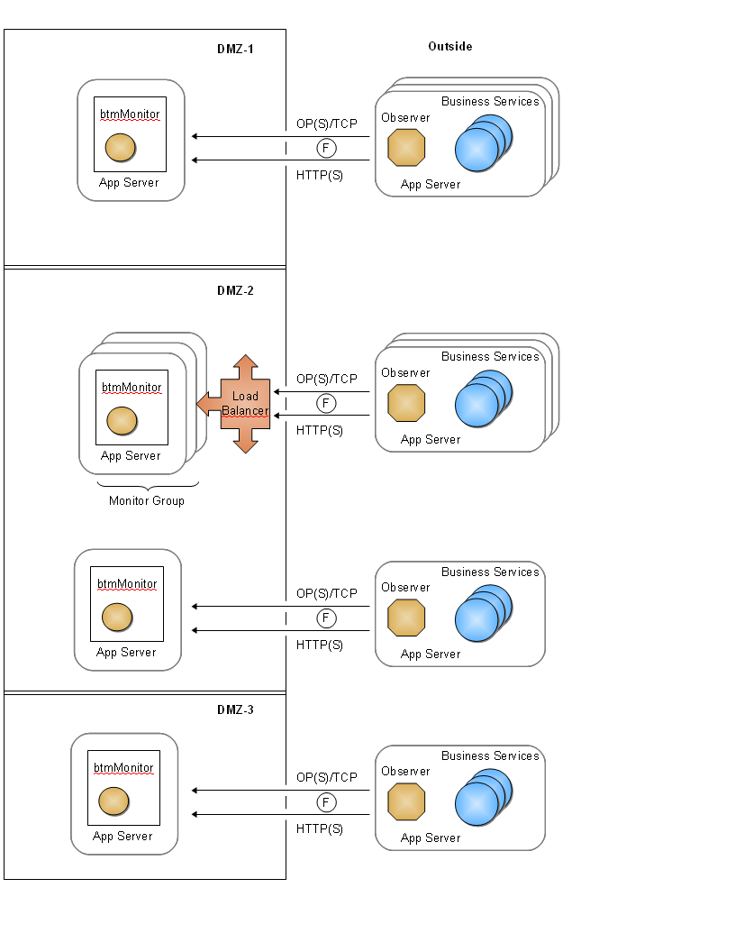

Each observer |
TCP and HTTP or HTTPS |
Associated monitor |
Each observer requires two connections to its associated monitor. The observer uses an HTTP(S) connection to download its configuration from the monitor. To transmit observation messages to the monitor, the observer connects using Observation Protocol (OP) over TCP or Observation Protocol Secure (OPS) over a secure socket. For monitor groups, these connections are made to the load balancer that fronts the monitor group. The socket port number is configured by way of the Observer Communication policy. |
F |
Transaction server |
JDBC |
All Message Log Databases |
Optional. The Transaction server does not require direct access to the Message Log Databases. However, by providing such access, you can improve the performance of message log queries. You should enable this communication channel whenever possible. |
G |
Main server |
JDBC |
Sphere database (sphereDB) |
The Main server must be able to write to the Sphere database using JDBC. |
H |
Performance |
JDBC |
Measurement database (measurementDB) |
The Performance server must be able to write to the Measurement database using JDBC. |
I |
Transaction |
JDBC |
Transaction database (transactionDB) |
The Transaction server must be able to write to the Transaction database using JDBC. |
J |
Monitor (in a monitor group) |
JDBC |
Monitor group database |
Each monitor in a particular monitor group must be able to write to the same monitor group database using JDBC. |
K |

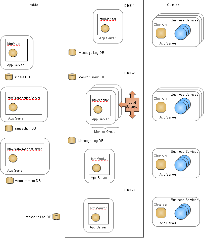

The following diagrams illustrate the type of access required by Business Transaction Management components in a variety of deployment scenarios. Note that the circled letters in the diagrams cross reference Table 4-1, "Business Transaction Management Communication Protocols".
Figure 4-1, "Deployed Business Transaction Management Components and Business Services"
Figure 4-3, "Connections Between Business Transaction Management Components and Databases"
Figure 4-4, "Communication Connections Between the Monitors and Observers"
Figure 4-5, "Communication Connections Between the Main Server and Business Services"
Figure 4-1 Deployed Business Transaction Management Components and Business Services
Figure 4-2 Communication Connections Among the Central Servers and Between the Central Servers and Monitors
Figure 4-3 Connections Between Business Transaction Management Components and Databases
Figure 4-4 Communication Connections Between the Monitors and Observers
Figure 4-5 Communication Connections Between the Main Server and Business Services

Observers and monitors communicate with each other by way of two separate channels—a socket connection for transmitting observation messages, and an HTTP/HTTPS connection for administration-related messages. Setting up SSL for the socket connection is covered in Section 4.4, "Setting up a Secure Socket (SSL) for Observation Messages." Setting up an HTTPS connection is a separate and unrelated task that you perform using the security features of your application servers.This section pertains to all Business Transaction Management components, including the command line interface (CLI).
