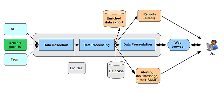

RUEI is based on a three-layer product architecture, as shown in Figure 1-4.
Figure 1-4 RUEI Product Architecture
Description of Figure 1-4 follows
Description of "Figure 1-4 RUEI Product Architecture"
The monitored data packets are processed by the layers shown in Table 1-2.
Table 1-2 Product Architecture Layers
Layer Description
Data Collection
This layer is responsible for acquiring raw data and delivering it to the Data Processor layer. This data can be collected from multiple sources. The available attachment options are described later in this section.
Data Processing
This layer converts the raw data into the OLAP data sets. These comprise the multi-dimensional data structure that is viewable with the Data Browser.
Data Presentation (Reporter)
This layer is RUEI's analysis and reporting environment. This is a web-based information portal that can be accessed from any supported browser.
As will be explained in a later section, each of these layers can be deployed on the same system, or for scalability issues, on separate systems.

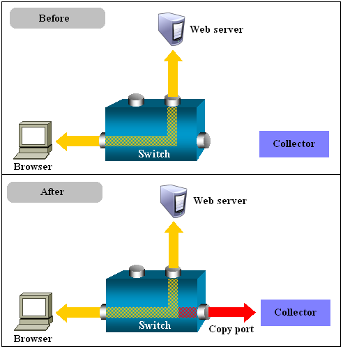

A copy port is a switch that starts to build up a Layer 2 forwarding table on the basis of the source MAC address of the different packets that the switch receives. After this forwarding table is built, the switch forward traffic that is destined for a MAC address directly to the corresponding port.
For example, after the web server MAC in Figure 1-5 is learned, unicast traffic from the browser to the web server is only forwarded to the web server port. Therefore, the Collector does not see this traffic.
Figure 1-5 Network Connection Using a Copy Port
Description of Figure 1-5 follows
Description of "Figure 1-5 Network Connection Using a Copy Port"
In the configuration shown in the lower part of Figure 1-5, the Collector is attached to a port that is configured to receive a copy of every packet that the browser sends and receives. This port is called a copy port. Copy ports can copy traffic from any or all data ports to a single unused port and prevents bi-directional traffic on the port to protect against backflow or traffic into the network.
Be aware that activating a copy port on a switch can have a performance impact. Typically, copy ports support a wide range of configuration options, and for further information about these options you should consult your switch documentation or contact the vendor.

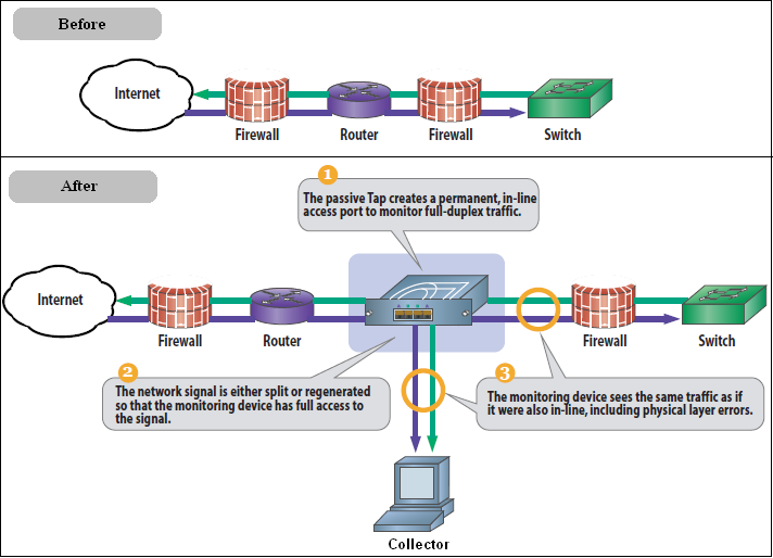

TAPs can be placed between any two network devices (such as routers and firewalls). Any monitoring device connected to a TAP receives the same traffic as if it were in-line, including all errors. This is achieved through the TAP duplicating all traffic on the link, and forwarding it to the monitoring port(s). The example shown in Figure 1-6 illustrates a typical TAP deployment for one Collector.
Figure 1-6 Network Monitoring Using a TAP
Description of Figure 1-6 follows
Description of "Figure 1-6 Network Monitoring Using a TAP"
Important
Unlike copy ports, in the event of power failure, TAPs continue to allow data to flow between network devices. In addition, copy ports are prone to packet loss when under load. TAP devices are available for copper or fibre-based infrastructures. Moreover, they can be easily deployed when and where required, but without reconfiguration of switches or engineers needing to re-cable a network link. For these reasons, the use of TAPs is strongly recommended over that of copy ports.
Broadly speaking, there are three types of TAPs: network, regeneration, and aggregation TAPs. RUEI supports the use of network and regeneration TAPs. Aggregation taps are only supported if they maintain the ordering of packets in the packet stream. Note that reporting accuracy can be impacted when using aggregation taps if the monitor port gets saturated, resulting in packet loss and inaccurate timing information. In addition, be aware that when capturing data with a network TAP, the use of cascaded TAP configurations is not supported.

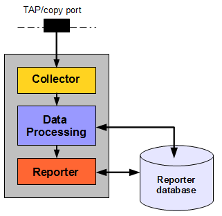

Single-Server Deployment
This is the simplest deployment, and is suitable for monitoring web environments with low to medium levels of traffic. An example is shown in Figure 1-7.

In this deployment, a single system servers as both Collector and Reporter. As explained in the previous section, the Reporter database can reside locally on the Reporter system or on a remote database server.

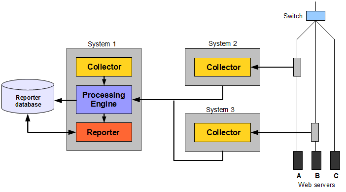

Figure 1-8 Multiple-Collector Deployment
Description of Figure 1-8 follows
Description of "Figure 1-8 Multiple-Collector Deployment"
This features a deployment in which both data lines are monitored in the same reporting environment. Note that this deployment assumes that the traffic on each line is mutually exclusive. It also illustrates a deployment used for security reasons. While the traffic from web servers A and B are monitored and reported, the traffic from web server C is not. This is also the reason why the Collectors are not placed above the switch. Note that the Collector instance on the Reporter system (system 1) is disabled.

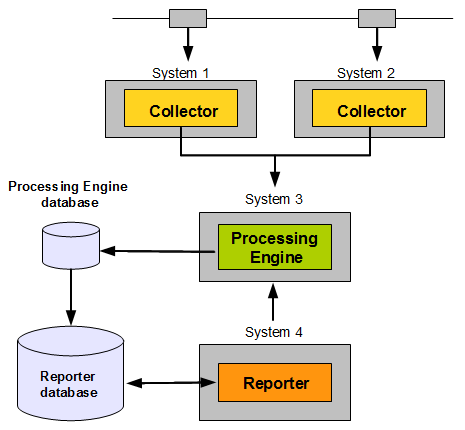

Three-Tier Deployment
As explained earlier, a Processing Engine serves to offload a significant amount of the processing normally performed by the Reporter to a separate system. It is strongly recommended that you consider the use of a Processing Engine within your deployment when CPU utilization on the Reporter system is reaching its upper limit. Figure 1-9 shows an example of a Processing Engine within a multiple-Collector deployment.
The use of Processing Engines is only supported for remote Collectors. A combined installation of a Processing Engine and a Collector on the same system is not supported.
Figure 1-9 Three-Tier Deployment
Description of Figure 1-9 follows
Description of "Figure 1-9 Three-Tier Deployment"
It is important to understand that the processing performed on the Reporter system includes not only the processing of the data gather by the attached Collectors, but also the use of the Enriched data export facility. This enables you to combine the data gathered by RUEI with other data sources. Be aware that, when enabled, this facility places a considerable additional load on the Reporter system. The Enriched data export facility is described in the Oracle Real User Experience Insight User's Guide.

Footnote 1: Copy ports are also known as Switched Port Analyzer (SPAN) ports which is a feature of Cisco switches.
Footnote 2: Test Access Port (TAP) devices are provided by specialist vendors, such as NetOptics Inc.
