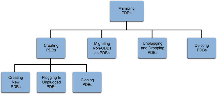

Figure 17-1 provides a graphical overview of how you can manage the PDB lifecycle in Cloud Control.
For more information about PDBs and CDBs, see the Managing Pluggable Databases part in Oracle Database Administrator's Guide.

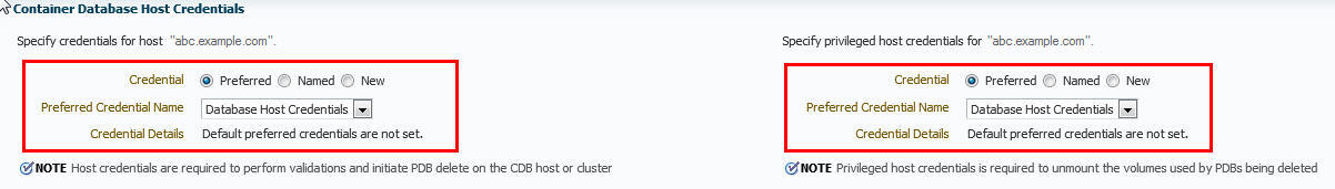

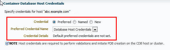

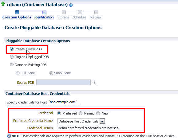

In the Container Database Host Credentials section, select or specify the target CDB Oracle home owner host credentials. If you have already registered the credentials with Enterprise Manager, you can select Preferred or Named. Otherwise, you can select New and enter the credentials.
Figure 17-3 displays the Creation Options page.
Click Next.

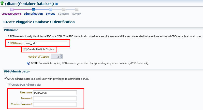

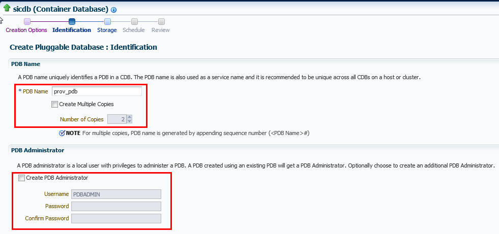

In the Identification page, enter a unique name for the PDB you are creating.
If you prefer to create more than one PDB in this procedure, then select Create Multiple Copies, and set the number of PDBs that you want to create. Note that you can create a maximum of 252 PDBs within a CDB.
If you choose to create multiple PDBs, then the unique name you enter here is used as a prefix for all PDBs, and the suffix is a numeric value that indicates the count of PDBs.For example, if you create five PDBs with the name accountsPDB, then the PDBs are created with the names accountsPDB1, accountsPDB2, accountsPDB3, accountsPDB4, and accountsPDB5.
In the PDB Administrator section, enter the credentials of the admin user account you need to create for administering the PDB.
Figure 17-4 displays the Identification page.
If you choose to create multiple PDBs, then an admin user account is created for each PDB that you create, with the same set of the specified credentials.Click Next.

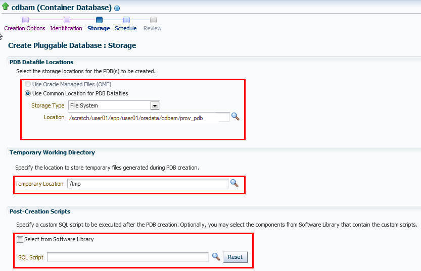

In the Storage page, in the PDB Datafile Locations section, select the type of location where you want to store the datafiles.
If the target CDB (CDB in which you are creating the PDB) is enabled with Oracle Managed Files and if you want to use the same, then select Use Oracle Managed Files (OMF).
If you want to enter a custom location, then select Use Common Location for PDB Datafiles. Select the storage type and the location where the datafiles can be stored.
In the Temporary Working Directory section, enter a location where the temporary files generated during the PDB creation process can be stored.
In the Post-Creation Scripts section, select a custom SQL script you want to run as part of this procedure, once the PDB is created.
Figure 17-5 displays the Storage page.

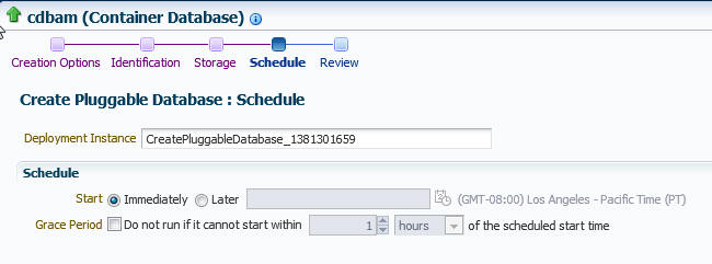

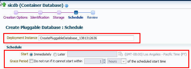

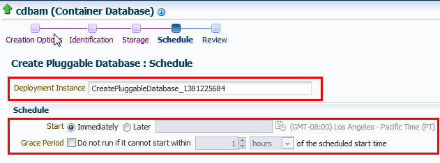

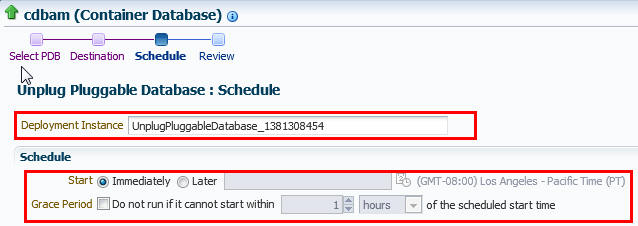

In the Schedule page, enter a unique deployment procedure instance name and a schedule for the deployment. The instance name you enter here helps you identify and track the progress of this procedure on the Procedure Activity page.
If you want to run the procedure immediately, then retain the default selection, that is, Immediately. Otherwise, select Later and provide time zone, start date, and start time details.
You can optionally set a grace period for this schedule. A grace period is a period of time that defines the maximum permissible delay when attempting to run a scheduled procedure. If the procedure does not start within the grace period you have set, then the procedure skips running. To set a grace period, select Grace Period, and set the permissible delay time.
Figure 17-6 displays the Schedule page.

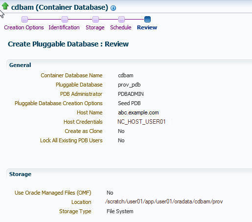

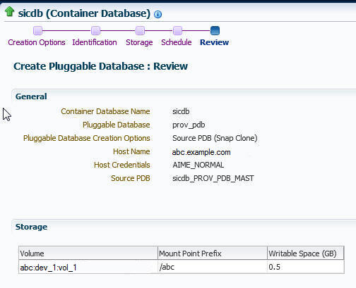

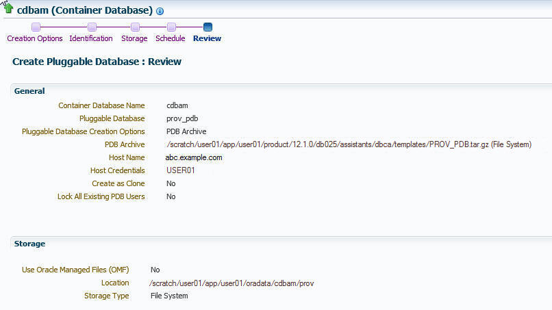

In the Review page, review the details you have provided for the deployment procedure. If you are satisfied with the details, click Submit.
If you want to modify the details, then click Back repeatedly to reach the page where you want to make the changes.
Figure 17-7 displays the Review page.

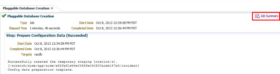

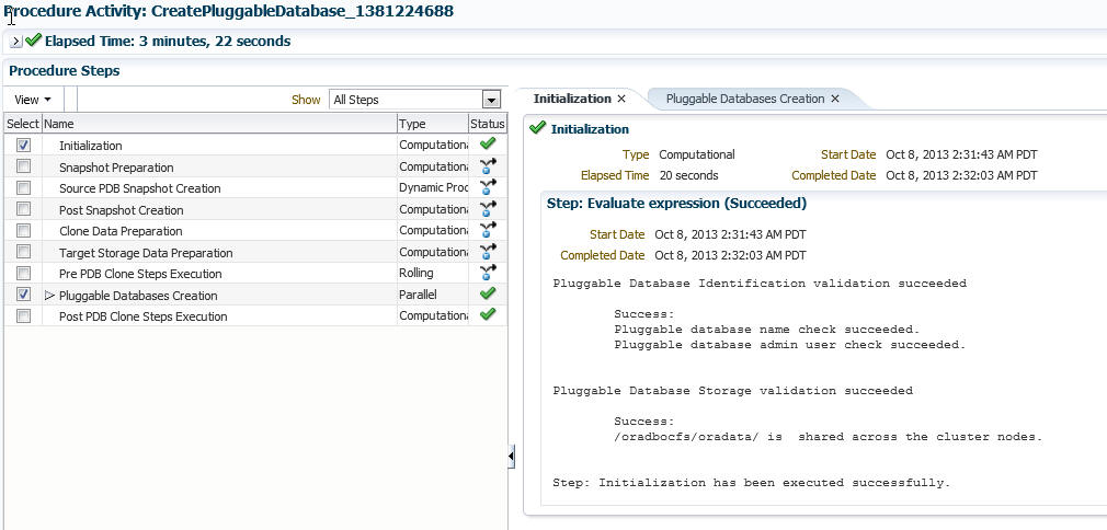

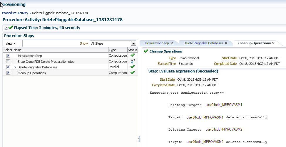

In the Procedure Activity page, view the status of the procedure. From the Procedure Actions menu, you can select Debug to set the logging level to Debug, and select Stop to stop the procedure execution.
Figure 17-8 displays the Procedure Activity page.

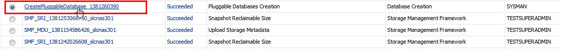

When you create a new PDB, the Enterprise Manager job system creates a Create Pluggable Database job. For information about viewing the details of this job, see Section 17.5.1.

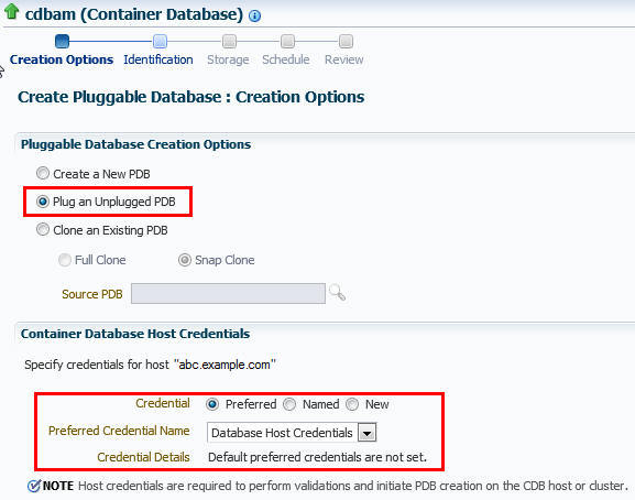

You will be prompted to log in to the database if you have not already logged in to it through Enterprise Manager. Make sure you log in using sysdba user account credentials.In the Creation Options page of the Create Pluggable Database Wizard, in the Pluggable Database Creation Options section, select Plug an Unplugged PDB.
Figure 17-10 displays the Creation Options page.
Click Next.

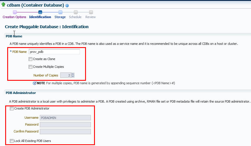

In the Identification page, enter a unique name for the PDB you are plugging in.
Select Create As Clone to ensure that Oracle Database generates a unique PDB DBID, GUID, and other identifiers expected for the new PDB.
In the PDB Administrator section, do one of the following to administer the PDB:
If you prefer to use the admin user account that was created as part of the source PDB that you are plugging in, then deselect Create PDB Administrator.
If you want to create a brand new admin user account for the PDB you are plugging in, then select Create PDB Administrator, and enter the desired credentials.
If you choose to create multiple PDBs, then an admin user account is created for each PDB that you create, with the same set of the specified credentials.To lock and expire all the users in the newly created PDB, (except the newly created Admin), select Lock All Existing PDB Users.
Figure 17-11 displays the Identification page.

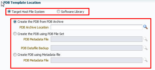

In the PDB Template Location section, select the location where the source PDB's template is available, and then select the type of PDB template.
If the PDB template is available on your CDB host (CDB to which you are plugging in the unplugged PDB), then select Target Host File System.
If the PDB template is a single archive file—a TAR file with datafiles and metadata XML file included in it, then select Create the PDB from PDB Archive, then select the PDB template.
If the PDB template is a PDB file set—a separate DFB file with all the datafiles and a separate metadata XML file, then select Create the PDB using PDB File Set, then select the DBF and XML files.
If you want to plug in a PDB using the PDB metadata XML file and the existing datafiles, then select Create PDB using Metadata file.
If the PDB template is available in Oracle Software Library (Software Library), then select Software Library, then select the component in the Software Library that contains the PDB template.
Figure 17-12 displays the PDB Template Location section of the Identification page.

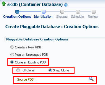

To clone a PDB using the traditional method of cloning the PDB datafiles, select Full Clone. Use this method if you want to clone a PDB for long term usage. This method is ideal for load testing, when you plan to make significant data updates to the PDB clone. However, this method takes a longer period of time, and a clone that is created using this method occupies a fairly large amount of space, as compared to the Snap Clone method.
To clone a PDB using the Storage Management Framework (SMF) Snap Clone feature, select Snap Clone. Use this method if you want to clone a PDB for short term purposes. This method is ideal for functional testing, as the cloning process is quick, and a PDB clone that is created using this method occupies very little space. However, this method is not suitable if you plan to make significant data updates to the PDB clone.
For Source PDB, select the PDB that you want to clone.
Figure 17-18 displays the PDB Creation Options section of the Creation Options page.
In the CDB Host Credentials section, select or specify the target CDB Oracle Home owner host credentials. If you have already registered the credentials with Enterprise Manager, you can select Preferred or Named. Otherwise, you can select New and enter the credentials.
Figure 17-19 displays the CDB Host Credentials section of the Creation Options page.

In the Identification page, enter a unique name for the PDB you are cloning.
If you prefer to create more than one PDB in this procedure, then select Create Multiple Copies, and set the number of PDBs you want to create. Note that you can create a maximum of 252 PDBs.
If you choose to create multiple PDBs, then the unique name you enter here is used as a prefix for all the cloned PDBs, and the suffix is a numeric value that indicates the count of PDBs.For example, if you create five PDBs with the name accountsPDB, then the PDBs are created with the names accountsPDB1, accountsPDB2, accountsPDB3, accountsPDB4, and accountsPDB5.
If you prefer to use the admin user account that was created as part of the source PDB that you are cloning, then deselect Create PDB Administrator.
If you want to create a brand new admin user account for the PDB you are cloning, then select Create PDB Administrator, and enter the desired credentials.
Figure 17-20 displays the Identification page.
If you choose to create multiple PDBs, then an admin user account is created for each PDB that you create, with the same set of the specified credentials.In the Source CDB Login Credentials section, select or specify the login credentials of the source CDB. If you have already registered the credentials with Enterprise Manager, you can select Preferred or Named. Otherwise, you can select New and enter the credentials.

In the Storage page, specify the storage information.
If you chose the Full Clone method to clone the PDB, select the type of location where you want to store the PDB datafiles in the following manner:
If the source CDB is enabled with Oracle Managed Files and if you want to use the same, then select Use Oracle Managed Files (OMF).
Figure 17-21 displays the Storage page for the Full Clone method.

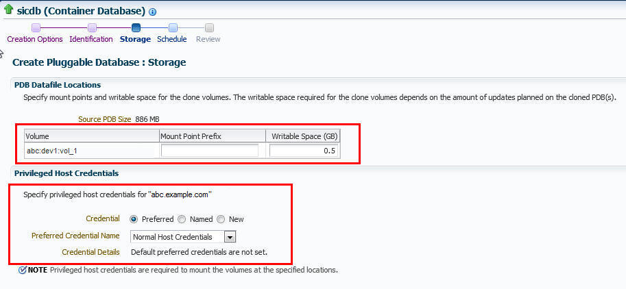

If you chose the Snap Clone method to clone the PDB, do the following:
In the PDB Datafile Locations section, specify a value for Mount Point Prefix, that is, the mount location for the storage volumes. You can choose to specify the same prefix for all the volumes, or a different prefix for each volume. Also, specify a value for Writable Space, that is, the space that you want to allocate for writing the changes made to the PDB clone. You can choose to specify the same writable space value for all the volumes, or a different value for each volume.
In the Privileged Host Credentials section, select or specify the credentials of the root user. These credentials are used for mounting the cloned volumes on the destination host.
Figure 17-22 displays the Storage page for the Snap Clone method.
In the Post-Creation Scripts section, select a custom SQL script you want to run as part of this procedure, once the PDB is cloned.
Figure 17-23 displays the Schedule page.
Figure 17-24 displays the Review page.
Figure 17-25 displays the Procedure Activity page.
When you clone a PDB, the Enterprise Manager job system creates a Create Pluggable Database job. For information about viewing the details of this job, see Section 17.5.1.

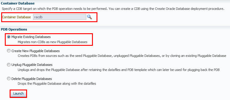

From the Enterprise menu, select Provisioning and Patching, then select Database Provisioning. In the Database Provisioning page, in the Related Links section of the left menu pane, click Provision Pluggable Databases.
You can also access the Provision Pluggable Database Console from the home page of the CDB. To do so, in the CDB's home page, from the Oracle Database menu, select Provisioning, then select Provision Pluggable Database.In the Provision Pluggable Database Console, in the CDB section, select the CDB to which you want to migrate a non-CDB as a PDB.
Skip this step if you have accessed the Provision Pluggable Database Console from the CDB's home page.In the PDB Operations section of the Provision Pluggable Database page, select the Migrate Existing Databases option and click Launch.
Figure 17-26 displays the Provision Pluggable Database Console.
On the Database Login page, select the Credential Name from the drop-down list. Click Login.

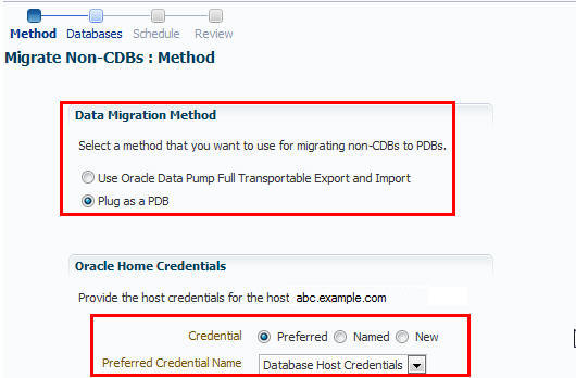

On the Migrate Non-CDBs launch page, select a data migration method, that is, Export/Import or Plug as a PDB. If you select Plug as a PDB, ensure that the non-CDB that you want to migrate is open, and is in read-only mode.
Enter the appropriate credentials for the Oracle Home Credential section.
Click Next.
Figure 17-27 displays the Method page.

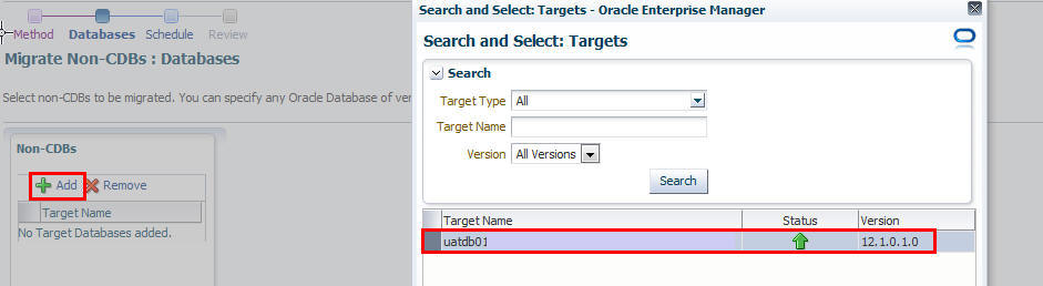

On the Database page, select a Non-CDB to be migrated. You can select more than one. Click Add. In the database pane, provide the appropriate credential, properties, export, import, and datafile location information. Click Next.
Figure 17-28 displays how to select the non-CDB you want to migrate.

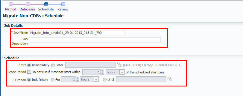

On the Schedule page, enter the appropriate job and scheduling details. Click Next.
Figure 17-33 displays the Schedule page.

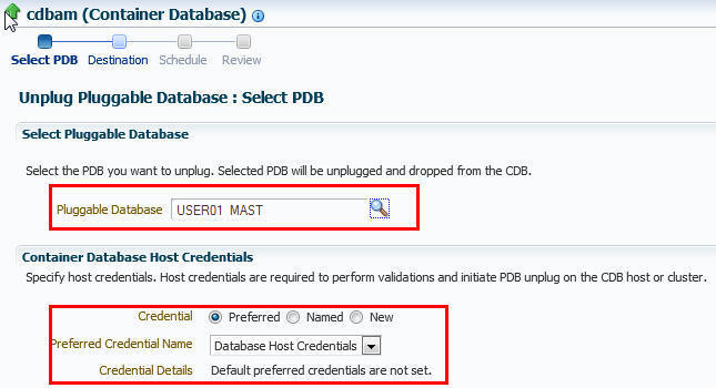

You will be prompted to log in to the database if you have not already logged in to it through Enterprise Manager. Make sure you log in using sysdba user account credentials.In the Select PDB page of the Unplug Pluggable Database Wizard, in the Select Pluggable Database section, select the PDB you want to unplug. Note that the PDB once unplugged will be stopped and dropped.
Figure 17-36 displays the Select PDB page.

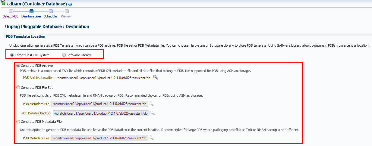

In the Destination page, select the type of PDB template you want to generate for unplugging the PDB, and the location where you want to store it. The PDB template consists of all datafiles as well as the metadata XML file.
If you want to store the PDB template on your CDB host (CDB from where you are unplugging the PDB), then select Target Host File System.
If you want to generate a single archive file—a TAR file with the datafiles and the metadata XML file included in it, then select Generate PDB Archive. Select a location where the archive file can be created.
Oracle recommends you to select this option if the source and target CDBs are using file system for storage. This option is not supported for PDBs using ASM as storage.If you want to generate an archive file set—a separate DFB file with all the datafiles and a separate metadata XML file, then select Generate PDB File Set. Select the locations where the DBF and XML files can be created.
Oracle recommends you to select this option if the source and target CDBs are using ASM for storage.If you want to generate only a metadata XML file, leaving the datafiles in their current location, then select Generate PDB Metadata File. Select a location where the metadata XML file can be created.
If you want to store the PDB template in Oracle Software Library (Software Library), then select Software Library.
If you want to generate a single archive file—a TAR file with the datafiles and the metadata XML file included in it, then select Generate PDB Archive. If you want to generate an archive file set—a separate DFB file with all the datafiles and a separate metadata XML file, then select Generate PDB File Set. If you want to generate only a metadata XML file, leaving the datafiles in their current location, then select Generate PDB Metadata File.
Enter a unique PDB template name.
The template is created in the default location that has the following format:
Database Configuration/<db_release>/<platform>/Database Templates
For example,
Database Configuration/12.1.0.0.2/unix/Database Templates
Enter a temporary location where the archive can be created by Enterprise Manager before it is uploaded to the Software Library.
Figure 17-37 displays the Destination page.
Figure 17-38 displays the Schedule page.

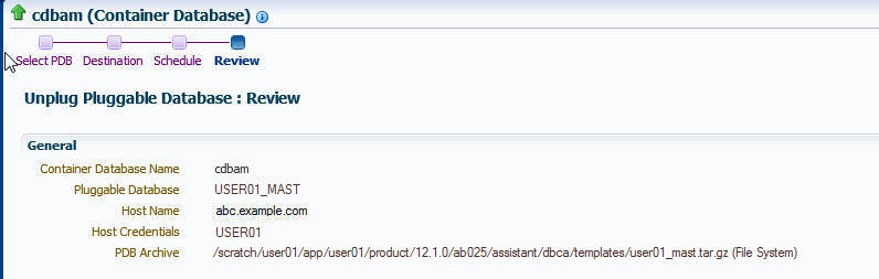

Figure 17-39 displays the Review page.

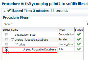

When you unplug and drop a PDB, the Enterprise Manager job system creates an Unplug Pluggable Database job. For information about viewing the details of this job, see Section 17.5.2.

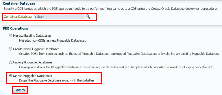

You can also access the Provision Pluggable Database Console from the home page of the CDB. To do so, in the CDB's home page, from the Oracle Database menu, select Provisioning, then select Provision Pluggable Database.In the Provision Pluggable Database Console, in the CDB section, select the CDB from which you want to delete the PDBs.
Skip this step if you have accessed the Provision Pluggable Database Console from the CDB's home page.In the PDB Operations section, select Delete Pluggable Databases.
Click Launch.
Figure 17-40 displays the Provision Pluggable Database Console.
If one (or more) of the PDBs that you selected for deletion is the Snap Clone of another PDB, you must also provide the privileged host credentials, that is, the credentials of the root user. If you have already registered the credentials with Enterprise Manager, you can select Preferred or Named. Otherwise, you can select New and enter the credentials.
Figure 17-42 displays the CDB Host Credentials section of the Select PDBs page.

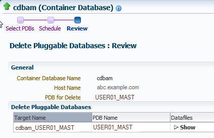

Figure 17-44 displays the Review page.

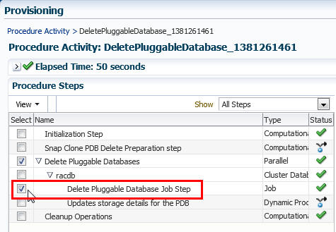

Figure 17-45 displays the Procedure Activity page.
When you delete a PDB, the Enterprise Manager job system creates a Delete Pluggable Database job. For information about viewing the details of this job, see Section 17.5.3.

From the Enterprise menu, select Provisioning and Patching, then select Procedure Activity.
Click the deployment procedure that contains the required create PDB job.
Expand the deployment procedure steps. Select the PDB creation job.

In the Prepare Configuration Data step, the system prepares for PDB creation.
In the Check Prerequisites step, the system checks the prerequisites for PDB creation.
In the Verify and Prepare step, the system runs tasks prior to PDB creation.
In the Perform Configuration step, the PDB creation is performed. For details of the performed tasks and their status, refer to the remote log files present on the host.
In the Post Configuration step, Enterprise Manager is updated with the newly created PDB details, and the custom scripts are run.
To view a visual representation of the create PDB job progress, click Results.
In the Configuration Progress section, you can view the completion percentage of the job, and a list of pending, currently running, and completed job steps. You can also view errors, warnings, and logs. The tail of the log for the currently running job step is displayed.

In the Perform Configuration step, the PDB unplugging is performed. For details of the performed tasks and their status, refer to the remote log files present on the host.
In the Post Configuration step, Enterprise Manager is updated with the unplugged PDB details.
To view a visual representation of the unplug PDB job progress, click Results.
To view the details of a delete PDB job, follow these steps:
Click the deployment procedure that contains the required delete PDB job.
Expand the deployment procedure steps. Select the delete PDB job.
Click Job Summary.
To view a summary of the job details, click Summary.
In the Prepare Configuration Data step, the system prepares for deleting the PDBs.
In the Verify and Prepare step, the system runs tasks prior to deleting the PDBs.
In the Perform Configuration step, the PDB deletion is performed. For details of the performed tasks and their status, refer to the remote log files present on the host.
In the Post Configuration step, Enterprise Manager is updated with the deleted PDB details.
To view a visual representation of the delete PDB job progress, click Results.
