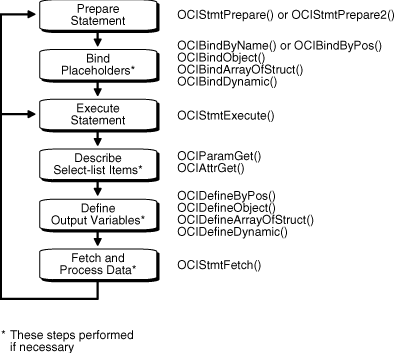

Chapter 2 discussed the basic steps involved in any OCI application. This chapter presents a more detailed look at the specific tasks involved in processing SQL statements in an OCI program.
One of the most common tasks of an OCI program is to accept and process SQL statements. This section outlines the specific steps involved in this processing.
Once you have allocated the necessary handles and connected to an Oracle database, follow the steps illustrated in Figure 4-1.
Figure 4-1 Steps in Processing SQL Statements
Description of Figure 4-1 follows
Description of "Figure 4-1 Steps in Processing SQL Statements"
  1. Prepare the statement. Define an application request using OCIStmtPrepare2() or OCIStmtPrepare(). OCIStmtPrepare2() is an enhanced version of OCIStmtPrepare() that was introduced to support statement caching.
  2. Bind placeholders, if necessary. For DML statements and queries with input variables, perform one or more of the following bind calls to bind the address of each input variable (or PL/SQL output variable) or array to each placeholder in the statement.
  3. Execute the statement by calling OCIStmtExecute(). For DDL statements, no further steps are necessary.
  4. Describe the select-list items, if necessary, using OCIParamGet() and OCIAttrGet(). This is optional step is not required if the number of select-list items and the attributes of each item (such as its length and data type) are known at compile time.
  5. Define output variables, if necessary. For queries, perform one or more define calls to OCIDefineByPos(), OCIDefineObject(), OCIDefineDynamic(), or OCIDefineArrayOfStruct() to define an output variable for each select-list item in the SQL statement. Note that you do not use a define call to define the output variables in an anonymous PL/SQL block. You did this when you bound the data.
  6. Fetch the results of the query, if necessary, by calling OCIStmtFetch2().
After these steps have been completed, the application can free allocated handles and then detach from the server, or it may process additional statements.
