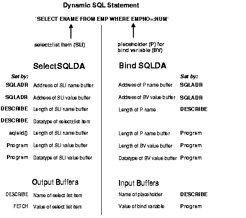

DESCRIBE helps you provide the information Oracle needs by storing descriptions of select-list items or placeholders in a SQLDA.
You use the DESCRIBE statement to help obtain the information Oracle needs.
The DESCRIBE SELECT LIST statement examines each select-list item and determines its name, datatype, constraints, length, scale, and precision. It then stores this information in the select SQLDA, and in program variables pointed to by fields in the SQLDA. The total number of select-list items is also stored in the SQLDA by the DESCRIBE statement.
The DESCRIBE BIND VARIABLES statement obtains the number of placeholders in the SQL statement, and the names and lengths of each placeholder. The program must then fill in the datatype and length of the associated bind variables in the SQLDA, and obtain the bind variable values, which are stored in the program variables pointed to by fields in the SQLDA.
See the section "The Basic Steps" later in this chapter for a complete description of the steps that you perform to declare, allocate, and use the SQLDA.

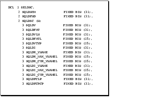

Declaring a SQLDA
To declare a SQLDA, copy it into your program with the statement
EXEC SQL INCLUDE DESCRIPTOR_NAME;
where, DESCRIPTOR_NAME is the name of the file containing the text of the descriptor declaration. Or hardcode it as shown.

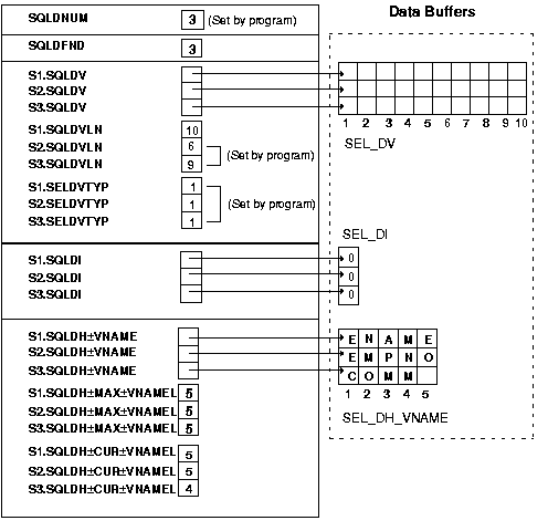

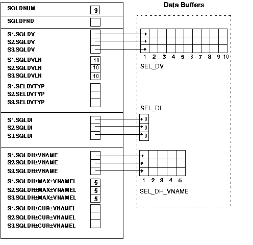

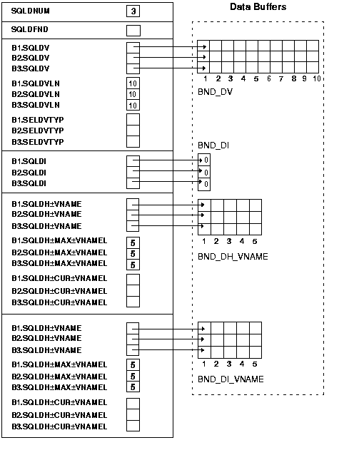

Figure 5-1 shows a SQLDA named SELDSC. It is a select descriptor. A bind descriptor is identical.
Figure 5-1 The SQL Descriptor Area
Sql descriptor area
Description of "Figure 5-1 The SQL Descriptor Area"
In the examples used in this section, the structures are named SELDSC for the select SQLDA, and BNDDSC for the bind SQLDA. These structures are identical, except for their names.

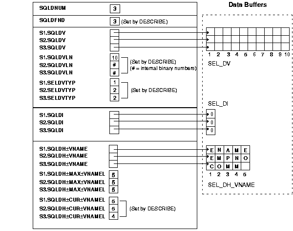

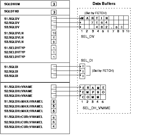

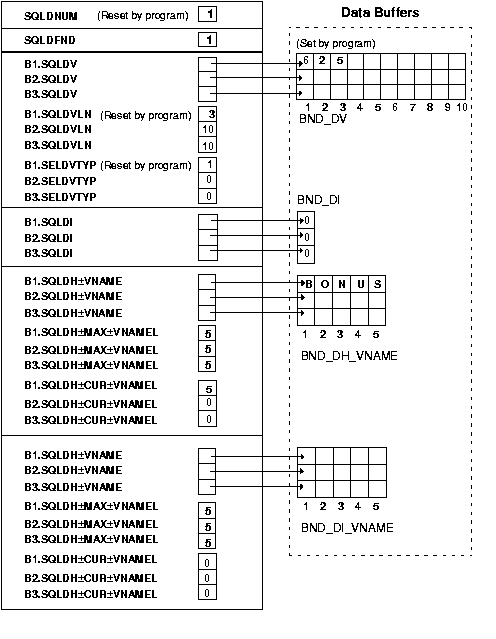

shows whether variables are set by calls to SQLADR, DESCRIBE commands, FETCH commands, or program assignments.
Figure 5-2 How Variables Are Set
how variables are set
Description of "Figure 5-2 How Variables Are Set"

The SQLDA Variables
This section explains the purpose and use of each element in the SQLDA structure.
{SELDSC | BNDDSC}
The name of the structure. The name is arbitrary; however, the examples in this manual use BNDDSC for a bind descriptor and SELDSC for a select descriptor. The names of the structure elements are not arbitrary; they should not be changed.
SQLDNUM
Contains the number of bind variables or select-list items that can be DESCRIBEd. Before issuing a DESCRIBE statement, your program must set this variable to the maximum size of the SQLDSC substructure array. After the DESCRIBE statement, SQLDNUM must be reset to the actual number of variables described, which is contained in SQLDFND.
SQLDFND
Set when Oracle Database performs a DESCRIBE statement. It contains the number of bind variables or select-list items DESCRIBEd. If after a DESCRIBE, SQLDFND is less than 0, there were more bind variables or select-list items than specified in SQLDNUM. In this case, SQLDFND is set to the negative of the number of variables DESCRIBEd. For example, if SQLDNUM is 10, and SQLDFND contains the value -11 after a DESCRIBE, 11 select-list items or bind variables were found. If this happens, you cannot process the statement.
SQLDSC(N)
Defines an array of N substructures. In a select descriptor, each substructure holds information about a select-list item, and the addresses of the buffers that will hold the data retrieved from the item. In a bind descriptor, each substructure holds information about a bind variable, and the address of the data buffer that contains the value of the bind variable.
You must set N before compiling your program. It should be large enough to handle the maximum number of expected bind variables (for the bind descriptor) or the maximum number of expected select-list items (for the select descriptor).
SQLDV
Holds the address of the buffer that contains the value for this bind variable, or that will hold the data retrieved from the select-list item.
Your program must place the address in this element using the SQLADR procedure. Set this element in a select descriptor before doing a FETCH. In a bind descriptor, set it before doing the OPEN.
SQLDFMT
Holds the address of a format conversion string, used only with decimal datatypes (FIXED DECIMAL(P,S) or FIXED DECIMAL(P)). They have the Oracle external datatype code 7. The format conversion string is of the form 'PP.+SS' or 'PP.-SS', where PP is the precision of the decimal number, and SS is the scale. The '+' and '-' signs are mandatory. For example, a FIXED DECIMAL(6,2) format string would be '06.+02'. Refer to the "Coercing Datatypes after DESCRIBE" section later in this chapter for more information on the use of precision and scale for Oracle NUMBER data.
Set this element using SQLADR. Set it before a FETCH in a select descriptor, and before an OPEN in a bind descriptor. You must also set the length of the format conversion string in the SQLDFMTL element.
SQLDVLN
Select Descriptor Oracle sets this element when it executes the DESCRIBE statement. It contains the length of the select-list value. The format of the length differs among Oracle datatypes. For character datatypes (VARCHAR2 and CHAR), SQLDVLN is set to the number of bytes in the select-list item. For NUMBER datatypes, the scale is returned in the low-order byte of the variable, and the precision in the next highest-order byte.
If, for a NUMBER datatype, SQLDVLN is set to zero, then the column in the table was established with no explicit precision and scale, or the precision and scale for the select-list expression was not determined. In this case, you must decide on an appropriate value (between 0 and 38) and put it in SQLDVLN before the FETCH.
For maximum portability, use the SQLPRC or SQLPR2 library procedures (described in the "Datatypes in the SQLDA" section later in this chapter) to retrieve the precision and scale values from SQLDVLN.
You must reset SQLDVLN to the required length of the data buffer before executing the FETCH statement. For example, if you coerce a described NUMBER to a PL/1 CHARACTER string, set SQLDVLN to the precision of the number, and add two to account for the sign and decimal point.
If you coerce a NUMBER to a PL/1 FLOAT, set SQLDVLN to the length in bytes of the appropriate FLOAT type in your implementation of PL/1 (usually 4 for a FLOAT(7) or less, and 8 for a FLOAT(8) or greater). See the "Datatypes in the SQLDA" section for more information about the lengths of coerced datatypes.
Bind Descriptor Your program must set the correct SQLDVLN value, which is the length in bytes of the bind variable data buffer that SQLDV points to. Set the length before executing the OPEN statement.
SQLDVTYP
Select Descriptor Oracle sets this element when it performs the DESCRIBE statement. It contains the datatype code for the select-list value. This datatype code determines how the Oracle data will be converted into the PL/1 data buffer or variable that SQLDV points to. This topic is covered in detail in the "Datatypes in the SQLDA" section later in this chapter.
In a select descriptor, the high-order bit of this element is set to indicate the NULL/NOT NULL status of the field. You should retrieve the datatype code using the SQLNUL procedure. See the "Handling NULL/NOT NULL Datatypes" section later in this chapter for a description of this procedure.
Bind Descriptor The DESCRIBE statement sets this element to zero. You must set the datatype code in this element before executing the OPEN statement. The code indicates the external PL/1 type of the buffer or variable that SQLDV points to. Refer to the section "Datatypes in the SQLDA" later in this chapter for more information on the datatype codes.
SQLDI
Holds the address of an indicator variable, declared in your program. The indicator variable must be a FIXED BIN(15).
You put the address in this element using the SQLADR procedure.
Select Descriptor You must initialize this element before doing a FETCH. Oracle sets the indicator values after fetching select-list items.
For select descriptors, when Oracle executes the statement
EXEC SQL FETCH ... USING DESCRIPTOR SELDSC;
if the Jth returned select-list item is NULL, the indicator-variable value to which SELDSC.SQLDSC(J).SQLDI points is set to -1. If not NULL, it is set to zero or a positive integer.
Bind Descriptor You must initialize this element and set the variable values before doing an OPEN.
For bind descriptors, when Oracle executes the statement
EXEC SQL OPEN ... USING DESCRIPTOR BNDDSC;
the indicator-variable value to which BNDDSC.SQLDSC(J).SQLDI points determines whether the Jth bind variable is NULL. If the value of an indicator variable is -1, the value of its associated variable is NULL.
SQLDH_VNAME
Holds the address of a buffer used to store the name of a select-list item (for select descriptors) or the name of a bind variable (for bind descriptors). After a DESCRIBE, the appropriate names will be placed in the strings pointed to by the SQLDH_VNAME elements.
Your host program code must initialize the SQLDH_VNAME elements with the addresses of the strings you have declared before executing the DESCRIBE statement. Use the SQLADR procedure to do this initialization.
SQLDH_MAX_VNAMEL
Contains the maximum length of the buffer pointed to by SQLDH_VNAME. Your program must set this value before issuing a DESCRIBE statement. A value placed in the string pointed to by SQLDH_VNAME will be truncated to this length if necessary.
SQLDH_CUR_VNAMEL
Contains the actual number of characters in the string pointed to by SQLDH_VNAME after a DESCRIBE.
SQLDI_VNAME
Holds the address of a string that stores the name of a bind indicator variable. It is set using SQLADR. It must be set before the DESCRIBE statement is executed. This element is not used in a select descriptor.
SQLDI_MAX_VNAMEL
Contains the maximum number of characters in the SQLDI_VNAME string. Your program must initialize this value before performing a DESCRIBE statement. A value placed in the string pointed to by SQLDI_VNAME will be truncated to this length if necessary. This element is not used in a select descriptor.
SQLDI_CUR_VNAMEL
Contains the number of characters contained in the string pointed to by SQLDI_VNAME after the DESCRIBE statement. This element is not used in a select descriptor.

Set the Size of the Descriptors
Before you include the files that contain the select and bind descriptor declarations, you should set the size of the descriptor in each file. This is set by changing the N variable for the SQLDSC array of substructures.
You normally set this to a value high enough to accommodate the maximum number of select-list items and bind variables that you expect to have to process. The program will not be able to process the SQL statement if there are more select-list items or bind variables than the number of substructures. In our example, a low number of three is used so that the structures can be easily illustrated.
Declare the SQLDAs
Use INCLUDE to copy the files containing the SQLDA declarations into your program, as follows:
EXEC SQL INCLUDE SELDSC; /* select descriptor */
EXEC SQL INCLUDE BNDDSC; /* bind descriptor */

Initialize the Descriptors
You must initialize several elements in each descriptor. Some are simply set to numeric values; some require the library procedure SQLADR to place an address in the element.
In our example, you first initialize the select descriptor. Set SQLDNUM to the number of substructures (3). Then, in each substructure, set the SQLDH_MAX_VNAMEL element to the length (5) of the name data buffer (SEL_DH_VNAME). Set the SQLDVLN element to the length (10) of the value data buffer (SEL_DV). Put the addresses of the data buffers in the SQLDH_VNAME, SQLDV, and SQLDI elements using SQLADR. Finally, set the reserved and unused elements to zero.
SELDSC.SQLDNUM = 3;
DO J = 1 TO SELDSC.SQLDNUM;
 SELDSC.SQLDSC(J).SQLDH_MAX_VNAMEL = 5;
 SELDSC.SQLDSC(J).SQLDVLN = 10;
 /* setup the pointers */
 CALL SQLADR(ADDR(SEL_DH_VNAME(J)),
 ADDR(SELDSC.SQLDSC(J).SQLDH_VNAME));
 CALL SQLADR(ADDR(SEL_DV(J)),
 ADDR(SELDSC.SQLDSC(J).SQLDV));
 CALL SQLADR(ADDR(SEL_DI(J)),
 ADDR(SELDSC.SQLDSC(J).SQLDI));
 /* initialize unused elements to 0 */
 SEL_DI(J) = 0;
 SELDSC.SQLDSC(J).SQLDFMT = 0;
 SELDSC.SQLDSC(J).SQLDFCLP = 0;
 SELDSC.SQLDSC(J).SQLDFCRCP = 0;
END;
The bind descriptor is initialized in almost the same way. The difference is that SQLDI_MAX_VNAMEL must also be initialized.
BNDDSC.SQLDNUM = 3;
DO J = 1 TO BNDDSC.SQLDNUM;
 BNDDSC.SQLDSC(J).SQLDH_MAX_VNAMEL = 5;
 BNDDSC.SQLDSC(J).SQLDVLN = 10;
 /* length of indicator variable name */
 BNDDSC.SQLDSC(J).SQLDI_MAX_VNAMEL = 5;
 CALL SQLADR(ADDR(BND_DH_VNAME(J)),
 ADDR(BNDDSC.SQLDSC(J).SQLDH_VNAME));
 /* address of indicator variable name */
 CALL SQLADR(ADDR(BND_DI_VNAME(J)),
 ADDR(BNDDSC.SQLDSC(J).SQLDI_VNAME));
 CALL SQLADR(ADDR(BND_DV(J)),
 ADDR(BNDDSC.SQLDSC(J).SQLDV));
 CALL SQLADR(ADDR(BND_DI(J)),
 ADDR(BNDDSC.SQLDSC(J).SQLDI));
 /* set unused elements to 0 */
 BND_DI(J) = 0;
 BNDDSC.SQLDSC(J).SQLDFMT = 0;
 BNDDSC.SQLDSC(J).SQLDFCLP = 0;
 BNDDSC.SQLDSC(J).SQLDFCRCP = 0;
END;
The descriptors that result after the initialization are shown in Figure 5-3 and Figure 5-4. In these pictures, the left-hand box represents the descriptor structure, and the boxes on the right represent the data buffers (such as SEL_DV) that you declared in your program. The arrows represent pointers, showing which data buffers the SQLDA elements point to.
The data buffers are empty after initialization (except SEL_DI and BND_DI, which were set to zero in the preceding example code). As our example progresses, and the DESCRIBE or FETCH statements begin to fill in the data buffers, the values will be shown in later figures. Whenever these boxes are empty, it indicates that the variable is either uninitialized or was not filled in by a DESCRIBE or FETCH statement. Unused or reserved fields in the descriptors (SQLDFMT, SQLDFMTL, SQLDFCLP, and SQLDFCRCP) are not shown in these figures.
To save space, the SQLDA element names in the left hand columns of Figure 5-3 through 5-9 are abbreviated. Each structure element name must be preceded by the structure and substructure names. For example, S2.SQLDV must be written as SELDSC.SQLDSC(2).SQLDV in the PL/1 code. B3.SQLDVTYP stands for BNDDSC.SQLDSC(3).SQLDVTYP.
Figure 5-3 Initialized Select Descriptor
initialized select descriptor
Description of "Figure 5-3 Initialized Select Descriptor"
Figure 5-4 Initialized Bind Descriptor
initialized bind descriptor
Description of "Figure 5-4 Initialized Bind Descriptor"

Get Values for Bind Variables
Your program must get values for any bind variables found in the SQL statement. In our example, a value must be assigned to the placeholder BONUS in the query's WHERE clause. So, you prompt the user for the value, and then process it as follows:
DCL (BN, BV) POINTER,
 BNAME CHARACTER (10) BASED(BN),
 BVAL CHARACTER (10) BASED(BV);
PUT SKIP LIST ('Enter values of bind variables');

Assuming that the user supplied a value of 625 for BONUS, Figure 5-6 shows the resulting bind descriptor.
Figure 5-6 Bind Descriptor After Assigning Values

DESCRIBE the SelectList
The DESCRIBE SELECT LIST statement must follow the OPEN statement but precede the FETCH statement.
DESCRIBE SELECT LIST fills in a select descriptor to hold descriptions of items in the query's select list. In our example, DESCRIBE fills in a select descriptor named SELDSC, as follows:
EXEC SQL DESCRIBE SELECT LIST FOR SQL_STMT INTO SELDSC;
SELDSC must not be prefixed with a colon.
Accessing the data dictionary, DESCRIBE sets the length and datatype of each select-list item.
shows the select descriptor in our example after the DESCRIBE. Notice that DESCRIBE has set SQLDFND to the actual number of items found in the query's select list.
Also notice that the NUMBER lengths in the second and third SQLDVLN elements are not usable yet. For select-list items defined as NUMBER, you should use the library procedure SQLPRC to extract precision and scale, as explained in the next section.
Figure 5-7 Select Descriptor After the DESCRIBE

In our example, before FETCHing the select-list values, you reset some length elements for display purposes. You also reset the datatype value to avoid dealing with Oracle datatypes.

shows the resulting select descriptor. Notice that the lengths for the buffers that will hold the EMPNO and COMM fields are set to 6 and 9. These values were set in the preceding DO-loop from the EMP table column lengths of 4 and 7 by the statement that adds 2 to PRECISION (for possible minus sign and decimal point). Notice also that the datatypes are set to 1 (VARCHAR2).
Figure 5-8 Select Descriptor Before the FETCH

FETCH returns a row from the active set, stores select-list values in the select descriptor, and advances the cursor to the next row in the active set. If there are no more rows, FETCH sets SQLCA.SQLCODE, the SQLCODE variable, or the SQLSTATE variable to the "no data found" Oracle error code. In our example, FETCH returns the values of columns ENAME, EMPNO, and COMM to the data buffers pointed to by the SQLDV elements:
EXEC SQL WHENEVER NOT FOUND GOTO N_FND;
NXT_ROW:
EXEC SQL FETCH EMP_CURSOR USING DESCRIPTOR SELDSC;
CALL PRINT_ROW(SELDSC); /* proc. to print values */
GOTO NXT_ROW;
N_FND:
shows the select descriptor in our example after the FETCH. Notice that Oracle has stored the column and indicator-variable values in the data buffers pointed to by the descriptor.
Figure 5-9 Select Descriptor After the FETCH
select descriptor after the FETCH
Description of "Figure 5-9 Select Descriptor After the FETCH"
Process the Select-List Items
After the FETCH, your program can scan the select descriptor for the select-list values returned by FETCH and process them. In our example, values for columns ENAME, EMPNO, and COMM can be processed.
Note how Oracle converts these values into the SEL_DV data buffers. The select-list value 'MARTIN' is from an Oracle VARCHAR2 column. It is left justified in the 10-byte field of SEL_DV(1).
The EMPNO value is a NUMBER(4) in the Oracle table. The program adds 2 to this (for decimal point and possible sign), resulting in a length of 6. Since EMPNO is a NUMBER, the value '7654' is right justified in a 6-byte field in the output buffer.
The COMM column has a length of 7. The program adds 2 (for decimal point and sign) for a total length of 9. The value '482.50' is right justified on conversion into the 9-byte field of SEL_DV(3).

 CALL SQ3ADR
 (SEL_DH_VNAME(I),SELDSC.SQLDSC(I).SQLDH_VNAME);
 EXEC Oracle ELSE;
 CALL SQLADR
 (ADDR(SEL_DH_VNAME(I)),
 ADDR(SELDSC.SQLDSC(I).SQLDH_VNAME));
 EXEC Oracle ENDIF;
 SELDSC.SQLDSC(I).SQLDI_MAX_VNAMEL = 80;
 SELDSC.SQLDSC(I).SQLDVLN = 80;
 EXEC Oracle IFDEF SQ3LIB;
 CALL SQ3ADR(SEL_DV(I),SELDSC.SQLDSC(I).SQLDV);
 EXEC Oracle ELSE;
 CALL SQLADR
 (ADDR(SEL_DV(I)), ADDR(SELDSC.SQLDSC(I).SQLDV));
 EXEC Oracle ENDIF;
 SEL_DI(I) = 0;
 CALL SQ3ADR(SEL_DI(I),SELDSC.SQLDSC(I).SQLDI);
 EXEC Oracle ELSE;
 CALL SQLADR
 (ADDR(SEL_DI(I)), ADDR(SELDSC.SQLDSC(I).SQLDI));
 EXEC Oracle ENDIF;
 SELDSC.SQLDSC(I).SQLDFMT = 0;
 SELDSC.SQLDSC(I).SQLDFCLP = 0;
 SELDSC.SQLDSC(I).SQLDFCRCP = 0;
END;
DO I = 1 TO 20;
 BNDDSC.SQLDSC(I).SQLDH_MAX_VNAMEL = 80;
 CALL SQ3ADR
 (BND_DH_VNAME(I),BNDDSC.SQLDSC(I).SQLDH_VNAME);
 EXEC Oracle ELSE;
 CALL SQLADR
 (ADDR(BND_DH_VNAME(I)),
 ADDR(BNDDSC.SQLDSC(I).SQLDH_VNAME));
 EXEC Oracle ENDIF;
 BNDDSC.SQLDSC(I).SQLDI_MAX_VNAMEL = 80;
 CALL SQ3ADR
 (BND_DI_VNAME(I),BNDDSC.SQLDSC(I).SQLDI_VNAME);
 EXEC Oracle ELSE;
 CALL SQLADR
 (ADDR(BND_DI_VNAME(I)),
 ADDR(BNDDSC.SQLDSC(I).SQLDI_VNAME));
 EXEC Oracle ENDIF;
 BNDDSC.SQLDSC(I).SQLDVLN = 80;
 CALL SQ3ADR(BND_DV(I),BNDDSC.SQLDSC(I).SQLDV);
 EXEC Oracle ELSE;
 CALL SQLADR
 (ADDR(BND_DV(I)), ADDR(BNDDSC.SQLDSC(I).SQLDV));
 EXEC Oracle ENDIF;
 BND_DI(I) = 0;
 CALL SQ3ADR(BND_DI(I),BNDDSC.SQLDSC(I).SQLDI);
 EXEC Oracle ELSE;
 CALL SQLADR
 (ADDR(BND_DI(I)), ADDR(BNDDSC.SQLDSC(I).SQLDI));
 EXEC Oracle ENDIF;
 BNDDSC.SQLDSC(I).SQLDFMT = 0;
 BNDDSC.SQLDSC(I).SQLDFCLP = 0;
 BNDDSC.SQLDSC(I).SQLDFCRCP = 0;
END;
