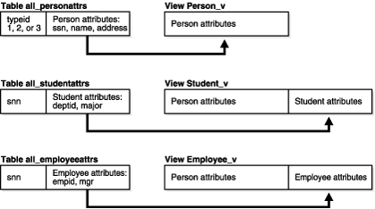

The Flat Model
In the flat model, all the views in the hierarchy are based on the same table. In the following example, the single table AllPersons contains columns for all the attributes of person_typ, student_typ, and employee_typ.
Figure 6-2 Flat Storage Model for Object View Hierarchy
Description of Figure 6-2 follows
Description of "Figure 6-2 Flat Storage Model for Object View Hierarchy"
The typeid column identifies the type of each row. These possible values are the types created in Example 6-16, 1 = person_typ, 2 = student_typ, and 3 = employee_typ:
Example 6-17 creates the table AllPersons and then the views that make up the object view hierarchy:

The Vertical Model
In the vertical model, there is a physical table corresponding to each view in the hierarchy, but the physical tables store only those attributes that are unique to their corresponding subtypes.
Figure 6-4 Vertical Storage Model for Object View Hierarchy
Description of Figure 6-4 follows
Description of "Figure 6-4 Vertical Storage Model for Object View Hierarchy"
Example 6-20 creates tables and then corresponding views.
Example 6-20 Creating table, views vertical model
CREATE TABLE all_personattrs
( typeid NUMBER,
  ssn NUMBER,
  name VARCHAR2(30),
  address VARCHAR2(100));
CREATE TABLE all_studentattrs
( ssn NUMBER,
  deptid NUMBER,
  major VARCHAR2(30));
CREATE TABLE all_employeeattrs
( ssn NUMBER,
  empid NUMBER,
  mgr VARCHAR2(30));
CREATE OR REPLACE VIEW Person_v OF person_typ
WITH OBJECT OID(ssn) AS
  SELECT ssn, name, address
  FROM all_personattrs
  WHERE typeid = 1;
CREATE OR REPLACE VIEW Student_v OF student_typ UNDER Person_v
  AS
  SELECT x.ssn, x.name, x.address, y.deptid, y.major
  FROM all_personattrs x, all_studentattrs y
  WHERE x.typeid = 2 AND x.ssn = y.ssn;
CREATE OR REPLACE VIEW Employee_v OF employee_typ UNDER Person_v
  AS
  SELECT x.ssn, x.name, x.address, y.empid, y.mgr
  FROM all_personattrs x, all_employeeattrs y
  WHERE x.typeid = 3 AND x.ssn = y.ssn;
The vertical model can efficiently process queries of the kind SELECT * FROM root_view, and it is possible to index individual attributes and impose unique constraints on them. However, to re-create an instance of a type, a join over object identifiers (OIDs) must be performed for each level that the type is removed from the root in the hierarchy.
