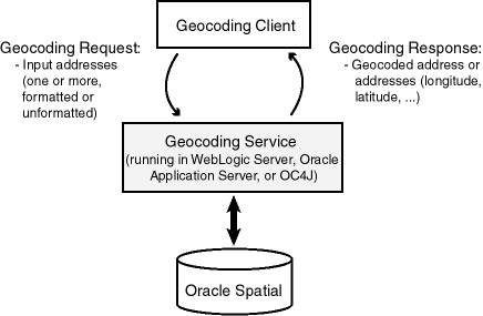

11.7 Using the Geocoding Service (XML API)
In addition to the SQL API, Oracle Spatial also provides an XML API for a geocoding service that enables you to geocode addresses. A Java geocoder application engine performs international address standardization, geocoding, and POI matching, by querying geocoder data stored in the Oracle database. The support for unparsed addresses adds flexibility and convenience to customer applications.
This geocoding service is implemented as a Java 2 Enterprise Edition (J2EE) Web application that you can deploy in a WebLogic Server, Oracle Application Server, or standalone Oracle Application Server Containers for J2EE (OC4J) environment.
Figure 11-1 shows the basic flow of action with the geocoding service: a client locates a remote geocoding service instance, sends a geocoding request, and processes the response returned by the geocoding service instance.
Figure 11-1 Basic Flow of Action with the Spatial Geocoding Service
Description of Figure 11-1 follows
Description of "Figure 11-1 Basic Flow of Action with the Spatial Geocoding Service"
As shown in Figure 11-1:
  1. The client sends an XML geocoding request, containing one or more input addresses to be geocoded, to the geocoding service using the HTTP protocol.
  2. The geocoding service parses the input request and looks up the input address in the database.
  3. The geocoding service sends the geocoded result in XML format to the client using the HTTP protocol.
