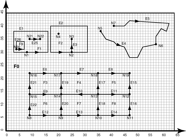

Topology is a branch of mathematics concerned with objects in space. Topological relationships include such relationships as contains, inside, covers, covered by, touch, and overlap with boundaries intersecting. Topological relationships remain constant when the coordinate space is deformed, such as by twisting or stretching. (Examples of relationships that are not topological include length of, distance between, and area of.)
The basic elements in a topology are its nodes, edges, and faces.
A node, represented by a point, can be isolated or it can be used to bound edges. Two or more edges meet at a non-isolated node. A node has a coordinate pair associated with it that describes the spatial location for that node. Examples of geographic entities that might be represented as nodes include start and end points of streets, places of historical interest, and airports (if the map scale is sufficiently large).
An edge is bounded by two nodes: the start (origin) node and the end (terminal) node. An edge has an associated geometric object, usually a coordinate string that describes the spatial representation of the edge. An edge may have several vertices making up a line string. (Circular arcs are not supported for topologies.) Examples of geographic entities that might be represented as edges include segments of streets and rivers.
The order of the coordinates gives a direction to an edge, and direction is important in determining topological relationships. The positive direction agrees with the orientation of the underlying edge, and the negative direction reverses this orientation. Each orientation of an edge is referred to as a directed edge, and each directed edge is the mirror image of its other directed edge. The start node of the positive directed edge is the end node of the negative directed edge. An edge also lies between two faces and has references to both of them. Each directed edge contains a reference to the next edge in the contiguous perimeter of the face on its left side.A face, corresponding to a polygon, has a reference to one directed edge of its outer boundary. If any island nodes or island edges are present, the face also has a reference to one directed edge on the boundary of each island. Examples of geographic entities that might be represented as faces include parks, lakes, counties, and states.
Figure 1-1 shows a simplified topology containing nodes, edges, and faces. The arrowheads on each edge indicate the positive direction of the edge (or, more precisely, the orientation of the underlying line string or curve geometry for positive direction of the edge).
Figure 1-1 Simplified Topology
Description of Figure 1-1 follows
Description of "Figure 1-1 Simplified Topology"
Notes on Figure 1-1:
Figure 1-2 shows the same topology illustrated in Figure 1-1, but it adds a grid and unit numbers along the x-axis and y-axis. Figure 1-2 is useful for understanding the output of some of the examples in Chapter 3 and Chapter 4.
Figure 1-2 Simplified Topology, with Grid Lines and Unit Numbers
Description of Figure 1-2 follows
Description of "Figure 1-2 Simplified Topology, with Grid Lines and Unit Numbers"

Figure 1-6 shows nodes, edges, and faces that illustrate the relationships among the various ID columns in the edge information table. (In Figure 1-6, thick lines show the edges, and thin lines with arrowheads show the direction of each edge.)
Figure 1-6 Nodes, Edges, and Faces

Table 1-2 shows the ID column values in the edge information table for edges E4 and E8 in Figure 1-6. (For clarity, Table 1-2 shows ID column values with alphabetical characters, such as E4 and N1; however, the ID columns actually contain numeric values only, specifically the numeric ID value associated with each named object.)
Table 1-2 Edge Table ID Column Values
EDGE_ID START_NODE_ID END_NODE_ID NEXT_LEFT_EDGE_ID PREV_LEFT_EDGE_ID NEXT_RIGHT_EDGE_ID PREV_RIGHT_EDGE_ID LEFT_FACE_ID RIGHT_FACE_ID
E4
N1
N2
-E5
E3
E2
-E6
F1
F2
E8
N4
N3
-E8
-E8
E8
E8
F2
F2
In Figure 1-6 and Table 1-2:
  • The start node and end node for edge E4 are N1 and N2, respectively. The next left edge for edge E4 is E5, but its direction is the opposite of edge E4, and therefore the next left edge for E4 is stored as -E5 (negative E5).
  • The previous left edge for edge E4 is E3, and because it has the same direction as edge E4, the previous left edge for E4 is stored as E3.
  • The next right face is determined using the negative directed edge of E4. This can be viewed as reversing the edge direction and taking the next left edge and previous left edge. In this case, the next right edge is E2 and the previous right edge is -E6 (the direction of edge E6 is opposite the negative direction of edge E4). For edge E4, the left face is F1 and the right face is F2.
  • Edges E1 and E7 are neither leftmost nor rightmost edges with respect to edge E4, and therefore they do not appear in the edge table row associated with edge E4.

Both examples are based on the "city data" topology shown in Figure 1-1 in Section 1.2, and the features shown in Figure 1-3 in Section 1.3.1. However, the topologies created are not identical, because the topology built from Spatial geometries (Example 1-13) does not contain all the edges, nodes, and faces that are defined for the topology build from topology data (Example 1-12).
1.12.1 Topology Built from Topology Data
Example 1-12 uses a topology built from edge, node, and face data.
Example 1-12 Topology Built from Topology Data

-- 1. Create the topology. (Null SRID in this example.)
EXECUTE SDO_TOPO.CREATE_TOPOLOGY('CITY_DATA', 0.00005);
-- 2. Load topology data (node, edge, and face tables).
--  Use INSERT statements here instead of a bulk-load utility.
-- 2A. Insert data into <topology_name>_EDGE$ table.
-- E1
INSERT INTO city_data_edge$ (edge_id, start_node_id, end_node_id,
    next_left_edge_id, prev_left_edge_id, next_right_edge_id,
    prev_right_edge_id, left_face_id, right_face_id, geometry)
 VALUES(1, 1, 1, 1, 1, -1, -1, 1, -1,
  SDO_GEOMETRY(2002, NULL, NULL, SDO_ELEM_INFO_ARRAY(1, 2, 1),
    SDO_ORDINATE_ARRAY(8,30, 16,30, 16,38, 3,38, 3,30, 8,30)));
-- E2
 VALUES(2, 2, 2, 3, -3, -2, -2, 2, -1,
    SDO_ORDINATE_ARRAY(25,30, 31,30, 31,40, 17,40, 17,30, 25,30)));
-- E3
 VALUES(3, 2, 3, -3, 2, 2, 3, 2, 2,
    SDO_ORDINATE_ARRAY(25,30, 25,35)));
-- E4
 VALUES(4, 5, 6, -5, -4, 4, 5, -1, -1,
    SDO_ORDINATE_ARRAY(36,38, 38,35, 41,34, 42,33, 45,32, 47,28, 50,28, 52,32,
57,33)));
-- E5
 VALUES(5, 7, 6, -4, -5, 5, 4, -1, -1,
    SDO_ORDINATE_ARRAY(41,40, 45,40, 47,42, 62,41, 61,38, 59,39, 57,36,
57,33)));
-- E6
 VALUES(6, 16, 17, 7, 21, -21, 19, -1, 3,
    SDO_ORDINATE_ARRAY(9,22, 21,22)));
-- E7
 VALUES(7, 17, 18, 8, 6, -19, 17, -1, 4,
    SDO_ORDINATE_ARRAY(21,22, 35,22)));
-- E8
 VALUES(8, 18, 19, -15, 7, -17, 15, -1, 5,
    SDO_ORDINATE_ARRAY(35,22, 47,22)));
-- E9
 VALUES(9, 15, 14, 19, -21, -22, 20, 3, 6,
    SDO_ORDINATE_ARRAY(9,14, 21,14)));
-- E10
 VALUES(10, 13, 14, -20, 18, 17, -19, 7, 4,
    SDO_ORDINATE_ARRAY(35,14, 21,14)));
-- E11
 VALUES(11, 13, 12, 15, -17, -18, 16, 5, 8,
    SDO_ORDINATE_ARRAY(35,14, 47,14)));
-- E12
 VALUES(12, 8, 9, 20, -22, 22, -13, 6, -1,
    SDO_ORDINATE_ARRAY(9,6, 21,6)));
-- E13
 VALUES(13, 9, 10, 18, -20, -12, -14, 7, -1,
    SDO_ORDINATE_ARRAY(21,6, 35,6)));
-- E14
 VALUES(14, 10, 11, 16, -18, -13, -16, 8, -1,
    SDO_ORDINATE_ARRAY(35,6, 47,6)));
-- E15
 VALUES(15, 12, 19, -8, 11, -16, 8, 5, -1,
    SDO_ORDINATE_ARRAY(47,14, 47,22)));
-- E16
 VALUES(16, 11, 12, -11, 14, -14, -15, 8, -1,
    SDO_ORDINATE_ARRAY(47,6, 47,14)));
-- E17
 VALUES(17, 13, 18, -7, -10, 11, -8, 4, 5,
    SDO_ORDINATE_ARRAY(35,14, 35,22)));
-- E18
 VALUES(18, 10, 13, 10, 13, 14, -11, 7, 8,
    SDO_ORDINATE_ARRAY(35,6, 35,14)));
-- E19
 VALUES(19, 14, 17, -6, 9, -10, -7, 3, 4,
    SDO_ORDINATE_ARRAY(21,14, 21,22)));
-- E20
 VALUES(20, 9, 14, -9, 12, 13, 10, 6, 7,
    SDO_ORDINATE_ARRAY(21,6, 21,14)));
-- E21
 VALUES(21, 15, 16, 6, 22, 9, -6, -1, 3,
    SDO_ORDINATE_ARRAY(9,14, 9,22)));
-- E22
 VALUES(22, 8, 15, 21, -12, 12, -9, -1, 6,
    SDO_ORDINATE_ARRAY(9,6, 9,14)));
-- E25
 VALUES(25, 21, 22, -25, -25, 25, 25, 1, 1,
    SDO_ORDINATE_ARRAY(9,35, 13,35)));
-- E26
 VALUES(26, 20, 20, 26, 26, -26, -26, 9, 1,
    SDO_ORDINATE_ARRAY(4,31, 7,31, 7,34, 4,34, 4,31)));
-- 2B. Insert data into <topology_name>_NODE$ table.
-- N1
INSERT INTO city_data_node$ (node_id, edge_id, face_id, geometry)
 VALUES(1, 1, NULL,
  SDO_GEOMETRY(2001, NULL, SDO_POINT_TYPE(8,30,NULL), NULL, NULL));
-- N2
 VALUES(2, 2, NULL,
  SDO_GEOMETRY(2001, NULL, SDO_POINT_TYPE(25,30,NULL), NULL, NULL));
-- N3
 VALUES(3, -3, NULL,
  SDO_GEOMETRY(2001, NULL, SDO_POINT_TYPE(25,35,NULL), NULL, NULL));
-- N4
 VALUES(4, NULL, 2,
  SDO_GEOMETRY(2001, NULL, SDO_POINT_TYPE(20,37,NULL), NULL, NULL));
-- N5
 VALUES(5, 4, NULL,
  SDO_GEOMETRY(2001, NULL, SDO_POINT_TYPE(36,38,NULL), NULL, NULL));
-- N6
 VALUES(6, -4, NULL,
  SDO_GEOMETRY(2001, NULL, SDO_POINT_TYPE(57,33,NULL), NULL, NULL));
-- N7
 VALUES(7, 5, NULL,
  SDO_GEOMETRY(2001, NULL, SDO_POINT_TYPE(41,40,NULL), NULL, NULL));
-- N8
 VALUES(8, 12, NULL,
  SDO_GEOMETRY(2001, NULL, SDO_POINT_TYPE(9,6,NULL), NULL, NULL));
-- N9
 VALUES(9, 20, NULL,
  SDO_GEOMETRY(2001, NULL, SDO_POINT_TYPE(21,6,NULL), NULL, NULL));
-- N10
 VALUES(10, 18, NULL,
  SDO_GEOMETRY(2001, NULL, SDO_POINT_TYPE(35,6,NULL), NULL, NULL));
-- N11
 VALUES(11, -14, NULL,
  SDO_GEOMETRY(2001, NULL, SDO_POINT_TYPE(47,6,NULL), NULL, NULL));
-- N12
 VALUES(12, 15, NULL,
  SDO_GEOMETRY(2001, NULL, SDO_POINT_TYPE(47,14,NULL), NULL, NULL));
-- N13
 VALUES(13, 17, NULL,
  SDO_GEOMETRY(2001, NULL, SDO_POINT_TYPE(35,14,NULL), NULL, NULL));
-- N14
 VALUES(14, 19, NULL,
  SDO_GEOMETRY(2001, NULL, SDO_POINT_TYPE(21,14,NULL), NULL, NULL));
-- N15
 VALUES(15, 21, NULL,
  SDO_GEOMETRY(2001, NULL, SDO_POINT_TYPE(9,14,NULL), NULL, NULL));
-- N16
 VALUES(16, 6, NULL,
  SDO_GEOMETRY(2001, NULL, SDO_POINT_TYPE(9,22,NULL), NULL, NULL));
-- N17
 VALUES(17, 7, NULL,
  SDO_GEOMETRY(2001, NULL, SDO_POINT_TYPE(21,22,NULL), NULL, NULL));
-- N18
 VALUES(18, 8, NULL,
  SDO_GEOMETRY(2001, NULL, SDO_POINT_TYPE(35,22,NULL), NULL, NULL));
-- N19
 VALUES(19, -15, NULL,
  SDO_GEOMETRY(2001, NULL, SDO_POINT_TYPE(47,22,NULL), NULL, NULL));
-- N20
 VALUES(20, 26, NULL,
  SDO_GEOMETRY(2001, NULL, SDO_POINT_TYPE(4,31,NULL), NULL, NULL));
-- N21
 VALUES(21, 25, NULL,
  SDO_GEOMETRY(2001, NULL, SDO_POINT_TYPE(9,35,NULL), NULL, NULL));
-- N22
 VALUES(22, -25, NULL,
  SDO_GEOMETRY(2001, NULL, SDO_POINT_TYPE(13,35,NULL), NULL, NULL));
-- 2C. Insert data into <topology_name>_FACE$ table.
-- F0 (id = -1, not 0)
INSERT INTO city_data_face$ (face_id, boundary_edge_id,
    island_edge_id_list, island_node_id_list, mbr_geometry)
 VALUES(-1, NULL, SDO_LIST_TYPE(-1, -2, 4, 6),
   SDO_LIST_TYPE(), NULL);
-- F1
 VALUES(1, 1, SDO_LIST_TYPE(25, -26), SDO_LIST_TYPE(),
  SDO_GEOMETRY(2003, NULL, NULL, SDO_ELEM_INFO_ARRAY(1,1003,3),
    SDO_ORDINATE_ARRAY(3,30, 15,38)));
-- F2
 VALUES(2, 2, SDO_LIST_TYPE(), SDO_LIST_TYPE(4),
    SDO_ORDINATE_ARRAY(17,30, 31,40)));
-- F3
 VALUES(3, 19, SDO_LIST_TYPE(), SDO_LIST_TYPE(),
    SDO_ORDINATE_ARRAY(9,14, 21,22)));
-- F4
 VALUES(4, 17, SDO_LIST_TYPE(), SDO_LIST_TYPE(),
    SDO_ORDINATE_ARRAY(21,14, 35,22)));
-- F5
 VALUES(5, 15, SDO_LIST_TYPE(), SDO_LIST_TYPE(),
    SDO_ORDINATE_ARRAY(35,14, 47,22)));
-- F6
 VALUES(6, 20, SDO_LIST_TYPE(), SDO_LIST_TYPE(),
    SDO_ORDINATE_ARRAY(9,6, 21,14)));
-- F7
 VALUES(7, 10, SDO_LIST_TYPE(), SDO_LIST_TYPE(),
    SDO_ORDINATE_ARRAY(21,6, 35,14)));
-- F8
 VALUES(8, 16, SDO_LIST_TYPE(), SDO_LIST_TYPE(),
    SDO_ORDINATE_ARRAY(35,6, 47,14)));
-- F9
 VALUES(9,26,SDO_LIST_TYPE(), SDO_LIST_TYPE(),
    SDO_ORDINATE_ARRAY(4,31, 7,34)));
-- 3. Create feature tables.
CREATE TABLE land_parcels ( -- Land parcels (selected faces)
  feature_name VARCHAR2(30) PRIMARY KEY,
  feature SDO_TOPO_GEOMETRY);
CREATE TABLE city_streets ( -- City streets (selected edges)
CREATE TABLE traffic_signs ( -- Traffic signs (selected nodes)
-- 4. Associate feature tables with the topology.
--    Add the three topology geometry layers to the CITY_DATA topology.
--    Any order is OK.
EXECUTE SDO_TOPO.ADD_TOPO_GEOMETRY_LAYER('CITY_DATA', 'LAND_PARCELS','FEATURE', 'POLYGON');
EXECUTE SDO_TOPO.ADD_TOPO_GEOMETRY_LAYER('CITY_DATA', 'TRAFFIC_SIGNS','FEATURE', 'POINT');
EXECUTE SDO_TOPO.ADD_TOPO_GEOMETRY_LAYER('CITY_DATA', 'CITY_STREETS', 'FEATURE','LINE');
--  As a result, Spatial generates a unique TG_LAYER_ID for each layer in
--  the topology metadata (USER/ALL_SDO_TOPO_METADATA).
-- 5. Initialize topology metadata.
EXECUTE SDO_TOPO.INITIALIZE_METADATA('CITY_DATA');
-- 6. Load feature tables using the SDO_TOPO_GEOMETRY constructor.
-- Each topology feature can consist of one or more objects (face, edge, node)
-- of an appropriate type. For example, a land parcel can consist of one face,
-- or two or more faces, as specified in the SDO_TOPO_OBJECT_ARRAY.
-- There are typically fewer features than there are faces, nodes, and edges.
-- In this example, the only features are these:
-- Area features (land parcels): P1, P2, P3, P4, P5
-- Point features (traffic signs): S1, S2, S3, S4
-- Linear features (roads/streets): R1, R2, R3, R4
-- 6A. Load LAND_PARCELS table.
-- P1
INSERT INTO land_parcels VALUES ('P1', -- Feature name
  SDO_TOPO_GEOMETRY(
    'CITY_DATA', -- Topology name
    3, -- Topology geometry type (polygon/multipolygon)
    1, -- TG_LAYER_ID for this topology (from ALL_SDO_TOPO_METADATA)
    SDO_TOPO_OBJECT_ARRAY (
      SDO_TOPO_OBJECT (3, 3), -- face_id = 3
      SDO_TOPO_OBJECT (6, 3))) -- face_id = 6
-- P2
INSERT INTO land_parcels VALUES ('P2', -- Feature name
  SDO_TOPO_GEOMETRY(
      SDO_TOPO_OBJECT (4, 3), -- face_id = 4
      SDO_TOPO_OBJECT (7, 3))) -- face_id = 7
-- P3
INSERT INTO land_parcels VALUES ('P3', -- Feature name
  SDO_TOPO_GEOMETRY(
      SDO_TOPO_OBJECT (5, 3), -- face_id = 5
      SDO_TOPO_OBJECT (8, 3))) -- face_id = 8
-- P4
INSERT INTO land_parcels VALUES ('P4', -- Feature name
  SDO_TOPO_GEOMETRY(
      SDO_TOPO_OBJECT (2, 3))) -- face_id = 2
-- P5 (Includes F1, but not F9.)
INSERT INTO land_parcels VALUES ('P5', -- Feature name
  SDO_TOPO_GEOMETRY(
      SDO_TOPO_OBJECT (1, 3))) -- face_id = 1
-- 6B. Load TRAFFIC_SIGNS table.
-- S1
INSERT INTO traffic_signs VALUES ('S1', -- Feature name
  SDO_TOPO_GEOMETRY(
    1, -- Topology geometry type (point)
    2, -- TG_LAYER_ID for this topology (from ALL_SDO_TOPO_METADATA)
      SDO_TOPO_OBJECT (14, 1))) -- node_id = 14
-- S2
INSERT INTO traffic_signs VALUES ('S2', -- Feature name
  SDO_TOPO_GEOMETRY(
      SDO_TOPO_OBJECT (13, 1))) -- node_id = 13
-- S3
INSERT INTO traffic_signs VALUES ('S3', -- Feature name
  SDO_TOPO_GEOMETRY(
      SDO_TOPO_OBJECT (6, 1))) -- node_id = 6
-- S4
INSERT INTO traffic_signs VALUES ('S4', -- Feature name
  SDO_TOPO_GEOMETRY(
      SDO_TOPO_OBJECT (4, 1))) -- node_id = 4
-- 6C. Load CITY_STREETS table.
-- (Note: "R" in feature names is for "Road", because "S" is used for signs.)
-- R1
INSERT INTO city_streets VALUES ('R1', -- Feature name
  SDO_TOPO_GEOMETRY(
    2, -- Topology geometry type (line string)
    3, -- TG_LAYER_ID for this topology (from ALL_SDO_TOPO_METADATA)
      SDO_TOPO_OBJECT (9, 2),
      SDO_TOPO_OBJECT (-10, 2),
      SDO_TOPO_OBJECT (11, 2))) -- edge_ids = 9, -10, 11
-- R2
INSERT INTO city_streets VALUES ('R2', -- Feature name
  SDO_TOPO_GEOMETRY(
      SDO_TOPO_OBJECT (4, 2),
      SDO_TOPO_OBJECT (-5, 2))) -- edge_ids = 4, -5
-- R3
INSERT INTO city_streets VALUES ('R3', -- Feature name
  SDO_TOPO_GEOMETRY(
      SDO_TOPO_OBJECT (25, 2))) -- edge_id = 25
-- R4
INSERT INTO city_streets VALUES ('R4', -- Feature name
  SDO_TOPO_GEOMETRY(
      SDO_TOPO_OBJECT (3, 2))) -- edge_id = 3
-- 7. Query the data.
SELECT a.feature_name, a.feature.tg_id, a.feature.get_geometry()
FROM land_parcels a;

1.12.2 Topology Built from Spatial Geometries
Example 1-13 uses a topology built from Oracle Spatial geometry data.
Example 1-13 Topology Built from Spatial Geometries
-- Main steps for using the topology data model with a topology
-- built from Spatial geometry data
-- 2. Insert the universe face (F0). (id = -1, not 0)
-- 5. Create a TopoMap object and load the whole topology into
--     cache for updating.
-- 6. Load feature tables, inserting data from the spatial tables and
--     using SDO_TOPO_MAP.CREATE_FEATURE.
-- 7. Initialize topology metadata.
-- 8. Query the data.
-- 9. Optionally, edit the data using the PL/SQL or Java API.
-- Preliminary work for this example (things normally done to use

-- Create spatial tables of geometry features: names and geometries.
CREATE TABLE city_streets_geom ( -- City streets/roads
  geometry SDO_GEOMETRY);
CREATE TABLE traffic_signs_geom ( -- Traffic signs
CREATE TABLE land_parcels_geom ( -- Land parcels

-- Load these tables (names and geometries for city streets/roads,
-- traffic signs, and land parcels).
-- Insert data into city street line geometries.
-- R1
INSERT INTO city_streets_geom VALUES('R1',
    SDO_ORDINATE_ARRAY(9,14, 21,14, 35,14, 47,14)));
-- R2
INSERT INTO city_streets_geom VALUES('R2',
57,33, 57,36, 59,39, 61,38, 62,41, 47,42, 45,40, 41,40)));
-- R3
INSERT INTO city_streets_geom VALUES('R3',
-- R4
INSERT INTO city_streets_geom VALUES('R4',
-- Insert data into traffic sign point geometries.
-- S1
INSERT INTO traffic_signs_geom VALUES('S1',
-- S2
INSERT INTO traffic_signs_geom VALUES('S2',
-- S3
INSERT INTO traffic_signs_geom VALUES('S3',
-- S4
INSERT INTO traffic_signs_geom VALUES('S4',
-- Insert data into land parcel polygon geometries.
-- P1
INSERT INTO land_parcels_geom VALUES('P1',
  SDO_GEOMETRY(2003, NULL, NULL, SDO_ELEM_INFO_ARRAY(1, 1003, 1),
    SDO_ORDINATE_ARRAY(9,6, 21,6, 21,14, 21,22, 9,22, 9,14, 9,6)));
-- P2
INSERT INTO land_parcels_geom VALUES('P2',
  SDO_GEOMETRY(2003, NULL, NULL, SDO_ELEM_INFO_ARRAY(1,1003,1),
    SDO_ORDINATE_ARRAY(21,6, 35,6, 35,14, 35,22, 21,22, 21,14, 21,6)));
-- P3
INSERT INTO land_parcels_geom VALUES('P3',
    SDO_ORDINATE_ARRAY(35,6, 47,6, 47,14, 47,22, 35,22, 35,14, 35,6)));
-- P4
INSERT INTO land_parcels_geom VALUES('P4',
    SDO_ORDINATE_ARRAY(17,30, 31,30, 31,40, 17,40, 17,30)));
-- P5 (polygon with a hole; exterior ring and one interior ring)
INSERT INTO land_parcels_geom VALUES('P5',
  SDO_GEOMETRY(2003, NULL, NULL, SDO_ELEM_INFO_ARRAY(1,1003,1, 11,2003,1),
      SDO_ORDINATE_ARRAY(3,30, 16,30, 16,38, 3,38, 3,30, 4,31, 4,34, 7,34, 7,31, 4,31)));
INSERT INTO CITY_DATA_FACE$ values (
  -1, NULL, SDO_LIST_TYPE(), SDO_LIST_TYPE(), NULL);
COMMIT;
CREATE TABLE city_streets ( -- City streets/roads
--    Any order is OK.
-- 5. Create a TopoMap object and load the whole topology into cache for updating.
EXECUTE SDO_TOPO_MAP.CREATE_TOPO_MAP('CITY_DATA', 'CITY_DATA_TOPOMAP');
EXECUTE SDO_TOPO_MAP.LOAD_TOPO_MAP('CITY_DATA_TOPOMAP', 'true');
