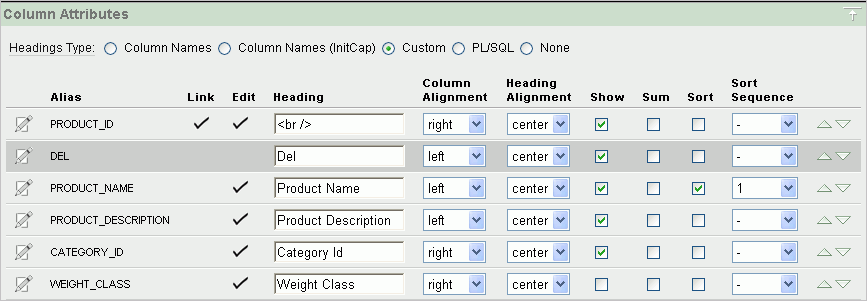

You can alter how a report displays by editing report attributes. In the exercise, you change the number of columns that display on page 1 and then change the format of two columns to include a currency symbol.
To edit report attributes for page 1:
  1. Click Application on the Developer toolbar.
    The Application home page appears.
  2. Click 1 - Product Report.
    The Page Definition for page 1 appears.
  3. Under Regions, click the Report link as shown in Figure 6-7.
    The Report Attributes page appears. You can use this page to precisely control the report layout. First, change the number of columns that display.
  4. Deselect the Show check box for the following columns:
    • Weight Class
    • Warranty Period
    • Supplier ID
    Next, edit List Price and Min Price columns to include a currency symbol.
  5. Edit the List Price column:
    1. Click the Edit icon next to List Price.
    2. From Number / Date Format, select $5,234.10.
    3. Click the Next (>) icon at the top of the page.
      Clicking the Next icon submits your changes and then displays attributes for the next column, Min Price.
  6. Edit the Min Price column:
    1. From Number / Date Format, select $5,234.10.
      Note that you select a format by selecting an example. However, the value that actually displays field is the Oracle number format.
    2. Click Apply Changes.
  7. Click the Run Page icon in the upper right corner.
    The revised report appears. Notice the Weight Class, Warranty Period, and Supplier ID no longer appear and the List Price and Min Price columns include a currency symbol.

  5. Scroll to the top of the page and select the Report Attributes tab.
  6. Under Column Attributes, locate the Del column.
  7. Click the Up arrow on the far right until the DEL column is directly below PRODUCT_ID. (See Figure 6-8).
    Figure 6-8 Report Column Attributes Page
    Description of Figure 6-8 follows
    Description of "Figure 6-8 Report Column Attributes Page"
  8. Click Apply Changes.
